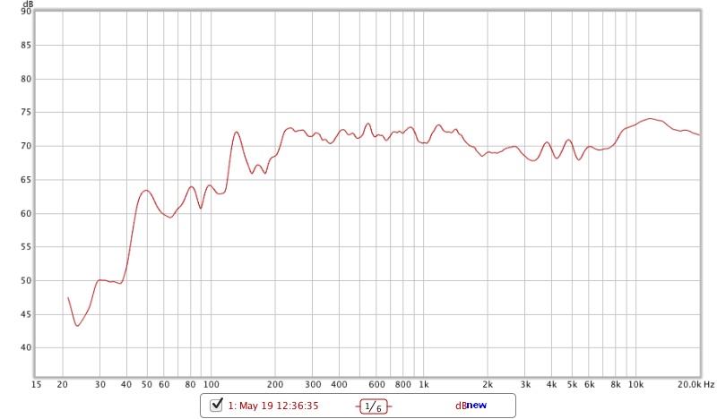

After some upgrades to measurement gear (and little idea how to get the most out of it), here's an update to the frequency response measurement on the speakers documented in my first post in this thread.
The measurement was taken about 36 inches in front of the right speaker with only that speaker driven. The measurement was still done indoors.
The set-up used REW software (version 5) running on a MacBook Pro using an M-Audio MobilePre for input and output. The output goes to a Topping TP32 amp and the microphone is a Dayton EMM-6.
The mic is calibrated but the SPL scale through the soundcard is not.

Here are a couple of pictures and a rough in-room frequency response chart (no particular absolute db scale on the chart).
They're not broken in yet, but they sound pretty good. 🙂

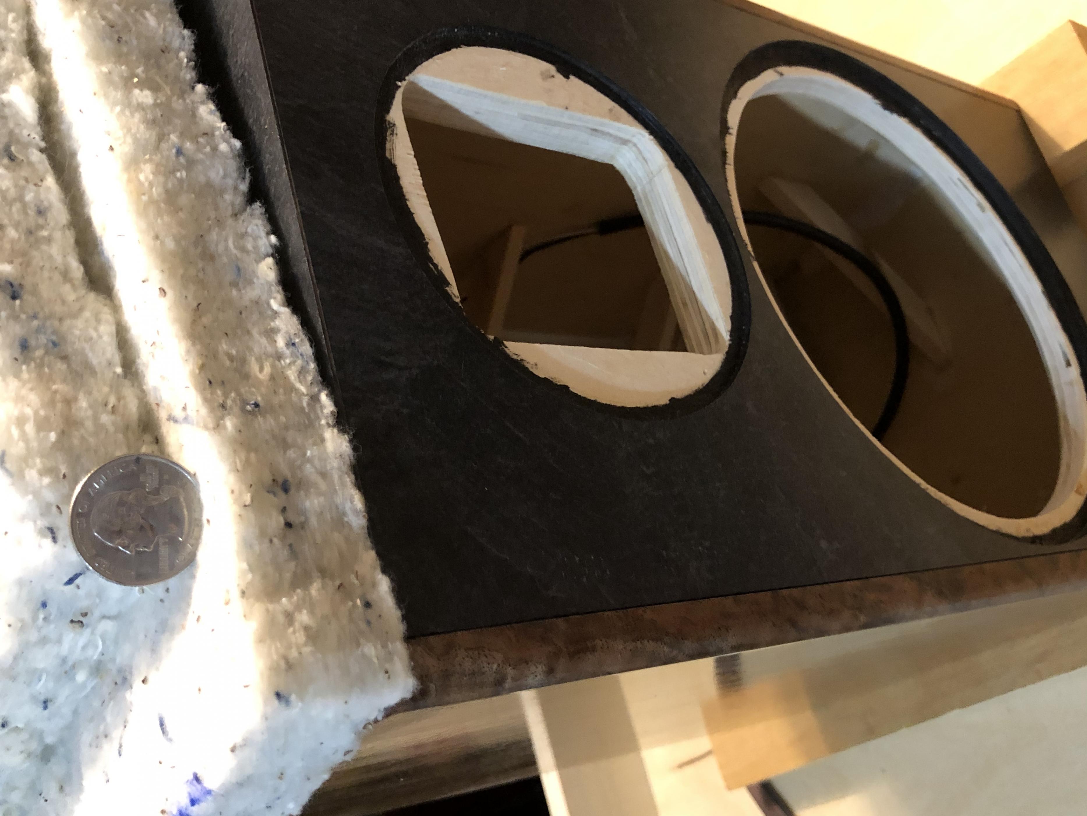

Dayvo, I followed your excellent lead on this build. For similar reason as you, I recently built a small, 1.5 watt tube amp and more efficient speakers became necessary. I first retrofitted a pair of TABAQ's with the Faital 4FE35 but discovered they still werent efficient enough. Enter, these Decware clones. I opted for the Clarity CSA cap in the tweeter circuit and lined the back wall and one side-wall with a total of 4 oz of cotton stuffing in each enclosure.
I am pleased with how the figured, curly walnut veneer and curly edgebanding over birchply came out.
These are definitely keepers. they sound balanced and the detail makes instrumental music sound wonderful. At the 94db efficiency, they are enough for near-field listening with this small amp but no more.
