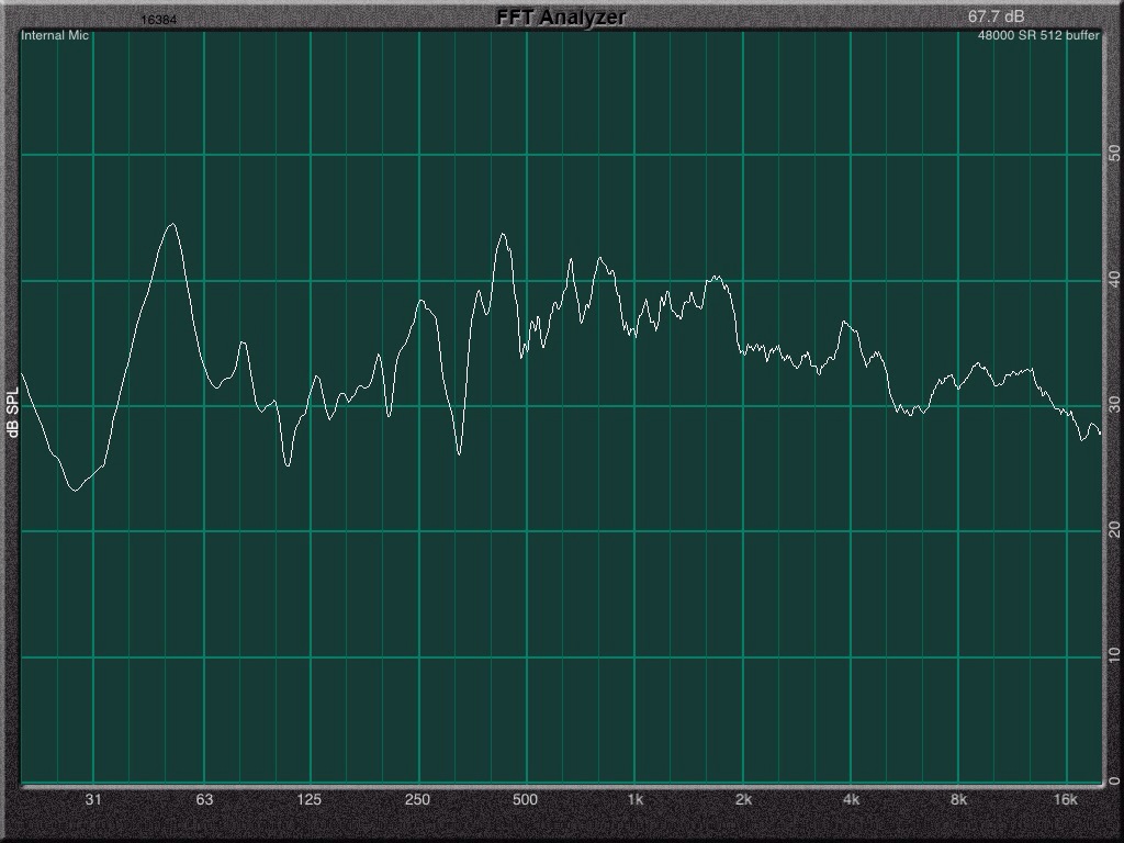

After some upgrades to measurement gear (and little idea how to get the most out of it), here's an update to the frequency response measurement on the speakers documented in my first post in this thread.
The measurement was taken about 36 inches in front of the right speaker with only that speaker driven. The measurement was still done indoors.
The set-up used REW software (version 5) running on a MacBook Pro using an M-Audio MobilePre for input and output. The output goes to a Topping TP32 amp and the microphone is a Dayton EMM-6.
The mic is calibrated but the SPL scale through the soundcard is not.

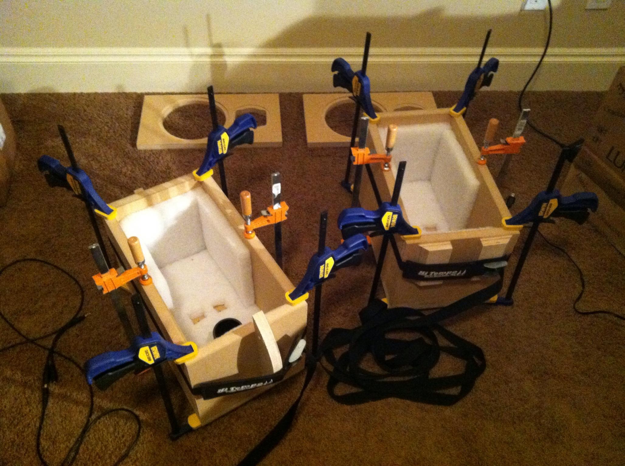

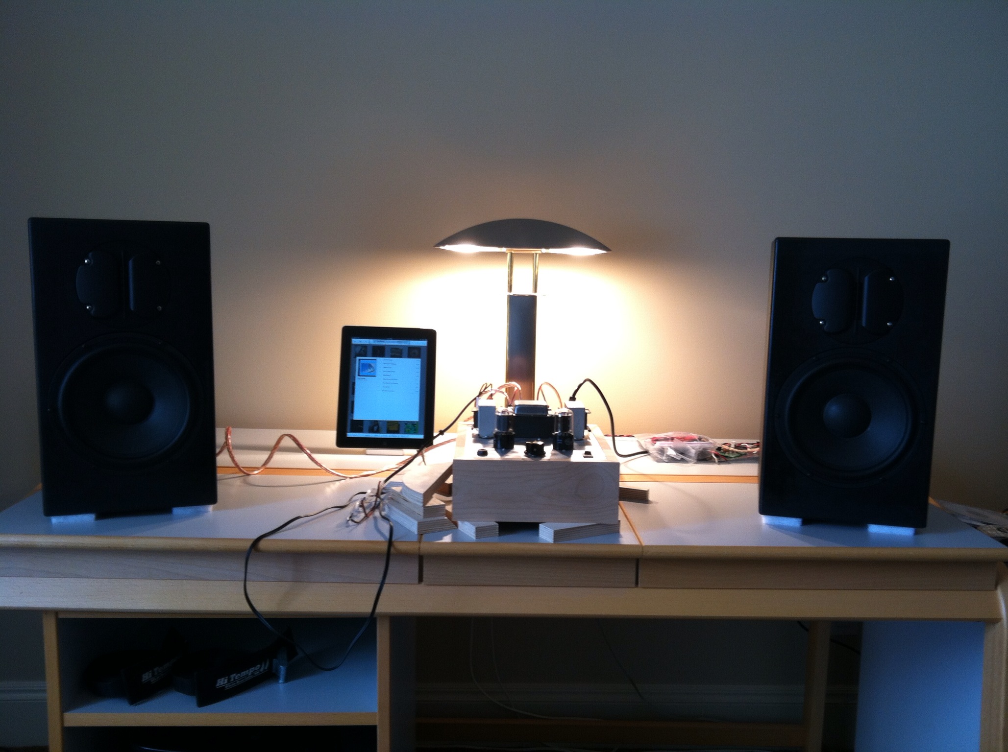

I built a SET tube amp (a Bottlehead SEX 2.1) about a month ago to use in a headphone rig. It sounds so nice that some high(er) efficiency speakers became a must. Looked around for a fitting design, saw the Decware DM945's, read a review, recognized the drivers, and figured I'd take a stab at an homage to them. Here's my disclaimer: I've never heard or even seen the 945's in the real world. Their cabinetry looks great on the website. If you want beautiful, professionally built stuff, I wouldn't hesitate to give Decware a shot. I just wanted to see (and hear) what I could do on my own.
Madisound was really fast at delivering the Silver Flute 8" 4 ohm woofers, the Hivi RT1C-A tweeters, the 3.9 micro F Clarity Caps (SA), and the binding posts. I grabbed some Home Depot 3/4" MDF and poly-fill NU-Foam from Jo-Ann Fabrics.
Here are a couple of pictures and a rough in-room frequency response chart (no particular absolute db scale on the chart).
They're not broken in yet, but they sound pretty good. 🙂
