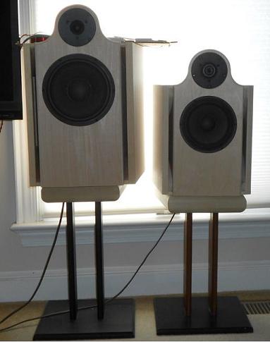

I ordered a pair of the 8" 8ohm.
Don't tell - you know who....
Will try some test boxes, various sizes.

Here's my first attempt at an impulse response based measurement. This is in-room and smoothed at 1/3 octave. It was taken about 4 feet in front of the center of one speaker - only that speaker operating. Looks like better data than my previous attempts. Makes me think the tweeter should be padded down a few dB.
Looking at the link I posted on the last page again, I noticed it says it only lets you trim down to 0.5 seconds. You need more like 0.005 s, so that ain't gonna work for removing reflections.
The DM944 pair I had back in 2008 used a 3.3uF PX Clarity Cap and the polarity on the tweeter was inverted. The port tube measured 2.05" ID x 3.58" L and the internal dimensions of the enclosure were: 8.50" D, 7.28" W, 14.50" H. Not sure of what changes were made for the DM945 model.
The DM945 has external dimensions of 9" x 10" x 16" so, assuming 3/4" material, internals are 7.5 x 8.5 x 14.5. That works out to 15 L (.53 cu.ft.), which coincides exactly with the Silver Flute recommendation on the Madisound site. I built using a 2.0" ID x 3.75" long port tube (actually 4" long with a 1/4" radius on the outside end).
I used a 3.9 micro F Clarity Cap (SA) to shoot for 3 dB down at about 8kHz. The 3.3 you mention seems like too high a crossover freq., but what do I know?
I also inverted the tweeter connection, but that was because of a comment on the Parts Express website saying that the Hi-Vi tweeter terminals are marked backwards. The logic given was they expect people to use 2nd order crossovers which have 180 degree phase shifts, so they compensated with the markings. Not sure I believe that, but subsequent response measurements confirm that the inverted connection is correct.

I haven't read this thread. But I just measured the Silver Flute 8" 8 ohm for a project I'm doing for a friend. It's not very useful above about 1khz. At 4khz there's quite a bit of break up too. Seems you'd wanna whack it into shape long before a ribbon could take over...
You can see just from the little measurement graph on the Madisound page that there's some type of resonant behavior around 800Hz affecting things around and above that, and then the full-on breakup starts kicking in around 3k. I think it's possible it doesn't sound too bad playing through the initial resonant issue.. I wonder if some open cell foam in the pole piece vent would do anything...
Ya, I get a blip in the impedance and FR around 700hz. Things are pretty shaky from there up. Crossing at 1khz would be ok though. I tried 1500hz with a different setup and eventually drove the XO back down to 1khz and things improved. This speaker will XO around 700hz.

The 8" SF vs. 6.5" sound the same to me.
8" is listed 93.7db, and 89db for 6.5"....no way!
I have one of each hooked up now, they sound the same (level etc).

Next project (to do list) is double size a cabinet for the 6.5"Sf.
I was a little surprised that the 8" SF cone is pretty thin, although it seems to work fine.
