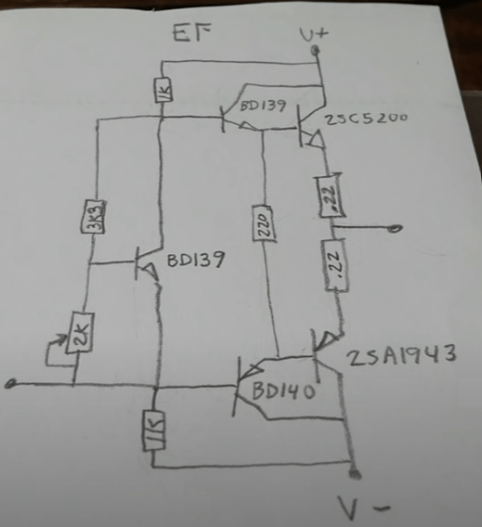

I see, thanks for this. I would be just careful of creating threads next time.Yes, your only problem at the moment is the lack of a heat sink.

These designs account for 90% of issues with DIYA projects. 20th century burning amps are often CFP's. I did not mean that the issue is taboo ,So just heatsink it is, thanks to you all.
Is the use of CFP a taboo or is creating a thread about it a taboo?

That makes things clearer, thank you. I think this goes with the last part of the post from #19. It's got this difficulty that comes with it. So unless I know what I am doing, I should compensate for it. Like the loading it with a zobel and or not getting the input floating because I've read that it is prone to oscillation.These designs account for 90% of issues with DIYA projects. 20th century burning amps are often CFP's.
As for the burning amp, there was indeed a point in which when I was testing it, things started to smoke 😵. Really, the only reason as to why I chose CFP is because of the lower voltage bias when using diodes, that's it. But now, why bother if you can do darlington and Vbe Multiplier.
I had to start with EF2 , I was scared of EF3 instability until I found the Harmon Kardon OPS (EF3).As for the burning amp, there was indeed a point in which when I was testing it, things started to smoke 😵. Really, the only reason as to why I chose CFP is because of the lower voltage bias when using diodes, that's it. But now, why bother if you can do darlington and Vbe Multiplier

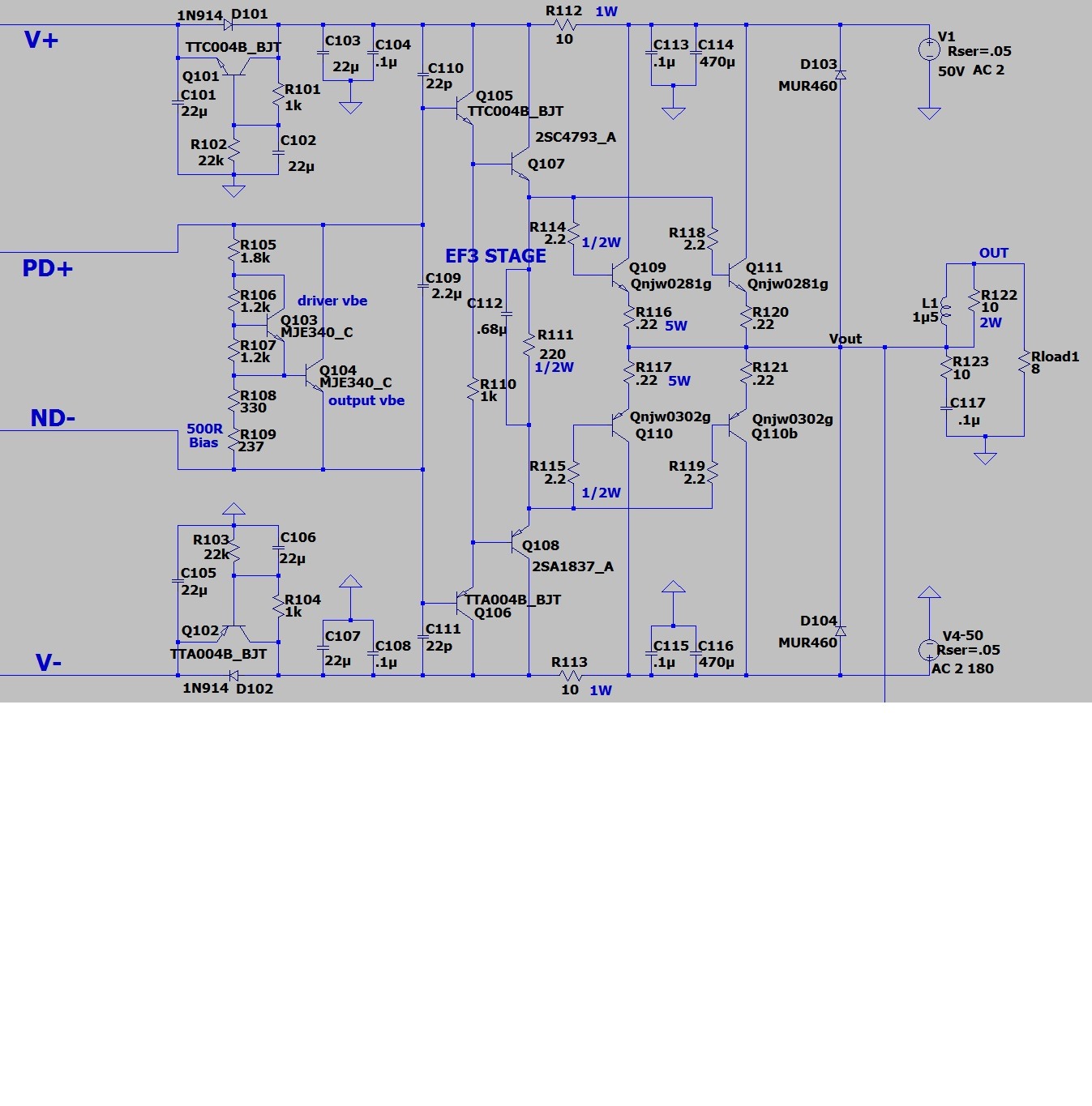

Current gain of 100K+ , 250V/uS (fast) . I looks a little more complicated , but will last many decades.
You can drive it with 3-4mA input stages .... run soooo cool. Since it does not load the input stage at all - super low distortion.
VERY high damping factor , it can take the craziest speaker loads with ease and drive 4R loads , as well.
You can also use outputs for the second stage , to drive 4-6 pairs of actual outputs. 500W wolverine OPS !!!
PS - If you layout (really)anally 🙂 - grounding/rail cancellation..... you can get part per million perfection.

It is when you try to optimize a CFP-based amplifier that you will find out how much of a pain in the *** it is. Build the same thing with an EF3 - you turn it on and it just works. And in the optimization process things behave more intuitively and according to models, even if they are basic and perhaps incomplete. There are only two cases where I’ll consider CFPs - one is if I just don’t want to give up that one volt of signal swing that you gain with it, and the other is if the two output transistors MUST be on separate heat sinks. And in neither case would I care about a little overshoot or excessive damping in the square wave, or if it actually gets unstable directly driving a 10 uF capacitor.

Regarding your complementary transistors push pull follower: The signal does pass half-wave different circuits: In addition to the half-wave different sound characteristics of the transistors, trimmer 2k, resistor 3k9 and Tr BD139 modulate the "upper" half-wave. That is audible: (more) "noise".
It might be more advantageous from a sonic point of view to feed back the power transistors by means of an emitter-base resistor instead to use a further pair of transistors.

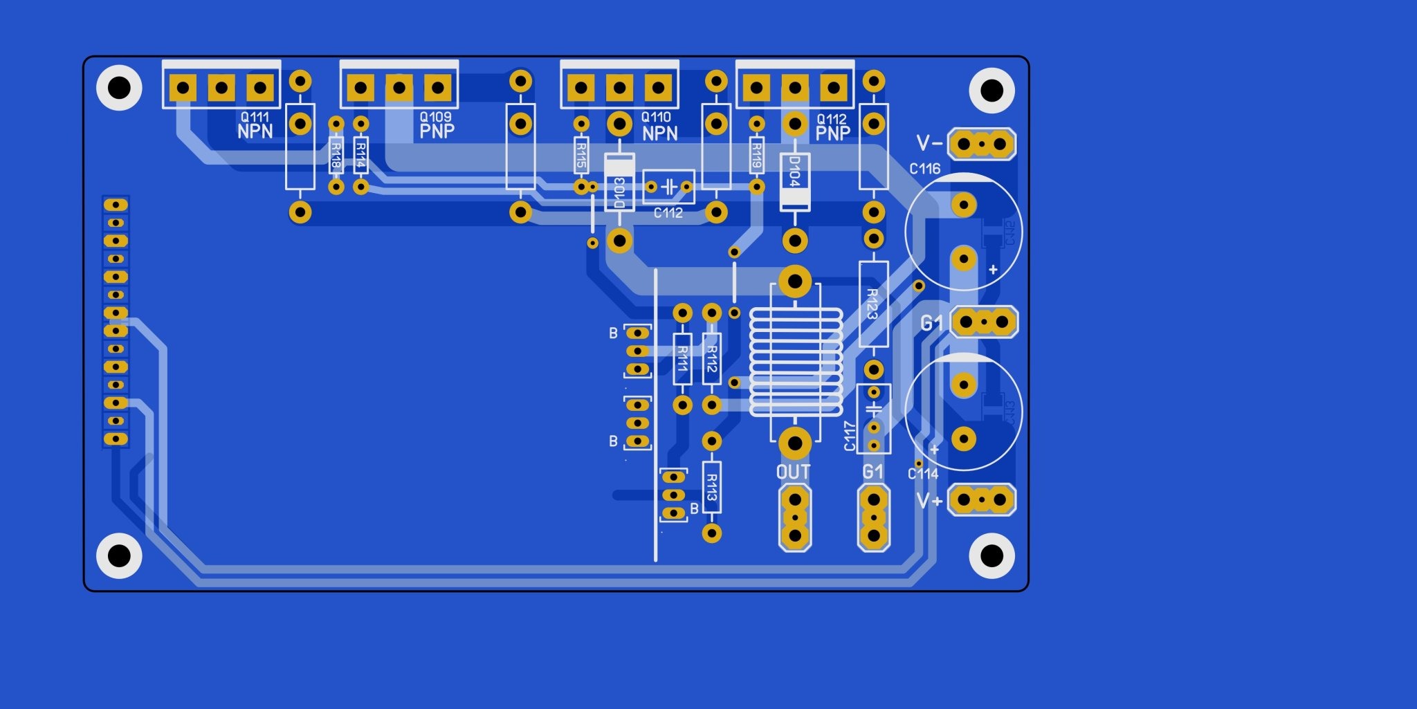

https://oshwlab.com/perseus/jat501-johnaudi-tech-discrete-amplifier
