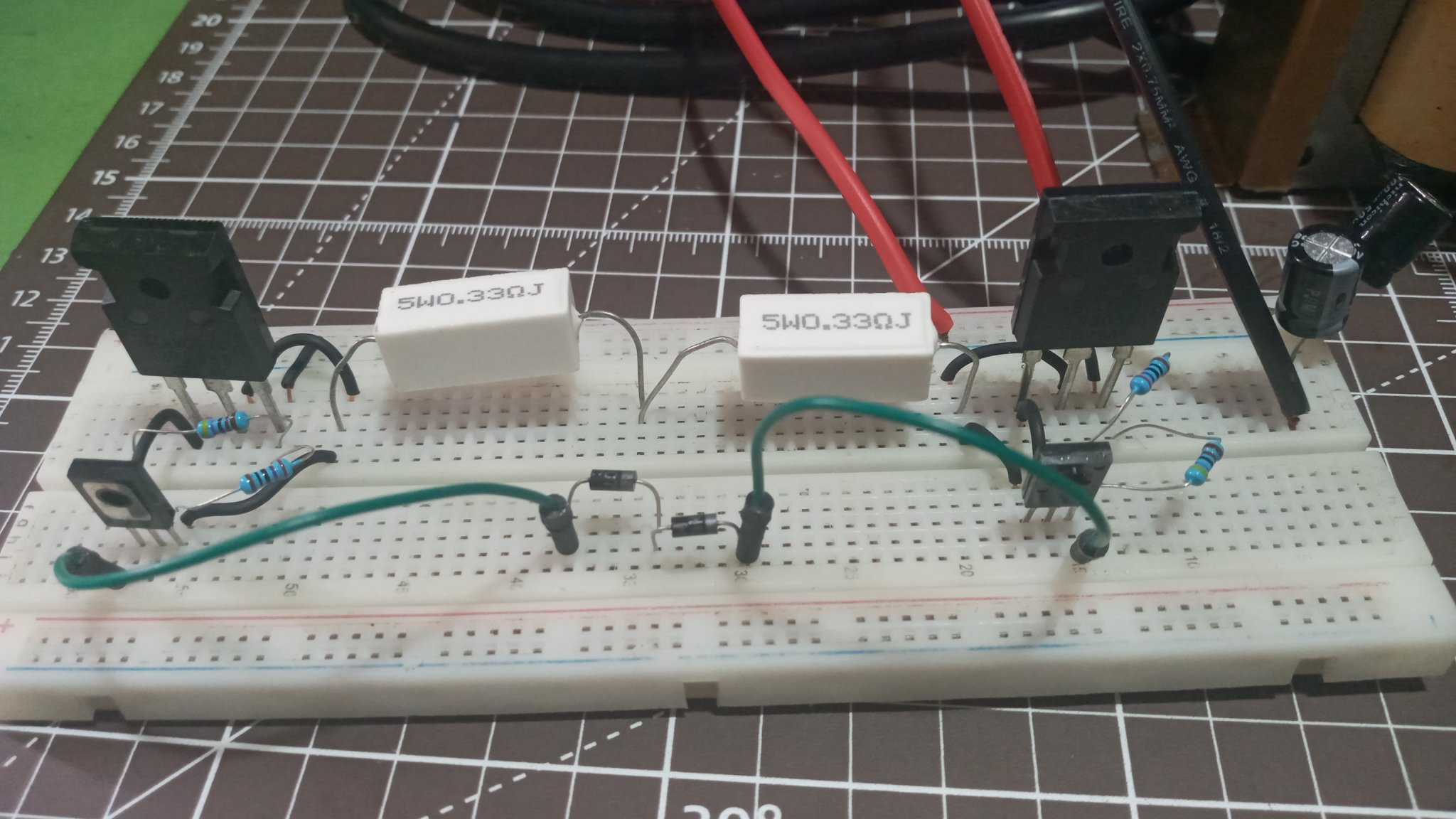

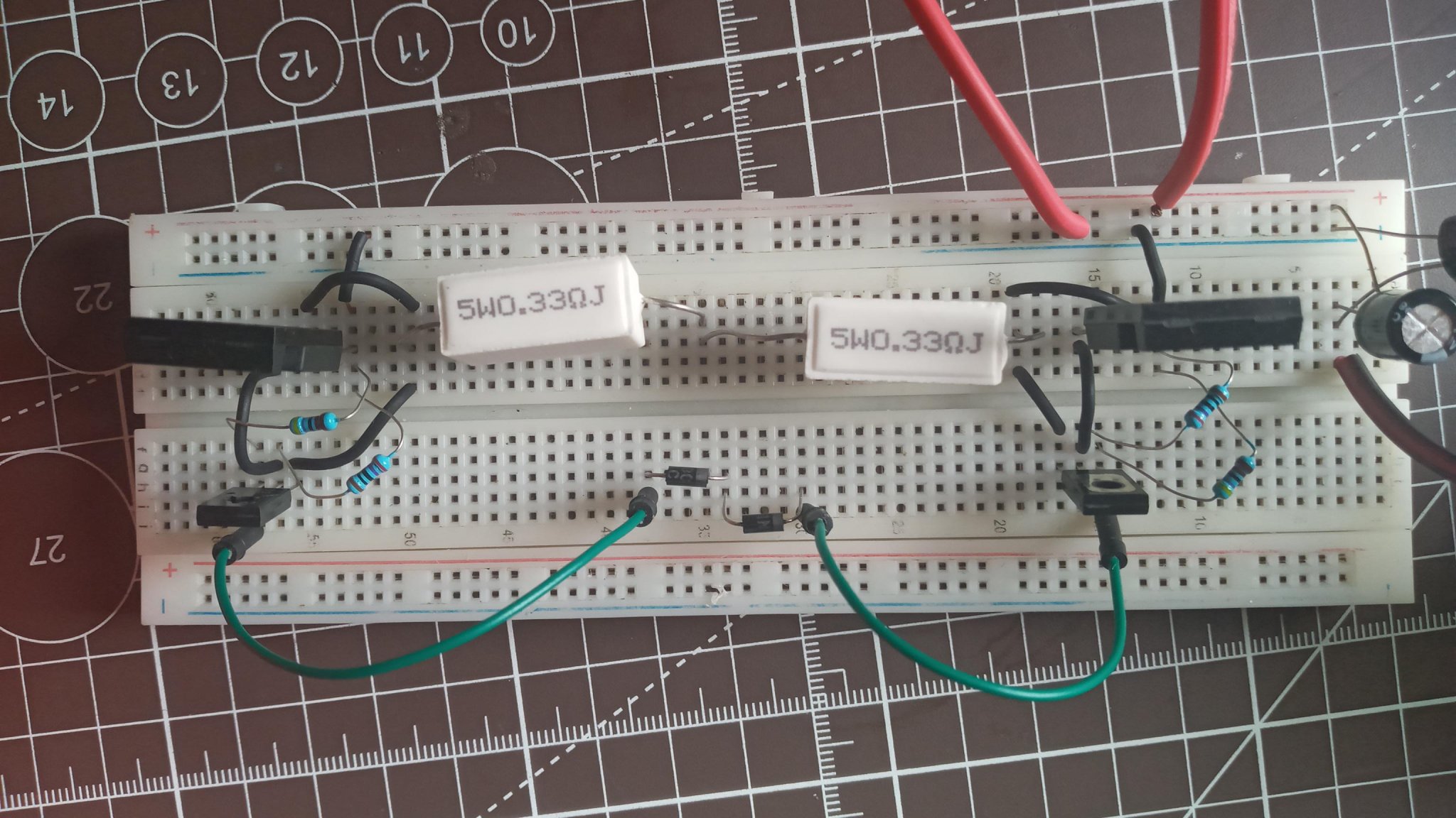

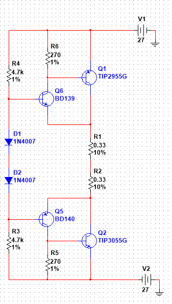

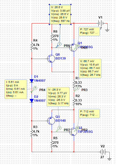

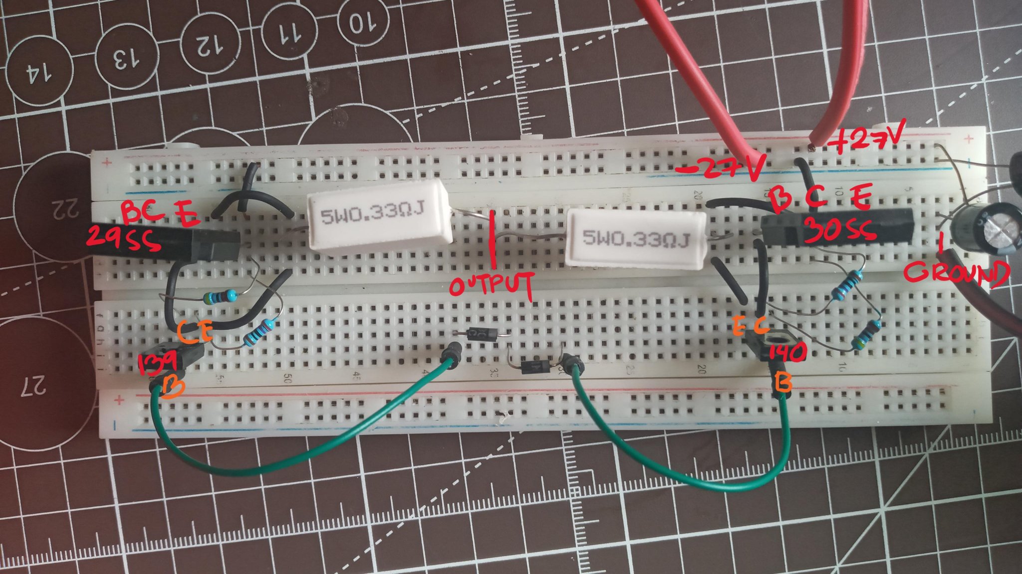

Simple Push Pull - CFP Output transistors heating up fast
Yes, your only problem at the moment is the lack of a heat sink.
But when amplifiers are built around them they often have problems that are not easy to solve, at least not without significant compromise. Resulting in a lot of off-the-reservation discussion, pseudo-science, and snake-oil sales. The kind of thing that gets moderators upset and threads closed. It’s already started here.
There is nothing inherently wrong with a CFP, and I’ll use them where appropriate - WHEN the compromises you end up making to ensure stability can be accepted. Not every amplifier needs 200+ watts, 10 ppm distortion, 100V/us slew rate, or needs to operate into a pure capacitor. If those are your goals, CFP will be more trouble than it needs to be.
I see, thanks for this. I would be just careful of creating threads next time.
These designs account for 90% of issues with DIYA projects. 20th century burning amps are often CFP's.
That makes things clearer, thank you. I think this goes with the last part of the post from #19. It's got this difficulty that comes with it. So unless I know what I am doing, I should compensate for it. Like the loading it with a zobel and or not getting the input floating because I've read that it is prone to oscillation.
As for the burning amp, there was indeed a point in which when I was testing it, things started to smoke 😵. Really, the only reason as to why I chose CFP is because of the lower voltage bias when using diodes, that's it. But now, why bother if you can do darlington and Vbe Multiplier.

My next project would probably just like the one in the pic, for now, I think the EF3 is a bit large as well as complex (for me) for what I am trying to do, plus it's intended to be for a somewhat low power audio amp anyway. Schematic/pic not mine, credit to John Audio Tech.

Regarding your complementary transistors push pull follower: The signal does pass half-wave different circuits: In addition to the half-wave different sound characteristics of the transistors, trimmer 2k, resistor 3k9 and Tr BD139 modulate the "upper" half-wave. That is audible: (more) "noise".
It might be more advantageous from a sonic point of view to feed back the power transistors by means of an emitter-base resistor instead to use a further pair of transistors.
