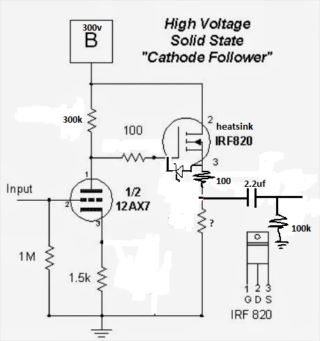

no, what is your recommendation?Your circuit shows about 1.5mA idling current - are you sure that's enough?
nice video about Gate Loop Ringing at 07:25
Approximately half of your B+ supply voltage will appear across the ? resistor, so it will also dissipate about the same power as the MOSFET. It's value is simple Ohms Law: R = Volts (about 150 for your case) divided by Current desired.
Only you can know what current is desired because you're keeping that a secret.

Perhaps get a couple of 15k, use one for 10mA which will likely be plenty and both resistor and FET will run a bit cooler - generally a good thing in my view.
Put a second 15k in parallel with the first for 20mA, which will generate more heat, see if it sounds any better to your ears

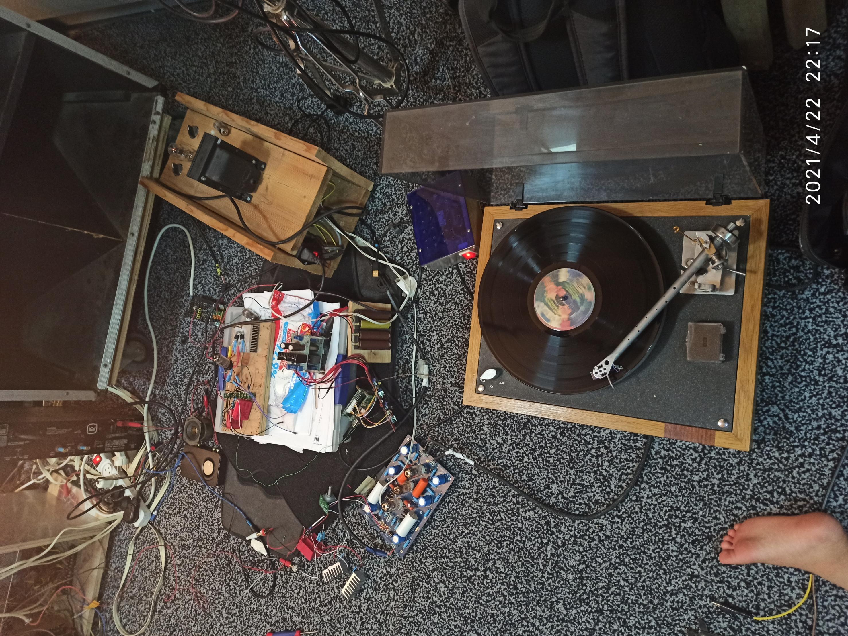

hi again.

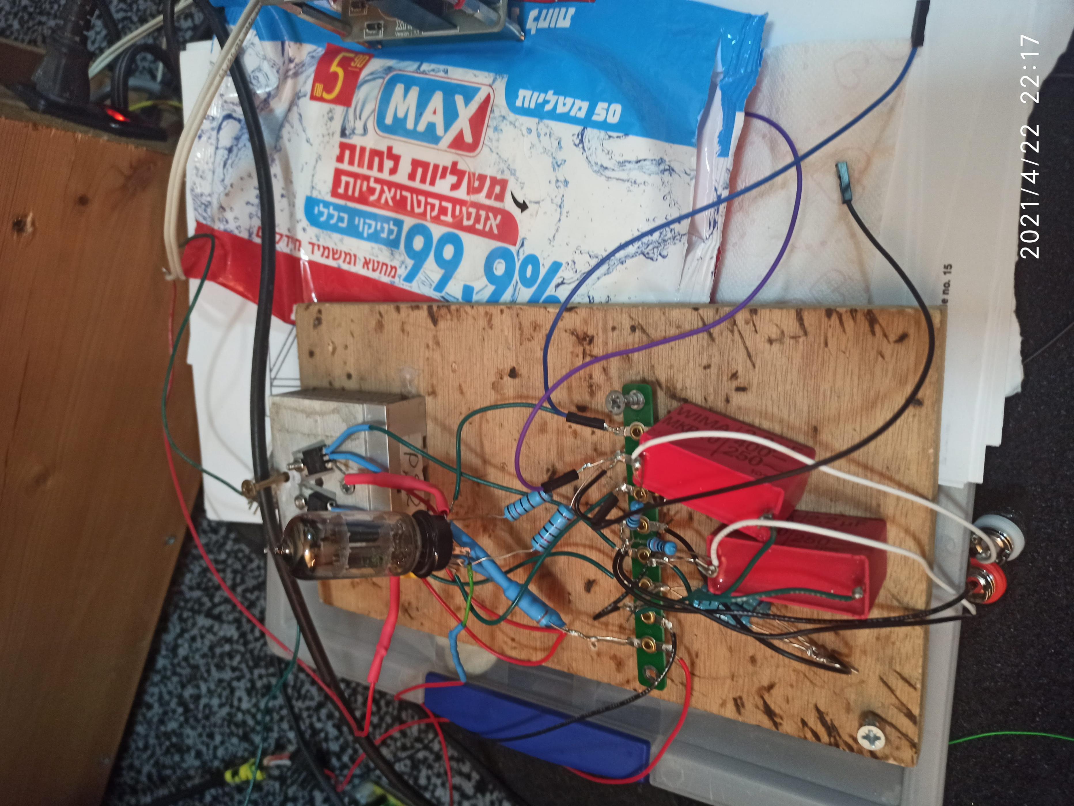

All the parts arrived, I started building the pre amplifier.
It works well, makes a bit of noise, probably power or GND.
12au7 works great for gain.

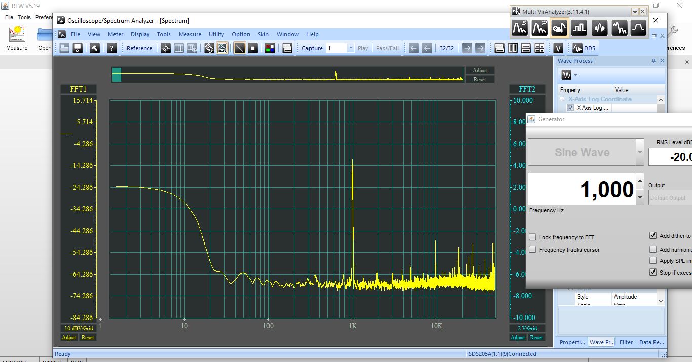

The spectrum picture is not so good. no 2nd harmonics
The 12ax7 has a lot of gain so any noise around will be amplified too.
Try extra decoupling on B+.

Which is it? 12AU7 or 12AX7? If it's 12AU7, those plate and cathode values are way off, and therein lies the problem most likely.
i try with 12ax7 and 12at7, but the volume is jump to high level about 9 o'clock. so i put 12au7.Which is it? 12AU7 or 12AX7?
what is you're recommendation?those plate and cathode values are way off,
OKTry extra decoupling on B+
If you have the parts, you can try 47k plate resistor and 220R - 330R on the cathode for a 12AU7. With a 300k plate load, the 12AU7 is so current starved it's virtually worthless 🙁
Otherwise, use 12AX7, and a voltage divider on the input to reduce the gain (or install negative feedback).
work good. thanksIf you have the parts, you can try 47k plate resistor and 220R - 330R on the cathode for a 12AU7. With a 300k plate load, the 12AU7 is so current starved it's virtually worthless
yes it helpTry extra decoupling on B+.
