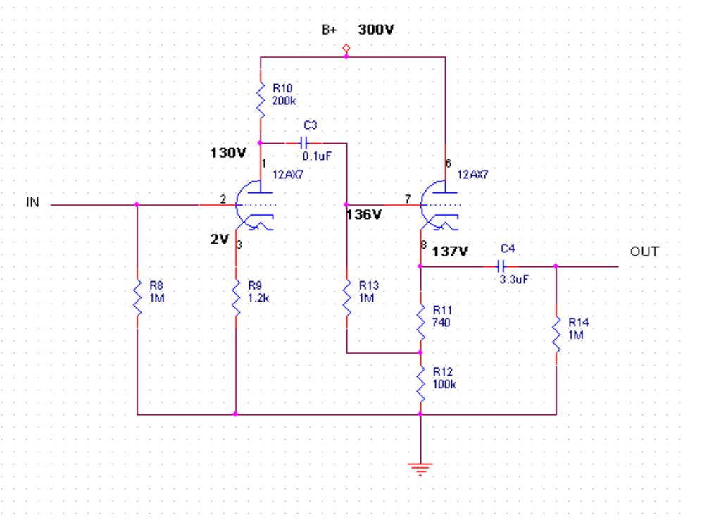

want to tray build simple preamp, no feedback, 2 channel from single 12ax7.
I want to connect a R2R DAC to it.
after the preamp i have single ended VFAT (only one transistor)
I'm worried about exit impedance of the pre :confused:
the DAC output is 1mA on 100 ohm resistor.
plug this to the preamp (in the picture).
I measured the signal at the output in the preamplifier, I do not remember so much, but something in the 5 volt range output.
don't know the impedance of the power amp, but when i build it, the recommendation was that need a preamp with very low impedance and high voltage output.
the reason that i remove the 12ax7 cathode follower it's because i measure high 2nd harmonics and 3nd harmonics in the output.
and without follower i measure only 2nd harmonics, that i like.
If you need the high gain and a low output impedance you have 2 options: add a cathode follower after the 12AX7. You better use a 12AT7 in stead of a 12AX7 for this stage.
The other option is to use a different tube with high gain and low Rp, e.g. a EC86 or D3A (triode switched)

No I don't have ready-to-go schematics but it is a very simple circuit. I've found: Hybrid Amplifier by Andrea Ciuffoli where you can get some ideas for the D3A.
Note that your demand of high gain (~50) is much higher than preamps typically deliver. In fact it is more like an input stage of an integrated amp. I am busy with a similar 'preamp' that should be able to drive a EL84 directly (~7V). I am thinking of using the D3A for it.
I believe your best option is to forget the cathode follower, this tube of yours has low gm, it will be unsuitable for low distortion in that position. Use a FET follower, it will be transparent and preserve the sound you like so far.

Is there a particular reason you want all the gain that a 12AX7 has to offer?
maybe i have miscalculation:
DAC output is +-1mA on 100 ohm resistor, so 0.1v+-
i measure with scope, the power amplifier at full volume is 2.5Vptp
so i need 25 gain
need a new post: Which tube is suitable for 20 gain and low exit resistance?
