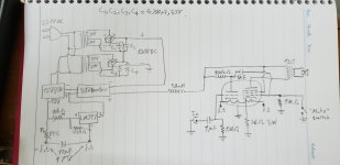

This class A amplifier I've built has this weird feedback-like thing when it doesn't have input audio or is not connect to a device. I have added a "mute" switch which shorts out the gate of the pentode to eliminate the ear piercing noise. How can I remove this feeback thingy?
Please show the schematic.
The schematic of my crude class A PCL805 amplifier.

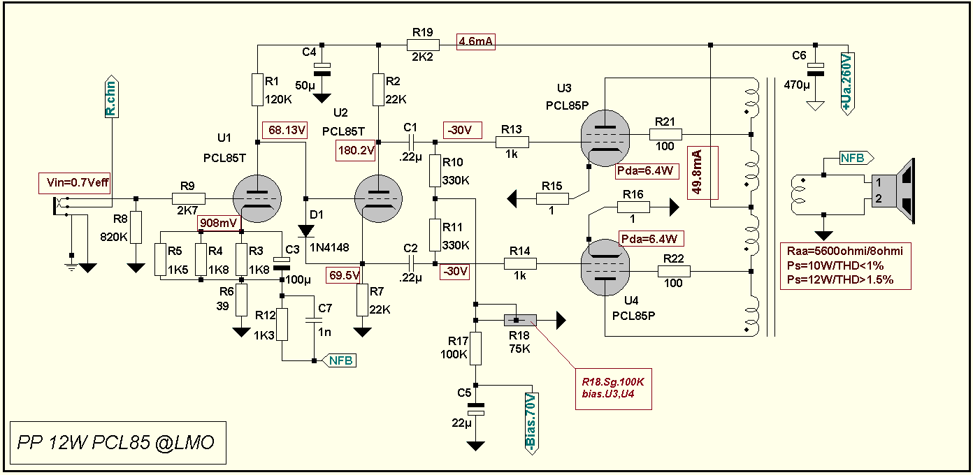

Hey guys
I'm looking for a simple-ish PCL805 push-pull amplifier which has been proven to work.
I have 2 PCL805s, a 170V power supply, and a transformer.
I have made a class A amplifier using one of those tubes and it sounds great with about 20W of power at a 3Ohms speaker ( 2 x 6Ohms ).
I would like it to have only 2 PCL805s and no solid state devices except diodes.
Thanks, guys!
I think you can not get 20W with PCL85, but 12W (max) can be obtained very lightly, and at 10W THD <1%. So the diagram is the one below, the voltage amplifier and the defazor (Cathodina) are inspired by the colleague @ Davorin, a very inspired scheme. Maybe this configuration will help you.

As the other fellow members showed me, my calculations were wrong.
Thank you for the schematic!

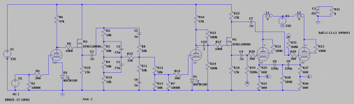

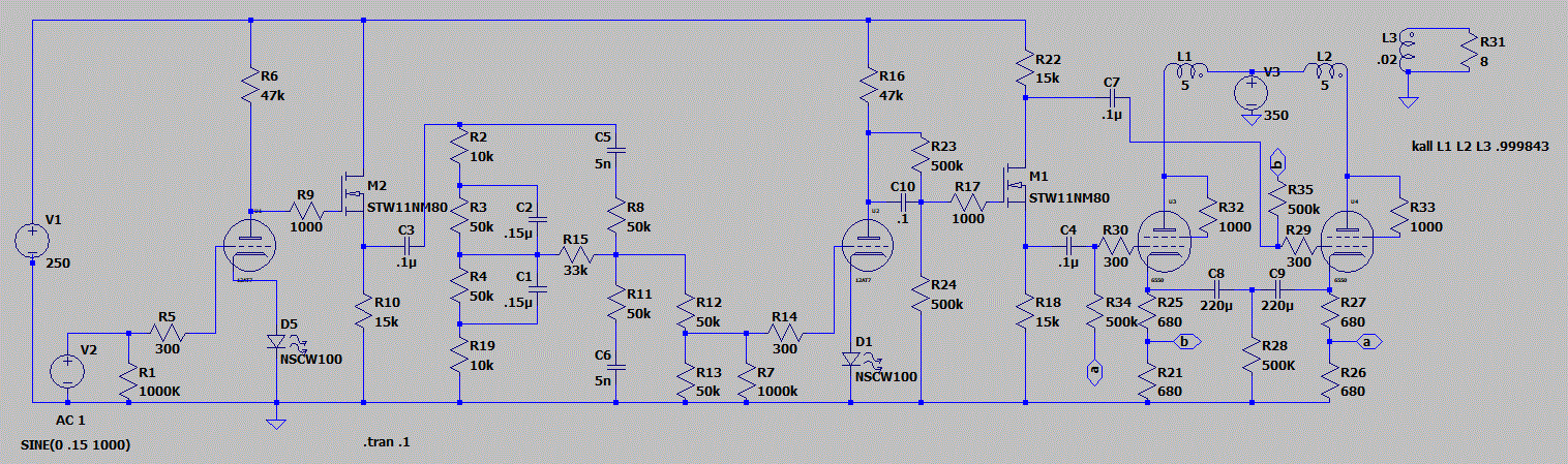

I've built several amps with the ECL/PCL805/6GV8/6F5P. Here's one:
https://www.diyaudio.com/forums/ins...undred-buck-amp-challenge-43.html#post5962424
Just ignore everything to the left of R7 and substitute the second triode for the MOSFET. It uses a garter bias and triode strapping on the output pentodes. The garter bias can be eliminated by getting rid of (shorting over) R21, R26, and R28. Also C10 is probably not necessary unless your source is very weak.
