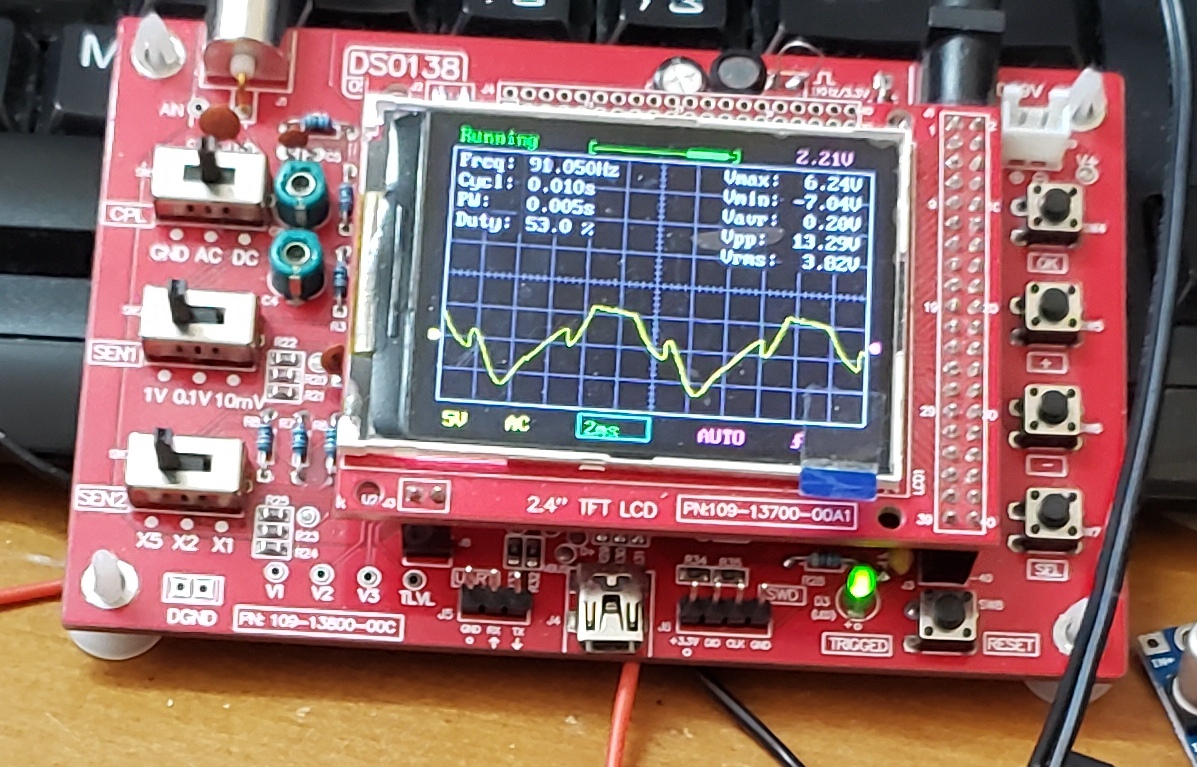

Well I was able to shove about 150mA at 170V into one PCL805 and get 20-25W with a 220V to 12V mains transformer without any red-plating. It sounded great BTW, someone which I had not expected.

This was done at 8.2Ohms at 91Hz. I think the RMS value calculated on my El Cheapo scope is wrong cause don't we multiply the P-P by 0.7071?
Anyway, this is why I think it's giving out about 20W or so.
With two 3Ohms speakers connected in parallel, it shakes the doors, windows, and the floor.

Direct link from this forum to google drive does not work (for a good reason). To see your images, the link should be copied from the post and pasted on the browser address bar - and only works for people that are logged on Google services. Use the attach function on the editor of this forum instead. I downloaded the most relevant picture on this post: from the scope screen, I believe that this amplifier output is 2,65 W RMS, and it seems to be clipping hard. The Artosalo 2W clean power prediction is therefore confirmed. Your high efficiency speaker is well matched to this low power amplifier. Old boombox speakers like that one were built to be loud with only a few watts of power, with a strong emphasis on some bass frequencies for the shaking effect. They are usually a bit lacking on the high frequencies but your vintage output transformer is likely uncapable to manage them anyway.

I will try to hook it up to the speakers and give a picture of the scope again. Again, I think the calculated RMS is wrong on the scope. If we take the 13V or so peak-to-peak and multiply it by 0.707, it should give us the right RMS.
These speakers are for a Sony CD-cassette stereo. It says on the main unit that each of the speakers are 125W RMS. They have a tweeter and their highs are decent.
I have had a Tripath amplifier, the stereo 15W version. It got fried so I can't compare them, but I in my opinion, this sounds much louder with the same speakers.
