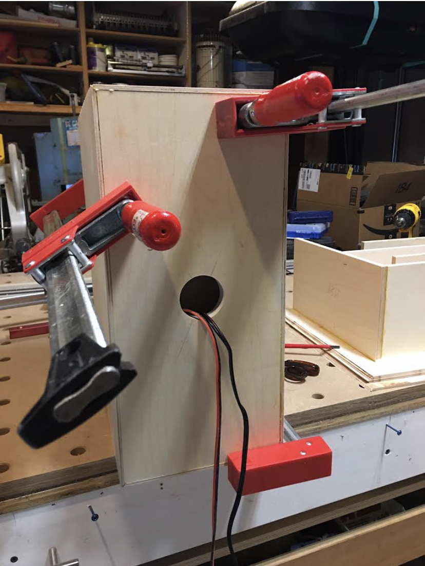

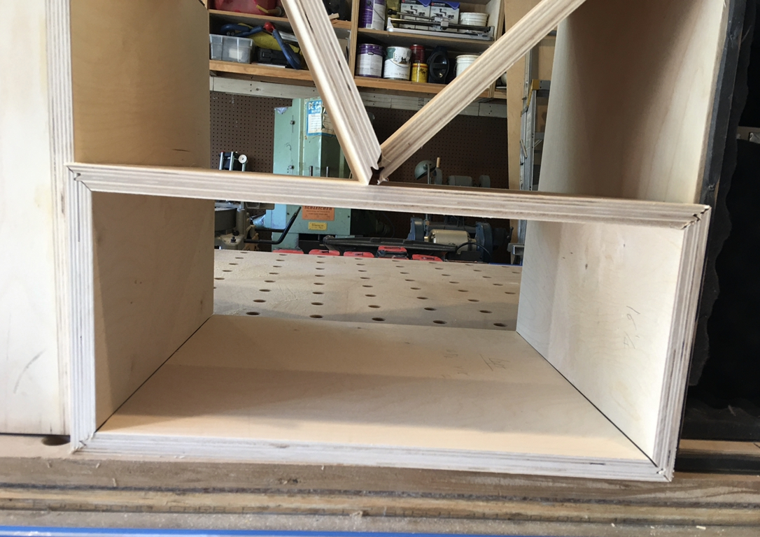

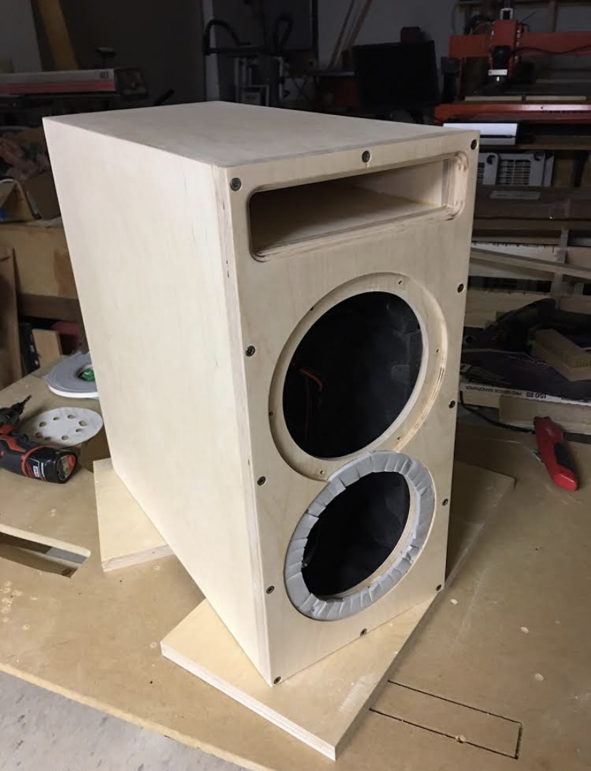

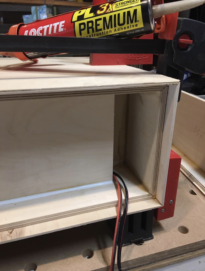

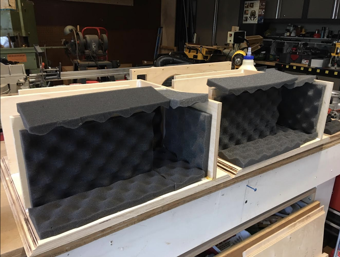

The new TL’s with mitered lock joints and PL Premium leak-free construction are now done. I just have to pick them up but I am still on vacation. Here are some photos of the build and final photo of the completed new TL. I am running 4 wires from the front to back in order to remeasure the raw responses of the drivers in-situ. The effect of the box vs open baffle on the response is significant.

You probably already know this, but it can take a while for PL Premium to fully cure and harden. Treat those tenderly!
I seem to recall they harden pretty well in humid conditions (activated by water vapor) and it is humid around here in VA during the summer. In any case it will be well over 10 days before I pick them up. I used PL premium to bond a 3d printed driver adapter to a horn wall. It hardened like hard plastic by the next day. I did spritz it with water mist.

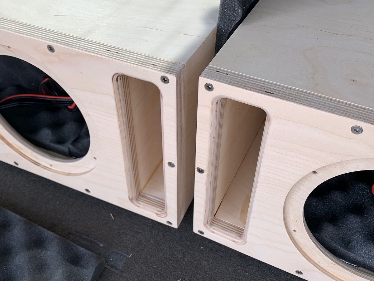

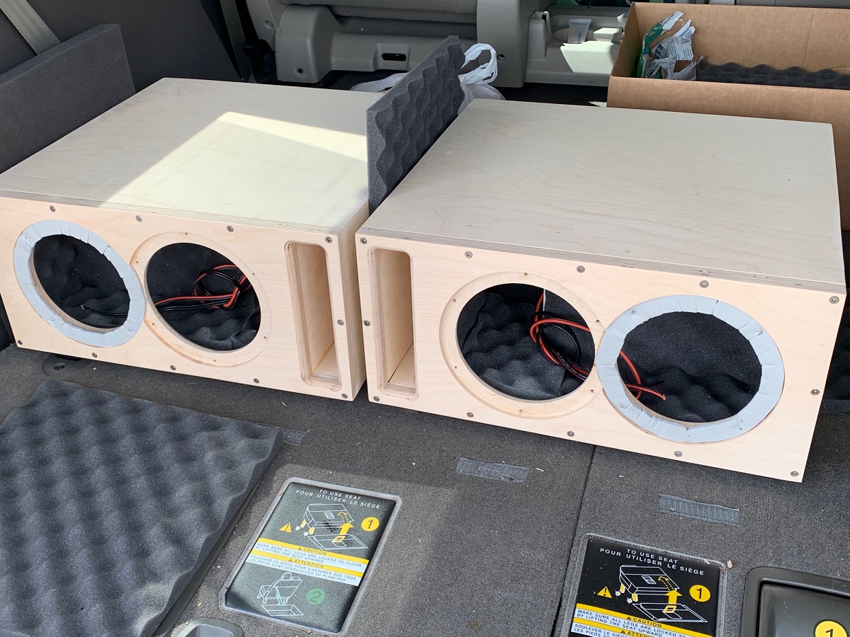

I just picked up the new TL's this morning. Looking forward to assembling them and hearing how they sound. I am going to let them sit for a few days before working on them for quarantine. Here they are still in the back of my car. I really like how the lock-mitered edges turned out. The back is also flush with no endgrain showing.
