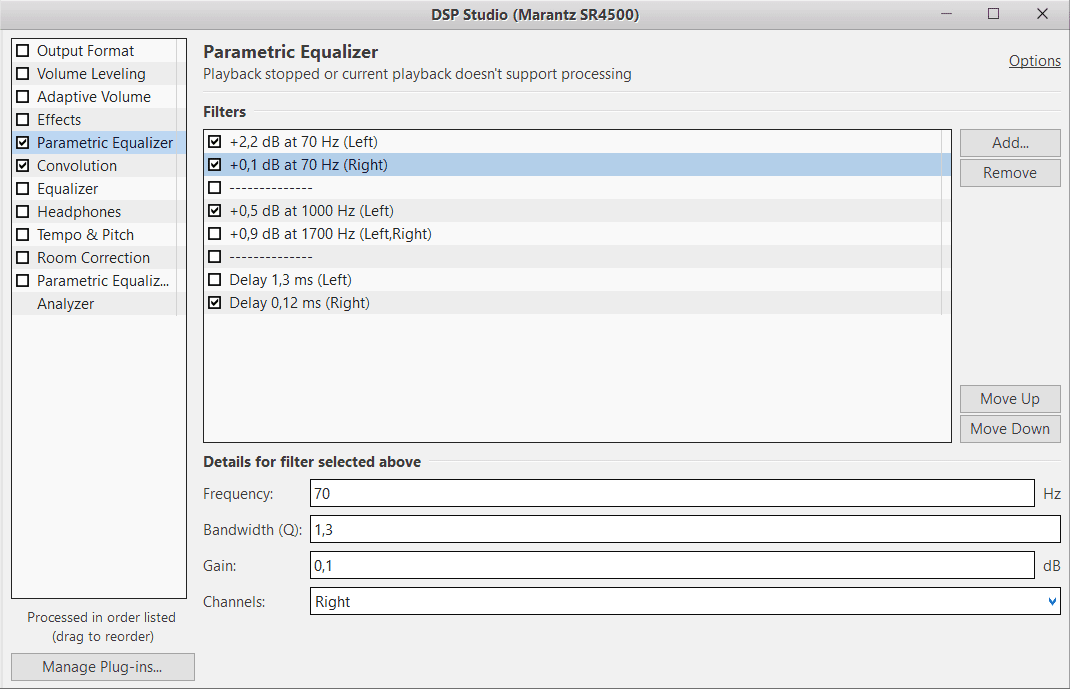

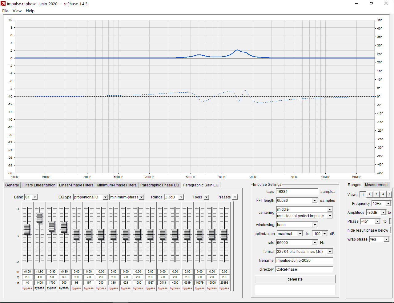

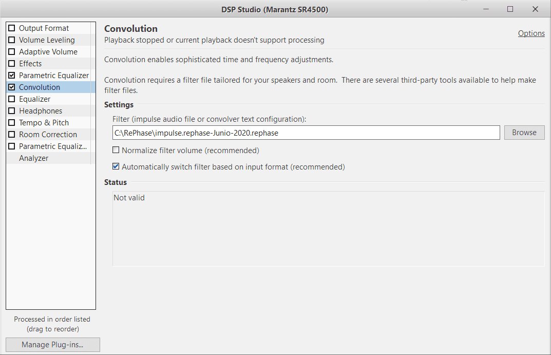

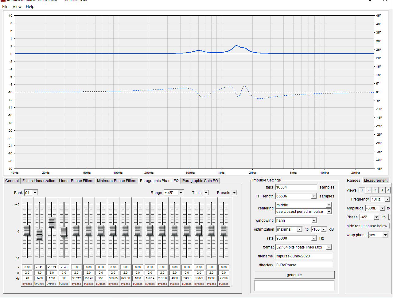

I use DSP but for the box or channel, without differentiating between tweeter and woofer. Listen in near field, without being exactly in the center. The right channel has a delay of 0.12 ms and is closer to a side wall (causing a bass boost).
That small delay is enough to improve the sound, I could not believe it!
One of the problems of close listening (in my cheap second system, the one they let me enjoy) is the lack of depth. I have managed to increase it but I would like a little more. Hence my interest in the predominance of the second H2 harmonic, but that is another story.

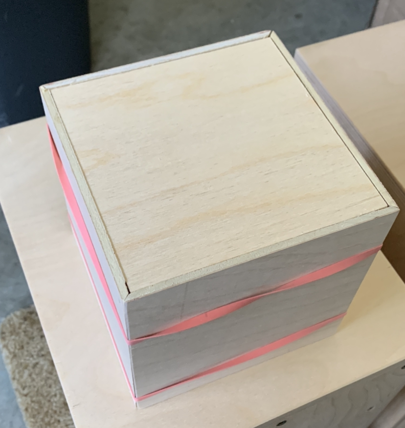

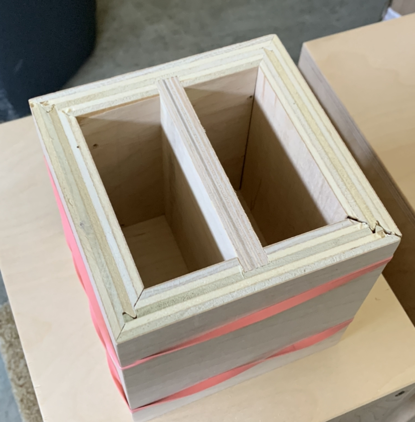

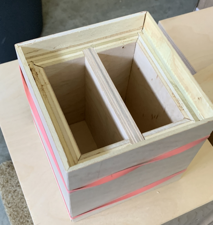

I was thinking that the bass gut punch from a TL that I normally would have expected was a bit lacking. I examined the internal structure closely and discovered a few leaks on the divider panels that were not perfectly sealed for air tightness and may have been contributing to a TL pinhole leak. This would compromise the bass extension and sensitivity of the bass. A quarter wave TL with a pinhole leak is sort of like playing low C on a flute with a leaky finger pad. My cabinet maker is new to building speakers so some audio-related points like air tightness were not fully understood by him. But he loves speaker building now and is willing to make it even better - he will remake me a new pair using lock mitered joints on the corners and dado joints on the internal panels. He wants it to be done right and look even better. He will also flush mount front baffle so no end grain is exposed. A much more complex, but sturdy and airtight build. This means that I won’t get the revised speakers back for some time. Maybe 2 weeks is my guess. But it will be a solid speaker. Here is a small example model that he brought to show me how the new joints will be some.

I hate the wait - but it’s going to be worth it I think.
Is he remaking everything from scratch or replacing some of the back-end pieces? It should be fairly easy to just "caulk" the offending areas with a hefty bead of PL Premium as a fix.
There is no way to access the internal joints of the labyrinth passages. He will try to repair/rework the current one later but offered to make a new one from scratch to do it right. I explained that a dado joint is not necessary for airtightness - just more glue or the right type of glue like PL Premium. So we can skip the dado joints to save time but still going with mitered lock joints on external corners.

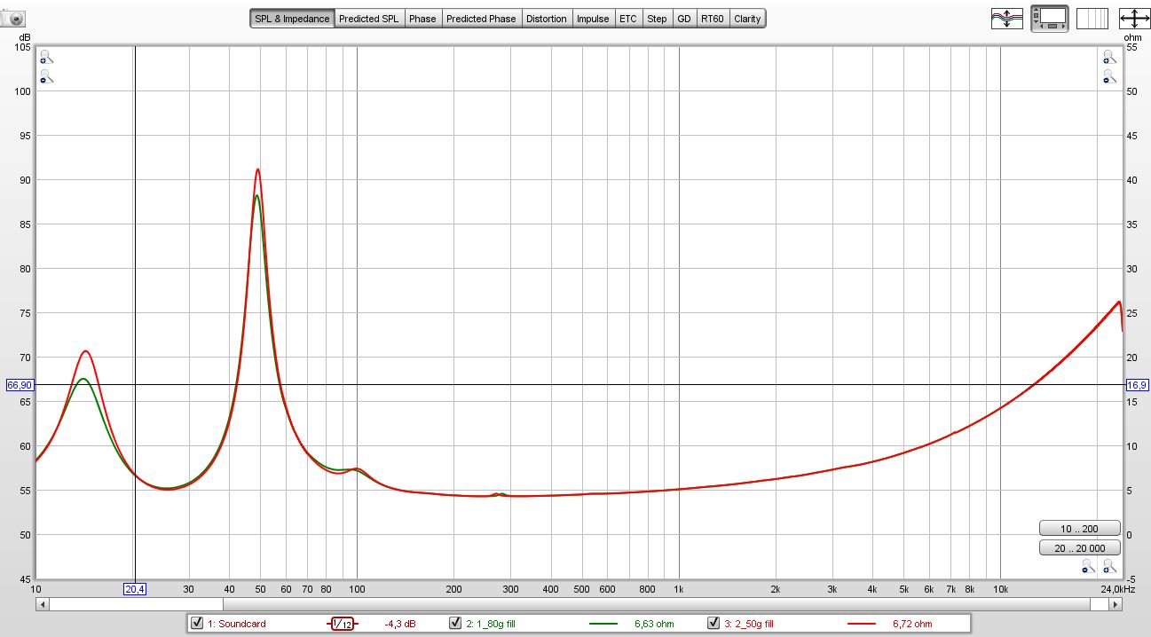

I did some impedance measurments of the Purifi in TL-box.
Comments are welcome🙂
Very low tuning frequency around 26Hz
The "cats ears" are quite different in height. Not sure if I should fill more to make them more even? The 2 curves are with 50 (2oz) and 80g (3oz) fill (wool).
Should I try to get rid of the knee at 100Hz?
There is a small resonance at 270Hz (1,25m). Can it be a standing wave from top-bottom-top of the first section? My internal measure is 82cm but with influence of the damping?

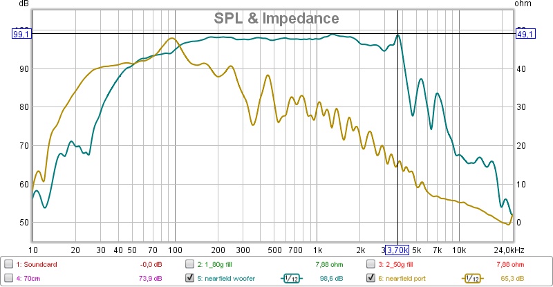

Since I'm on it - here's the nearfield measurments also
There is a peak at 3700Hz. I can hear it when playing music! I'm currently using 1,5kHz 12dB LR and that sounds good. The Bliesma T34A is able to do that crossover point as well.
It's about 9cm from baffle to first internal section. It might not be enough?
Considering the low tuning (26Hz), what do you think about cutting the first internal section half way - giving a shorter TL-length, but would allow the Purifi to breathe better?
