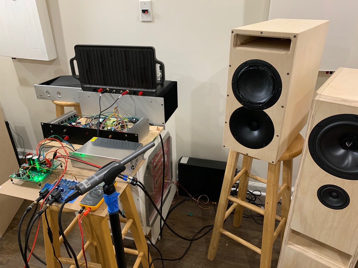

Test setup:

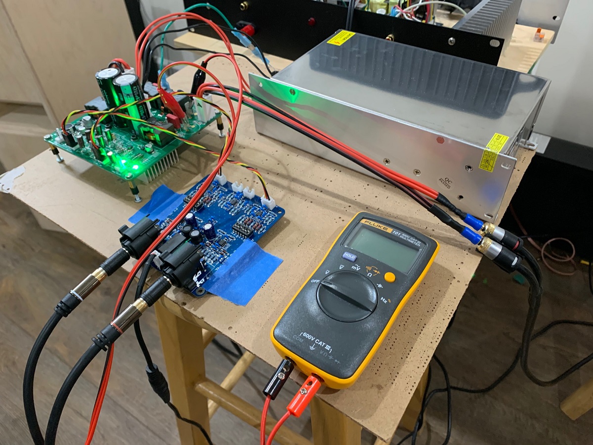

Closeup of the TPA3255 Class D amp (my only amp capable of driving a 4ohm load) with BTSB Buffer and 800w LED SMPS (set to 50v):

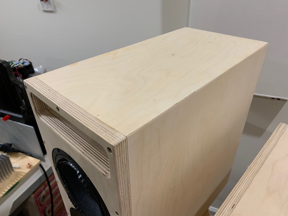

Here is a closeup of the new TL cabinet utilizing lock-mitered joints:

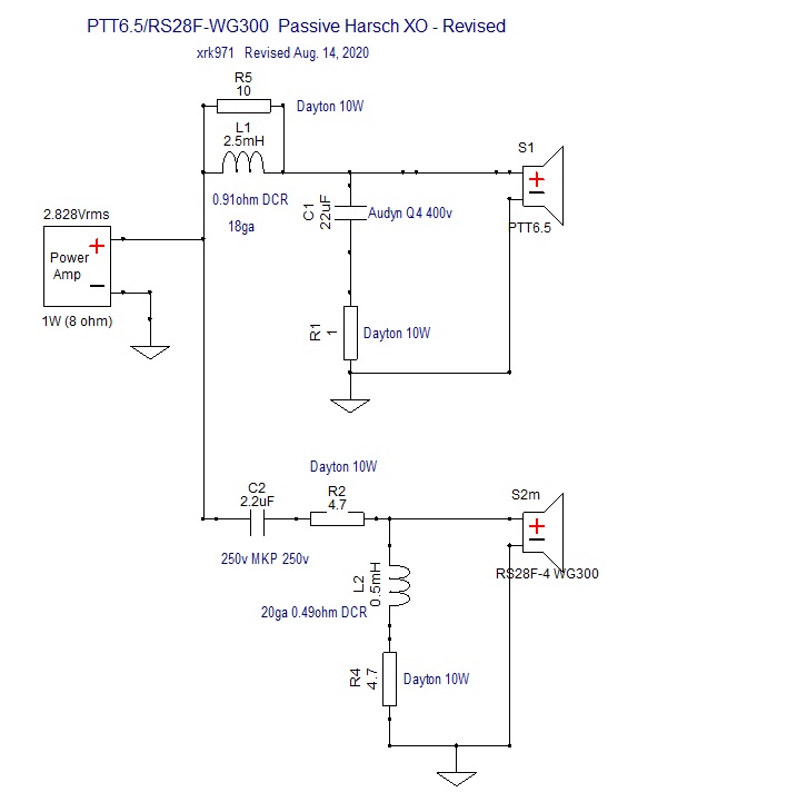

Here is the new XO design schematic:

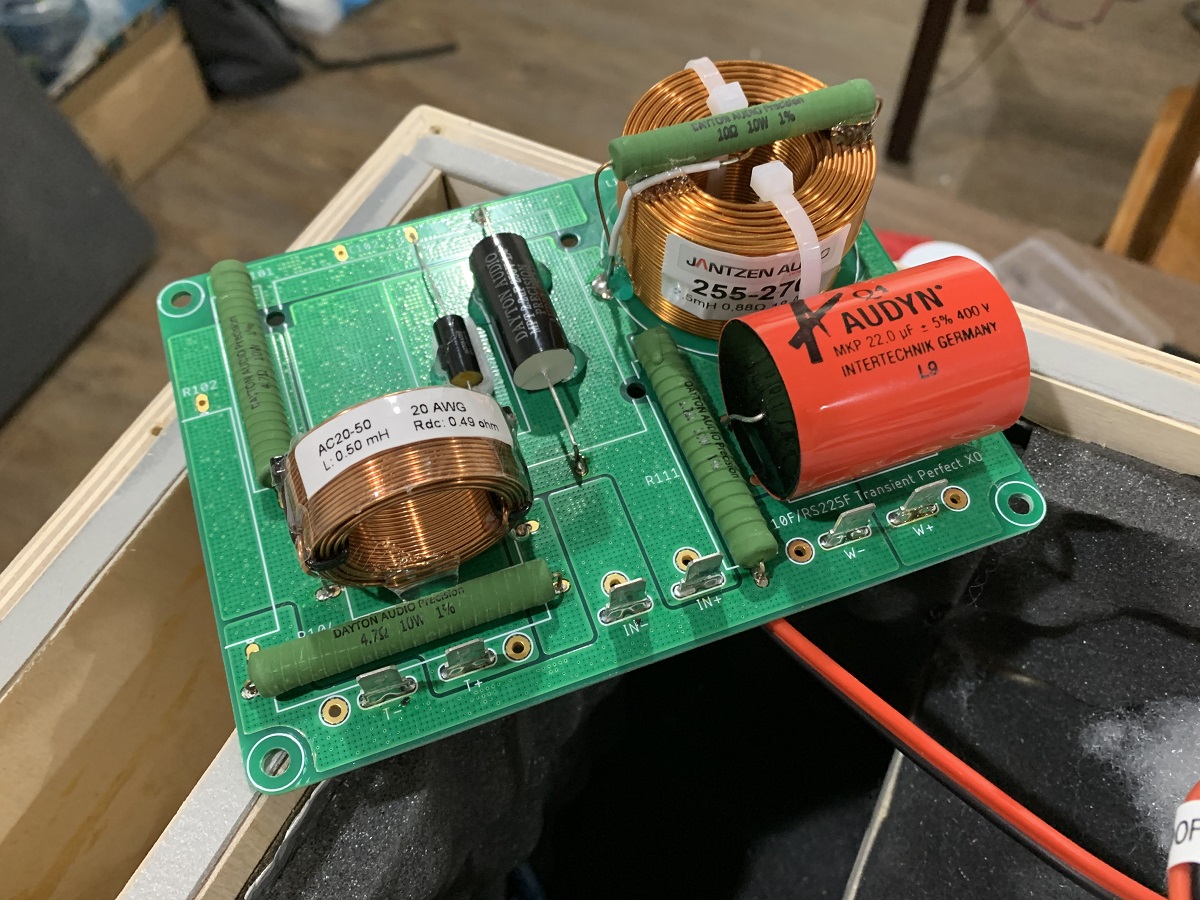

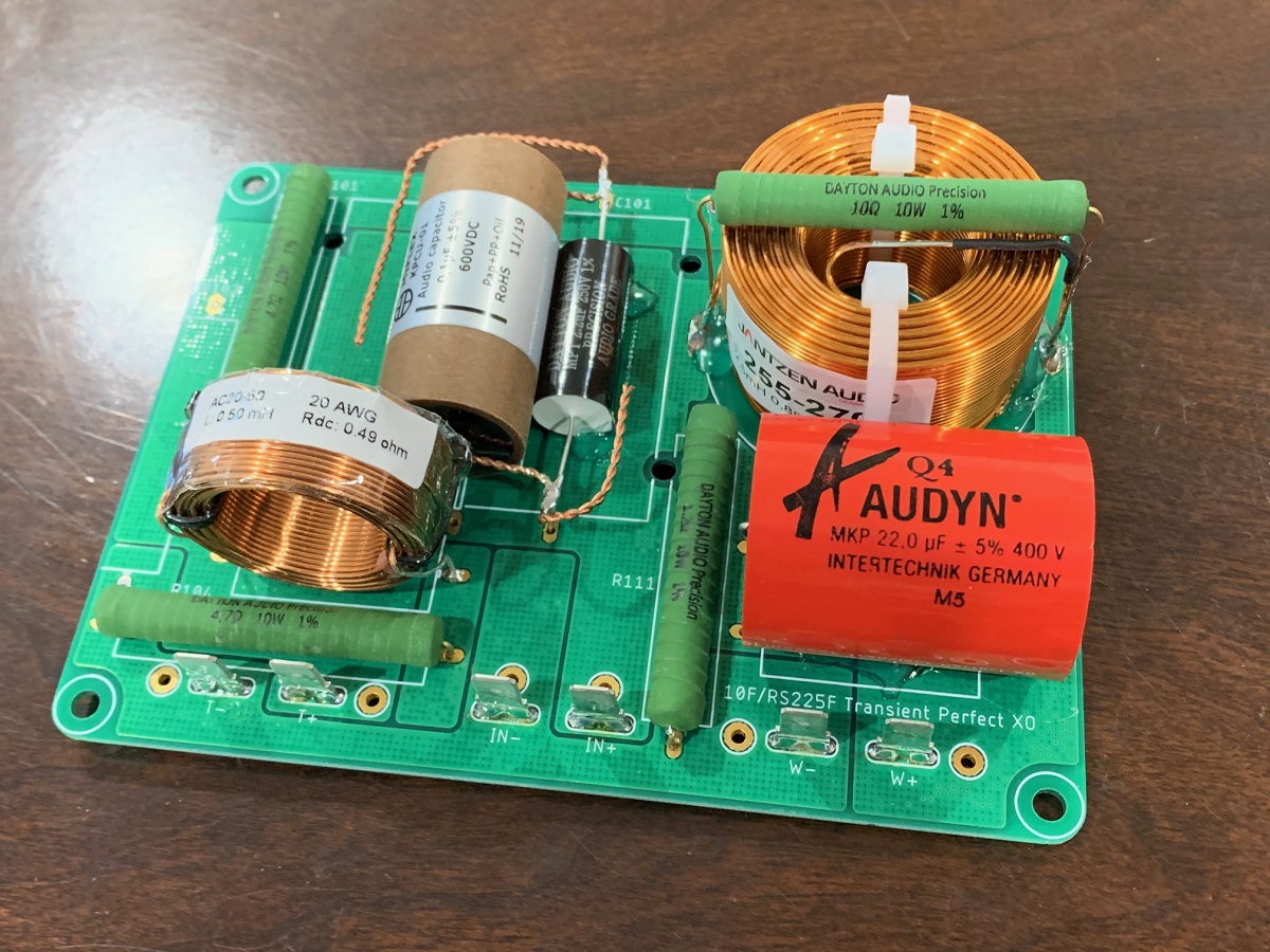

Photo of the new XO using components I happened to have on-hand from my XO development kit:

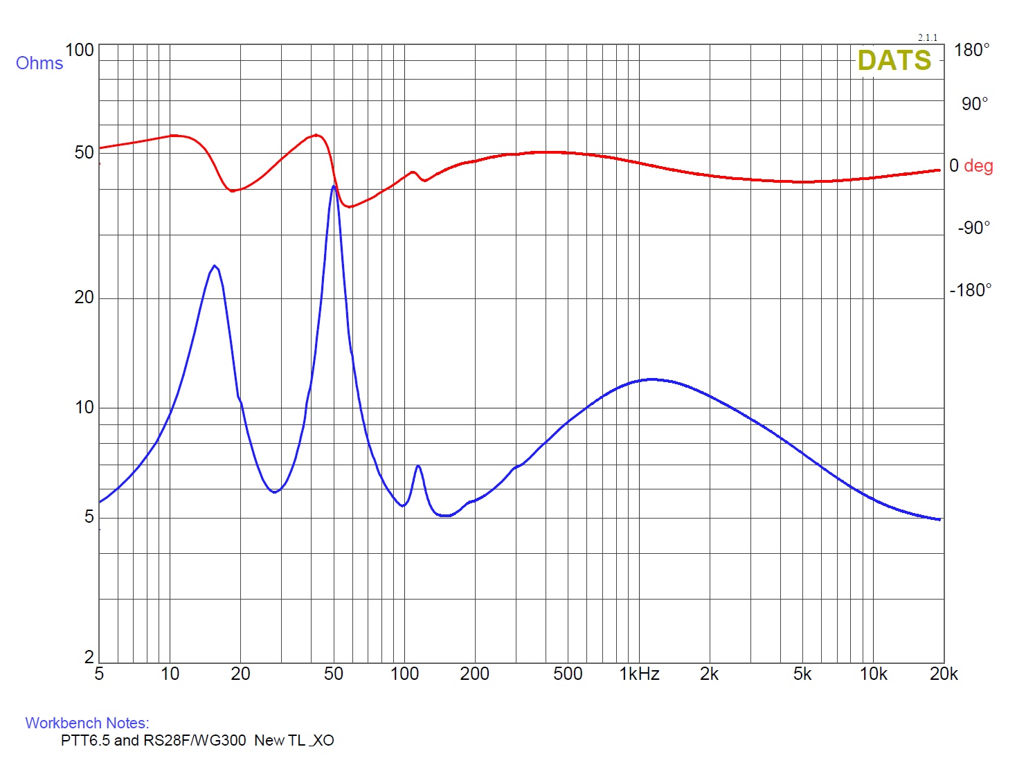

Here is the DATS impedance measurment of the new XO installed in the TL - we can see the TL box freq is about 28Hz:

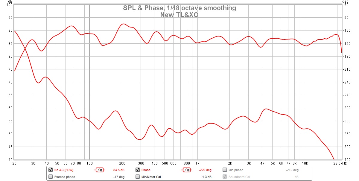

Here is the measured frequency response and phase at 0.5m and 2.0Vrms (scaled to be equivalent for 2.83v at 1m) - the sensitivity appears to be 86dB at 2.83v and 1m, which gives a -3dB point of 39Hz, close to the 37Hz design frequency:

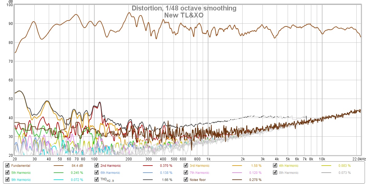

Here is the measured HD vs frequency - there may be some household noises contributing the the floor around the bass region:

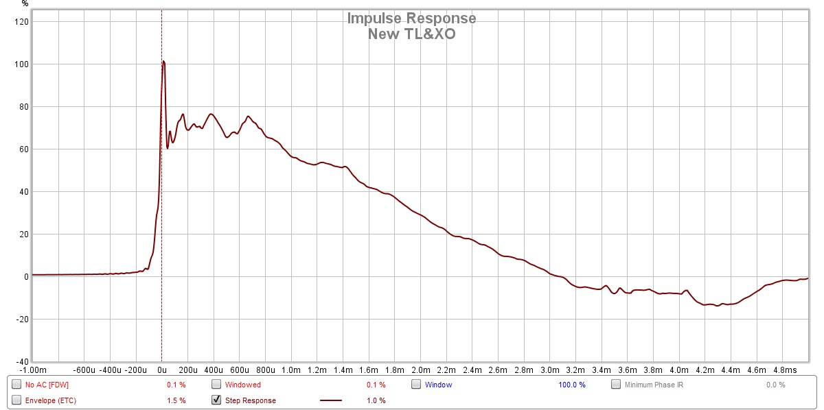

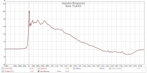

Here is the measured Step Response - still transient perfect Harsch, but better (more right triangle-like) than DSP-based Harsch w textbook filters - I am not sure why that is:

I just built up the new crossover with the actual parts and not parts from my development kit. I thought I would try these new Dayton Audio Precision resistors (similar looking to a more expensive brand) - they are 1%, 10W, solid copper leads. Also added a Miflex KPCU 0.1uF cap to the 2.2uF 250V Dayton MKP for the tweeter. Woofer is using a Jantzen 2.5mH 0.88DCR 18ga air core. Excess leads on the Miflex are left in place in case I pull it off for use in another speaker. Everything is hot melt glued in place if not already tight to prevent rattle.

I just built the second channel XO using identical components (the development XO parts went back to the development kit). I used a Dayton 0.1uF 250v MKP bypass cap in place of the Miflex so that both speakers would have at least the same capacitance value as 0.1uF is not tiny like a 22nF cap. Listening to them in stereo now. Very excellent sounding speakers. They can get quite loud yet play clean for a 6.5in 2-way speaker. Most rooms would find the sound level quite adequate.
