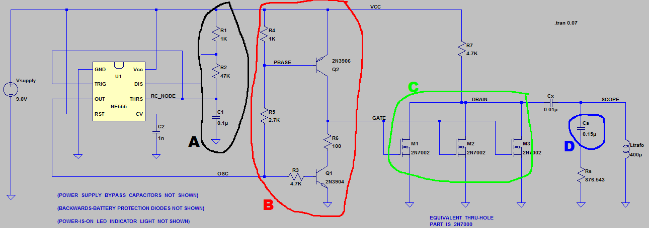

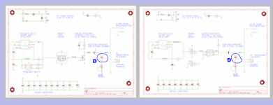

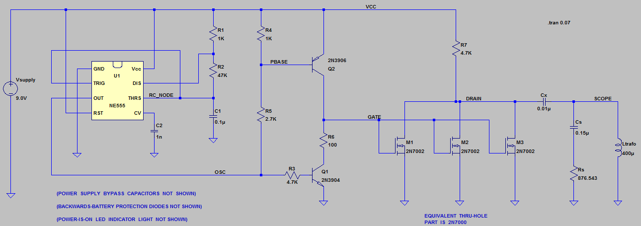

Wow those first two schematics posted in #1202 are small. I asked MS Paint to blow them up by 5X, just so I would have an easier time drawing on them.

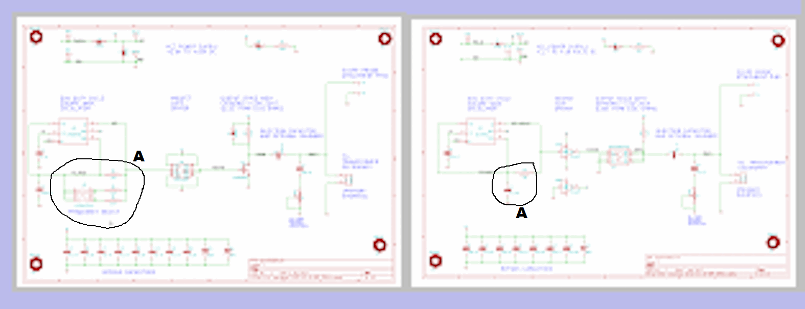

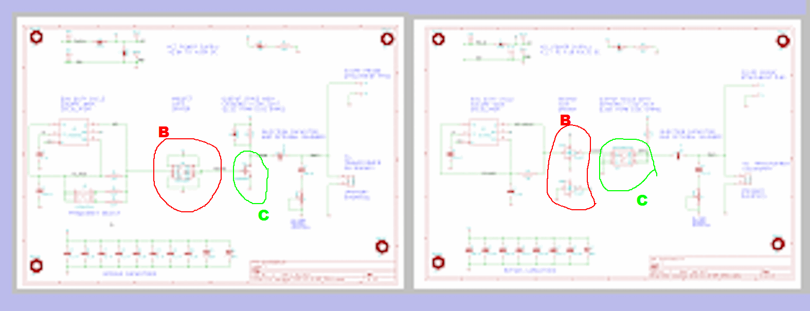

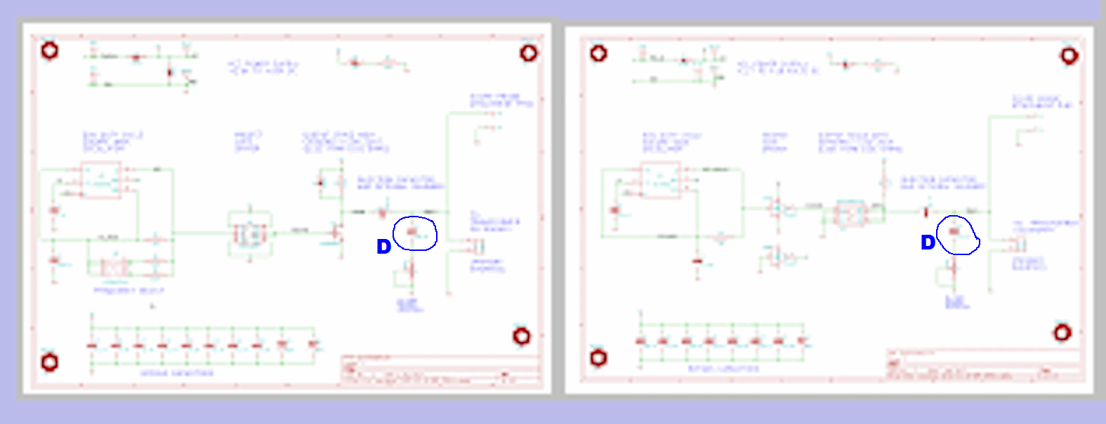

In my opinion there are four differences, labeled with the letters A , B , C , and D in the pictures below. You might want to go back to the original full-size schematics to study these further.
The last one ("D") is different because the surface mount Quasimodo ("v.3") uses a fixed, soldered-down, unchangeable 0.15uF capacitor in this position. The other two boards ("v.4" , "CheapoModo") have a socket in this position, allowing users to swap in different capacitors here, if they so desire.
The other three are self evident from studying the schematics.

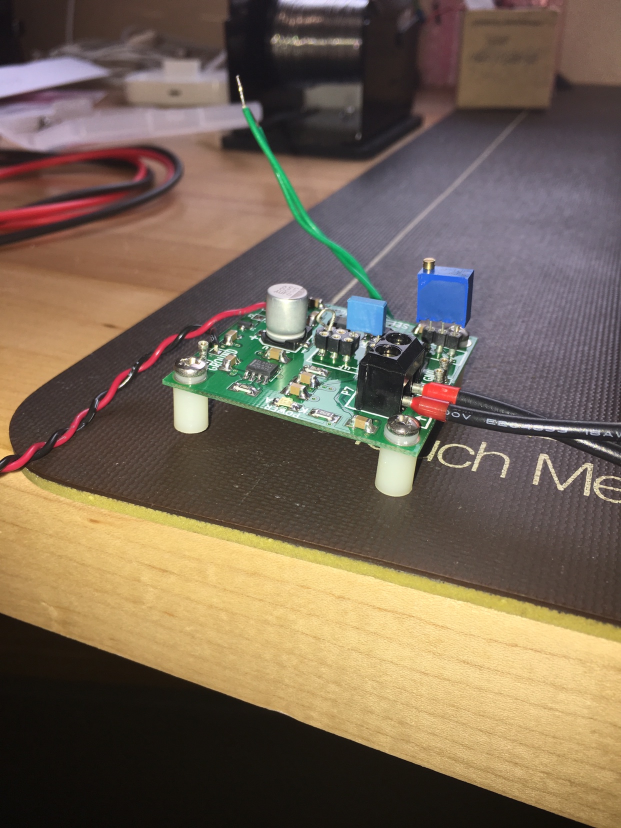

Would anyone like to offer any advice to a diyAudio member who is experiencing difficulties with her/his SMD Quasimodo v.3 ?

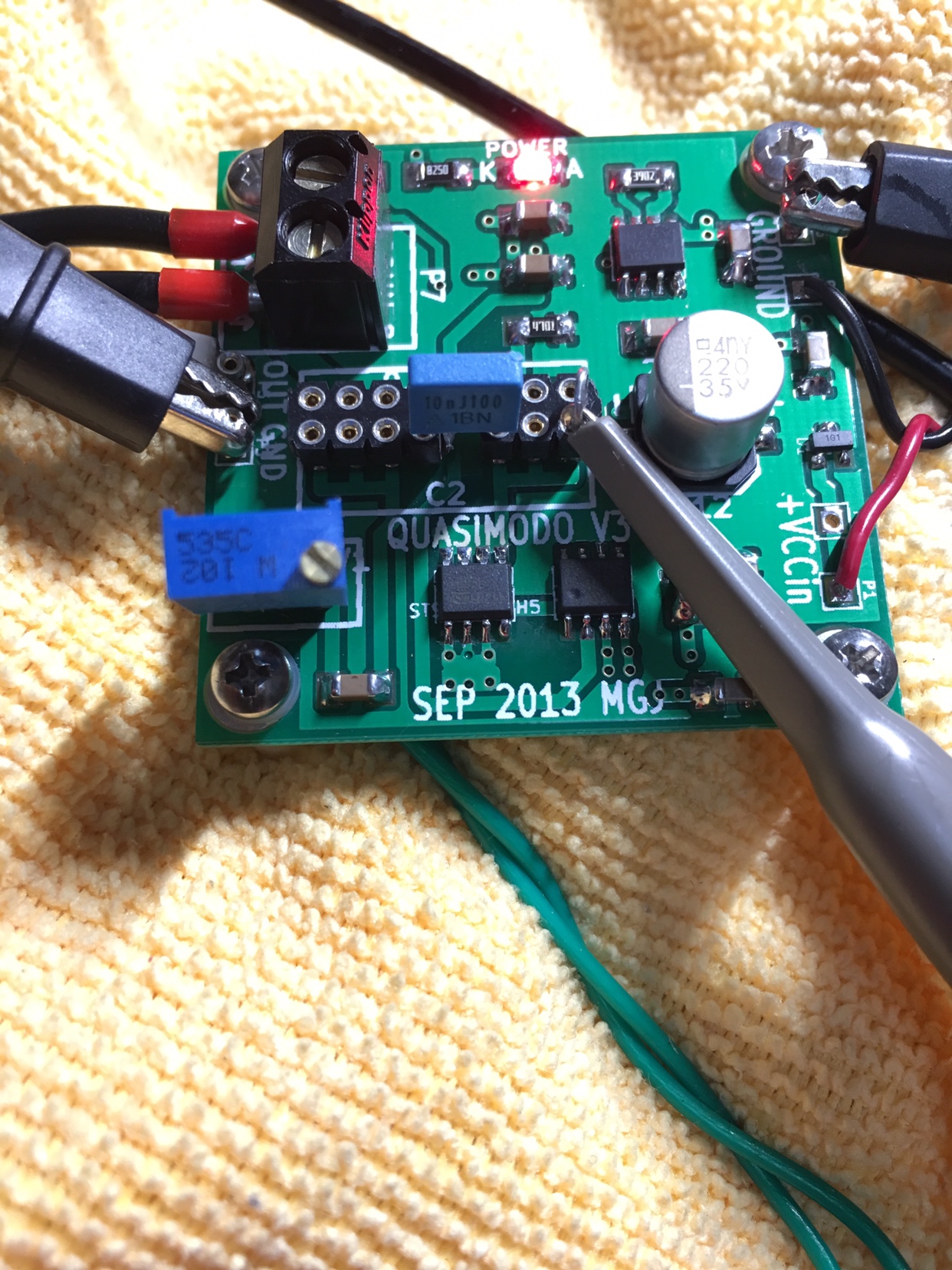

I'm out of ideas about what I'm doing wrong with my Quasimodo v.3. Can't get a desired view on scope. It might be my SMD circuit is not working as needed and it is hard to troubleshoot it due to its size. Can you please help me to figure out? It might be also related to my lack of scope use knowledge and I do not have any friend who can show me "how".
I connected CH1 and CH2 as advised to the board and set AC coupling for both.
Trigger is set to Edge and Falling Down direction on CH1. V/dev is set to 10v for CH1 and 5v for CH2. I played with Time/dev and do see some weird waveforms. I supply 15VDC to that board. Tried several transformers... I start with no trimmer. Do I miss anything?
I just ran into some similar problems building a V4 board because I didn't pay attention to how I connected the transformer :headbash: (single primary, dual secondaries) so be sure it is connected exactly as Mark shows in his tutorial.
Before hooking up the transformer though, check the board over with a scope: Remove C2 (0.01uF cap) and check for the square wave on pins 5-8 of mosfet where they connect to R1 (4.7K Res) - the "input" side of C2. You should see something close to 120 Hz square wave there. I measured 120 Hz on one V4 board and 114 Hz on other. If it's there, then your problem is after C2. If it's not there, check backwards through the schematic.
If this doesn't help, a picture or schematic of your set-up would be useful.
Phil
Are you using a 'scope with a CRT? On my Tek 2445, it is nearly impossible to see the trace in a well-lit room.
I tried both. I have an old analog Tek and I went to max brightness in order to see trace. Played with focus a bit and it worked out fine. I also have dig cracked for 100MHz Rigol 1052. I do not think it is a scope issue. Most likely it is something wrong in my SMD board.
Mark, PH104 and GOR3 - thank you all guys for such quick and excellent support. I found the issue and fixed it already. All works perfectly fine now.
So, I did not get a square wave on PIn 8-Vdd and Pin 5-GND. Then, I inspected all devices located prior that point with my microscope that I use for SRA tonearm setup. I fond that SMD MOSFET got a lifting on one side and all 4 legs are in air. Re-soldered it back and measured 119.5 Hz at that point with perfect shape of square wave. All work like champ now. Measured several transformers and it is very easy to see Rs values. Thank you a lot.

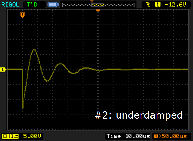

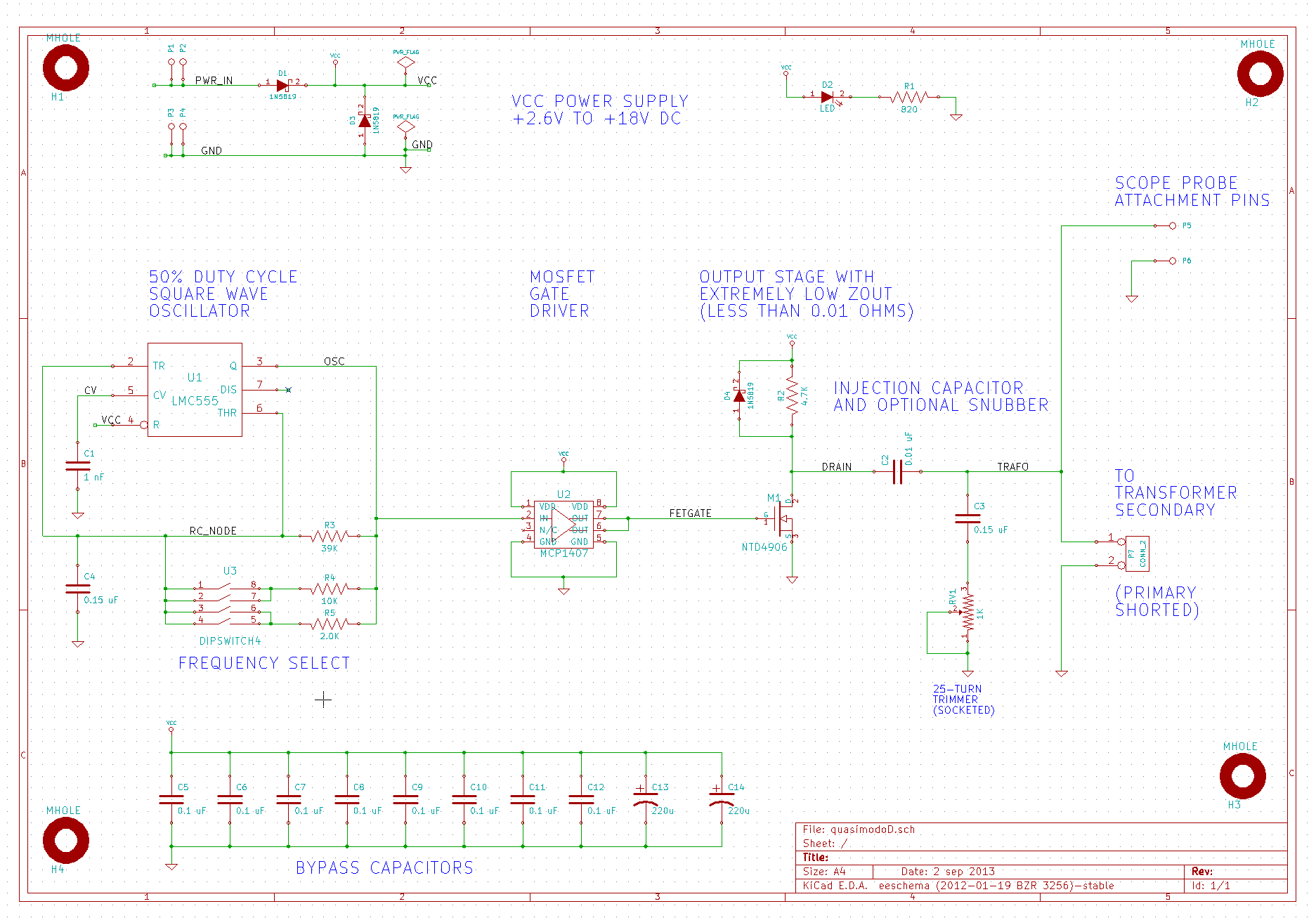

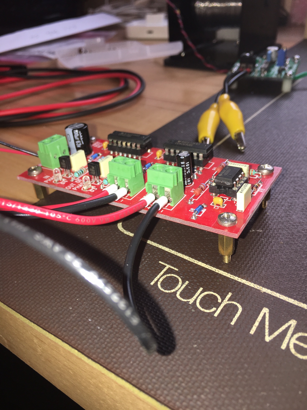

That's why the PCB for v.4 is twice as big as the PCB for v.3; the extra space is consumed by (among other things) a DIP switch and some option resistors. These let you speed up Quasimodo's oscillator, increasing the duty cycle ratio of the CRT beam and brightening the displayed trace.
Have a look at a typical Quasimodo lab experiment, such as the one attached below. If this were an analog scope, its CRT beam would be ON for (12 div * 10usec/div) = 120usec. The beam would be OFF for the remainder of the oscillator's period (8300usec). So the duty cycle of the electron beam painting the screen, is 120/8300 = 1.4% . No wonder it's dim!
v.4 allows you to speed up the oscillator by 5X or by 25X, increasing the duty cycle and brightening the trace by that same factor of 5 or 25.
Of course this is unnecessary for digital storage oscilloscopes that paint the LCD screen from a bitmap stored in RAM. But folks using analog scopes might want to monkey around with the DIPswitches on their v.4 PCB.
