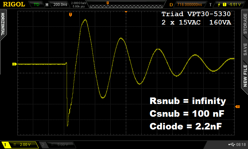

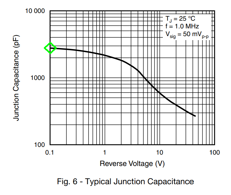

In addition to the VF30100S diode in post #1175 whose zero bias capacitance is 2.7 nF, the Linear Audio test also included the VSB1545 (see Figure 1 below) with 2.8 nF of zero bias capacitance.

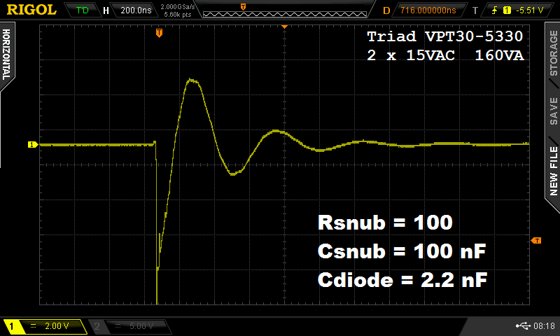

The closest value I could scrounge in my lab this morning was 2.3 nF; I put that capacitor into my Quasimodo PCB in the Diode Capacitance position. Then I installed Cs=100nF and Rs=100 ohms per your suggestion.
The transformer was a toroid from Triad Magnetics: (link to .pdf datasheet). It was medium sized (160 VA) and medium voltage (two 15VAC secondaries). {Morgan Jones might call this "ridiculously low voltage" but I bet his heaters run on 6.3VAC which is lower still}
Results below.
With the 100 ohm Rs removed from its socket, there is no snubber at all, and I got the waveform in Figure 2. Plenty of ringing.
With 100 ohms installed in its socket, your snubber is in place, and I got the waveform in Figure 3. Less ringing but not zero, and certainly not "grossly over damped".

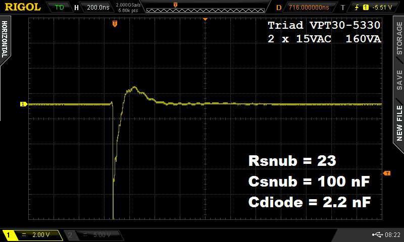

I removed the 100 ohm resistor and replaced it by a 25 turn trimmer pot. I dialled this pot to give approximately critical damping (zeta ~ 1.0), and got the waveform in Figure 4. Then I measured the pot to see what resistance gave zeta = 1.0 damping; the answer was: 23 ohms.
