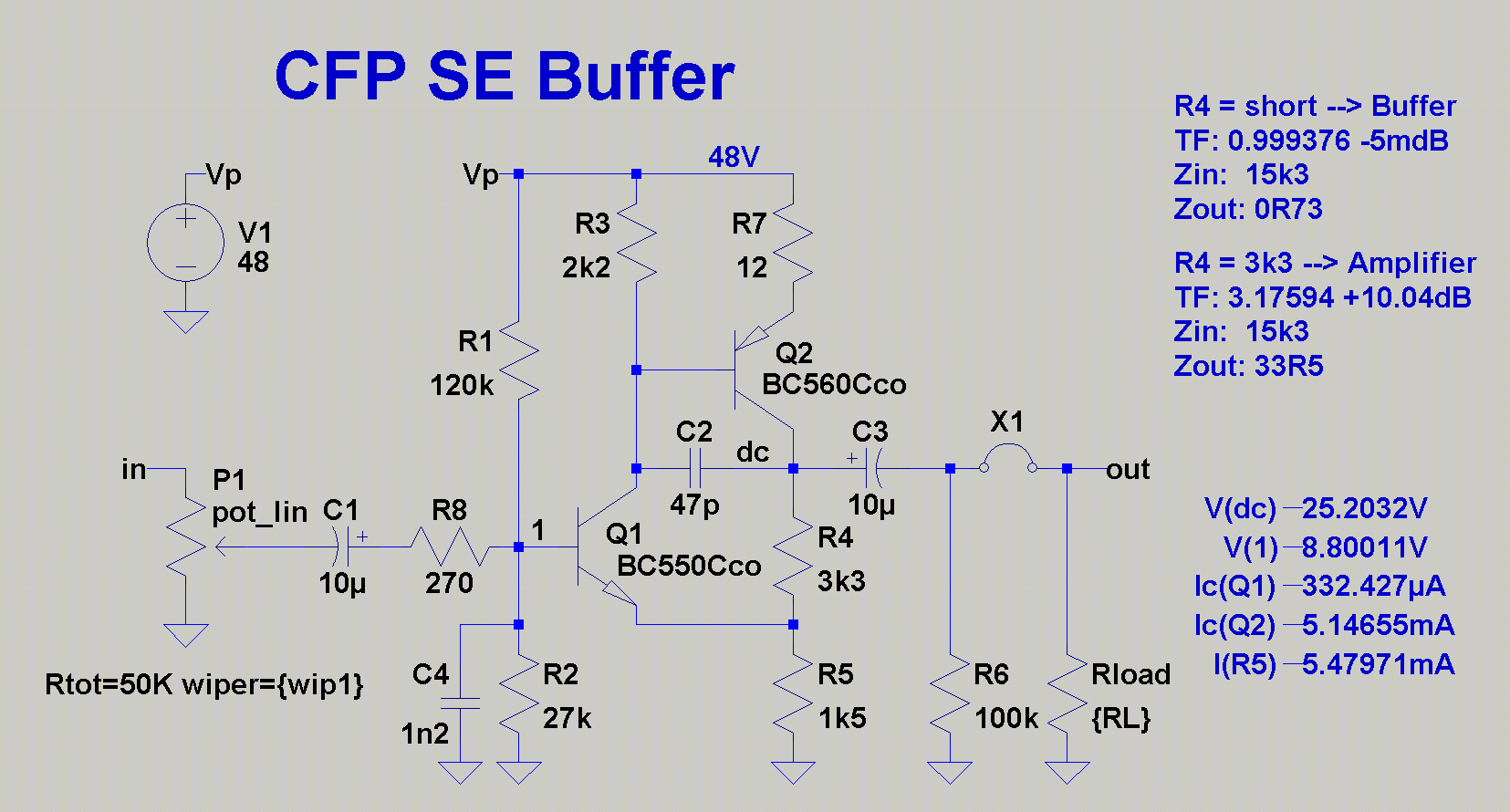

if to choose a Diamond Buffer I´d opt for the cross-coupled version as linked in #10 and shown in #18.
The additional source resistors for the drivers allow for easy control and sufficient amount of the output transistors bias current.
As in #1 and #3 the drivers run hotter than the output trans, which are too low in Bias.
Also the cross coupling keeps the (mean) Vce of the drivers positive and reduces the heat power losses of the drivers considerably against the #3 version (where the sources are connected to the supply rails).
The circuit in +26 is an amplifier with a gain of ~+10dB.
It´d become a Buffer if R33=3k3 were shorted.
It´d also introduces some tweaks.
1) Transistor pair BC550C/BC60C
2) Supply between 24 and 48V. Lower than 24V and distortion rises, higher than 48V and heat power losses get high. THD is low enough in any case and besides it depends more on signal level and load impedance.
3) add a input LP-filter of 270R/1.2nF to prevent HF from entering the circuit. Also the CFP tends to oscillate ... bandwidth limiting (400kHz) might help.
4) add a emitter resistor of 12R-15R to the output transistor.
5) change the output resistor from 47k to 100k. Its just there to leak away the electrolytics charge.
If configured as amplifier the load impedance should be >>1k for inputs >=1Vrms.
Output transistor runs into current clipping, due to Bias current of +5mA.
jauu
Calvin

BC550/560 are very good because of their low-noise nature and high hfe (around 550), however Gino requested 60V supply - in this case they are close to the edge (if not out) of SOA. Also, 5 mA at almost 40V (200mW) is too much power for BC560.
I totally agree, 48V supply is somewhat optimal for this circuit and emitter resistor for Q2 will increase stability. Just make sure to take care of Q2's heat dissipation anyway 😉
Why not waste some Volts and watts and regulate the 60V down to ~48V? 😉

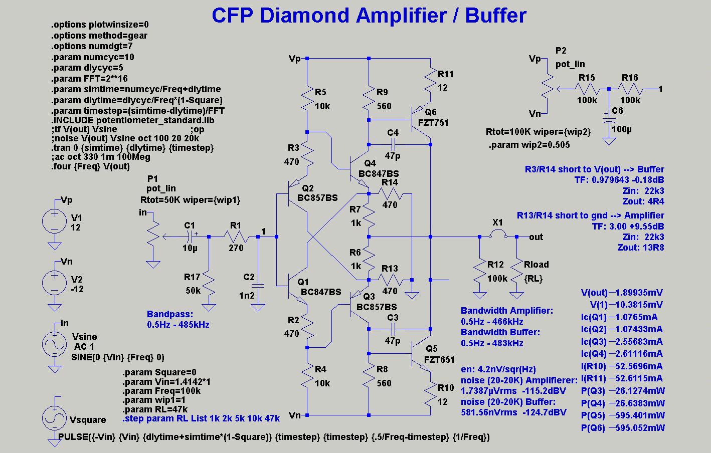

Going complementary again and combining the cross-coupled Diamond and the CFP, allowing to jumper for either Gain-mode or Buffer-mode might look like this.
(fully SMD, low-voltage Dual Supply, 600R balanced capable)
jauu
Calvin

Calvin,
you very kindly gave a lot of supplementary data to the asc of post43.
I see the Rin=15k3
The 27k//120k gives ~22k.
There is a missing 50k to give the final value of 15k3.
Is the input impedance of the BJT (Q1) ~50k?

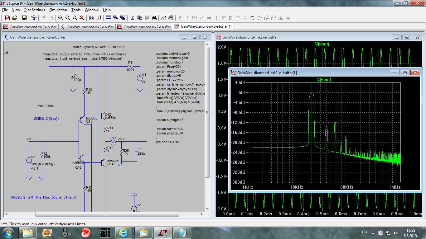

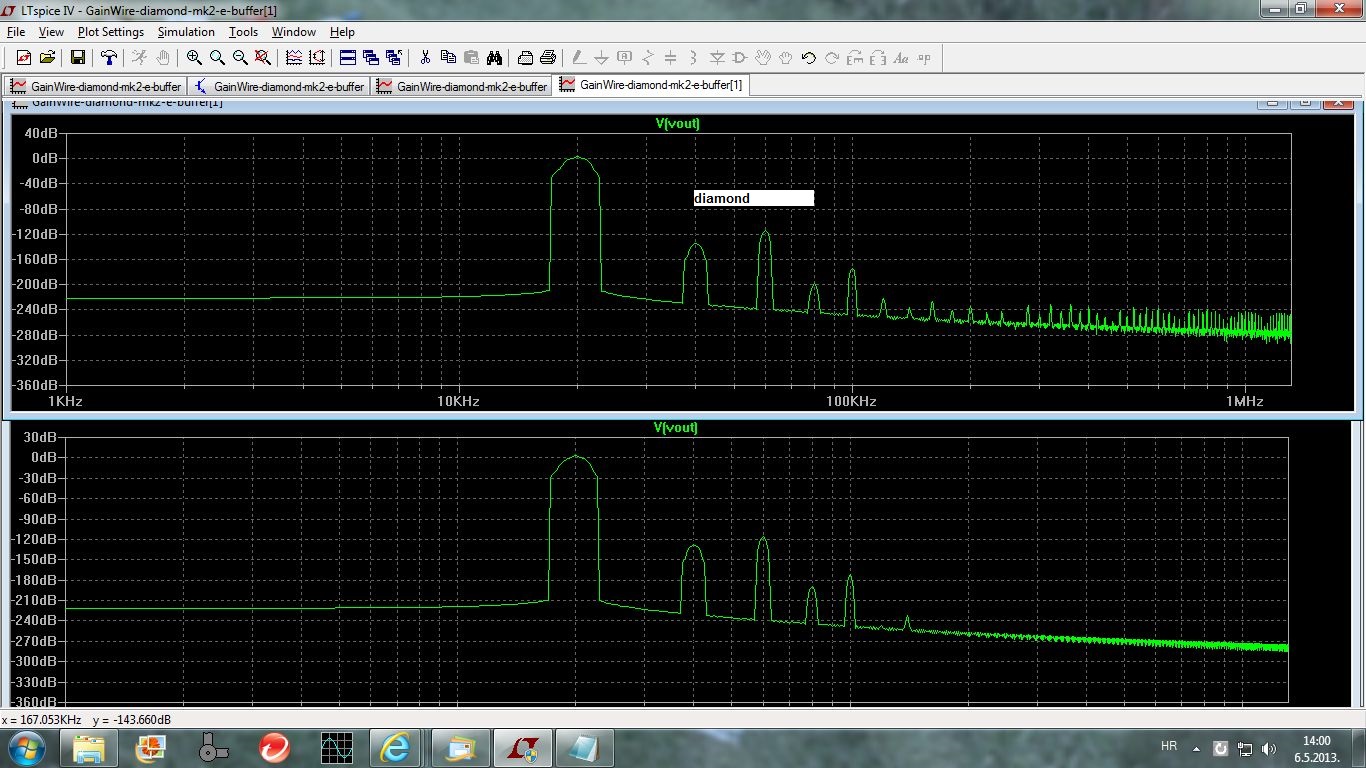

I used different cascoded Diamond buffer for GainWire mk2 line/phone amp, with very low distortion when used with no GNFB and vanishing low when used as CFA. . http://www.diyaudio.com/forums/solid-state/235695-no-nfb-line-amp-gainwire-mk2-25.html#post3799212 and I plan to make it next in SMD.
Damir

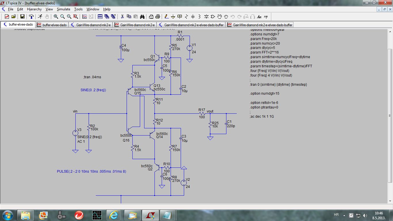

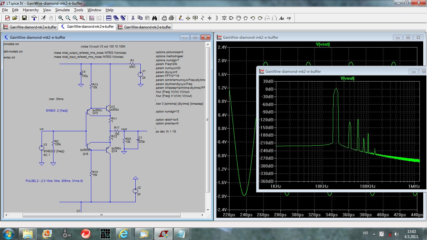

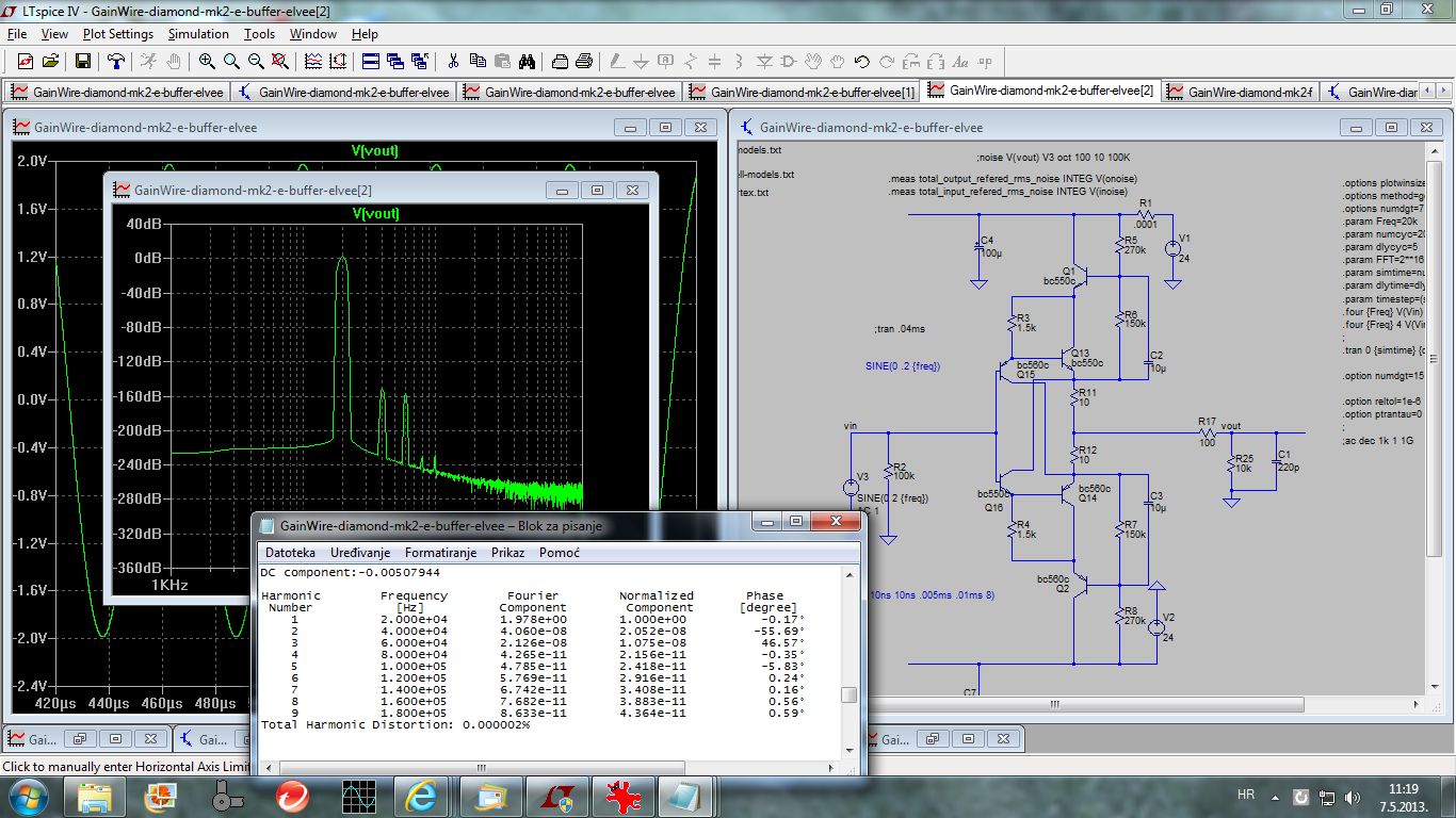

Thanks Elvee for your suggestion.

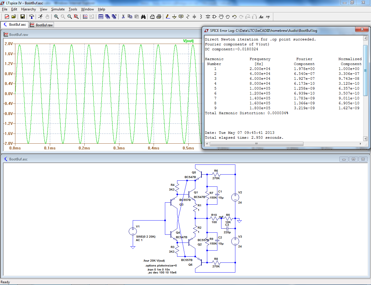

I put it even father and now distortion at 20kHz is 0.000002%.
I am going to use one of those buffers in my lineamp(no NFB) and I am not sure if the complexity is to much as the gain block is in 1ppm region.
Could be that simpler version of the buffer is good enough.
Damir
Hi, very impressive measurements.
I am a beginner with Spice sims and this circuit is unbelievable ...
Sorry i got lost a little in the replies 😱, but i wonder if your have actually built it.
If i understand well the sim results fix the theoretical max we can obtained from a circuit.
Anyway congratulations again for this result. Impressive.
Never seen something of similar.
Thanks and regards, gino

Gino, very similar buffer was used in my GainWire mk2 line&phone preamp, 20 PCB sold.
Damir
