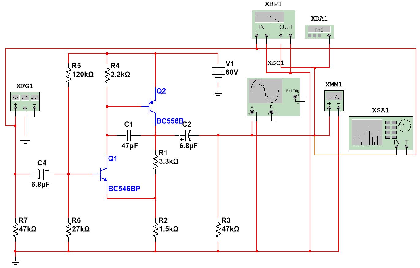

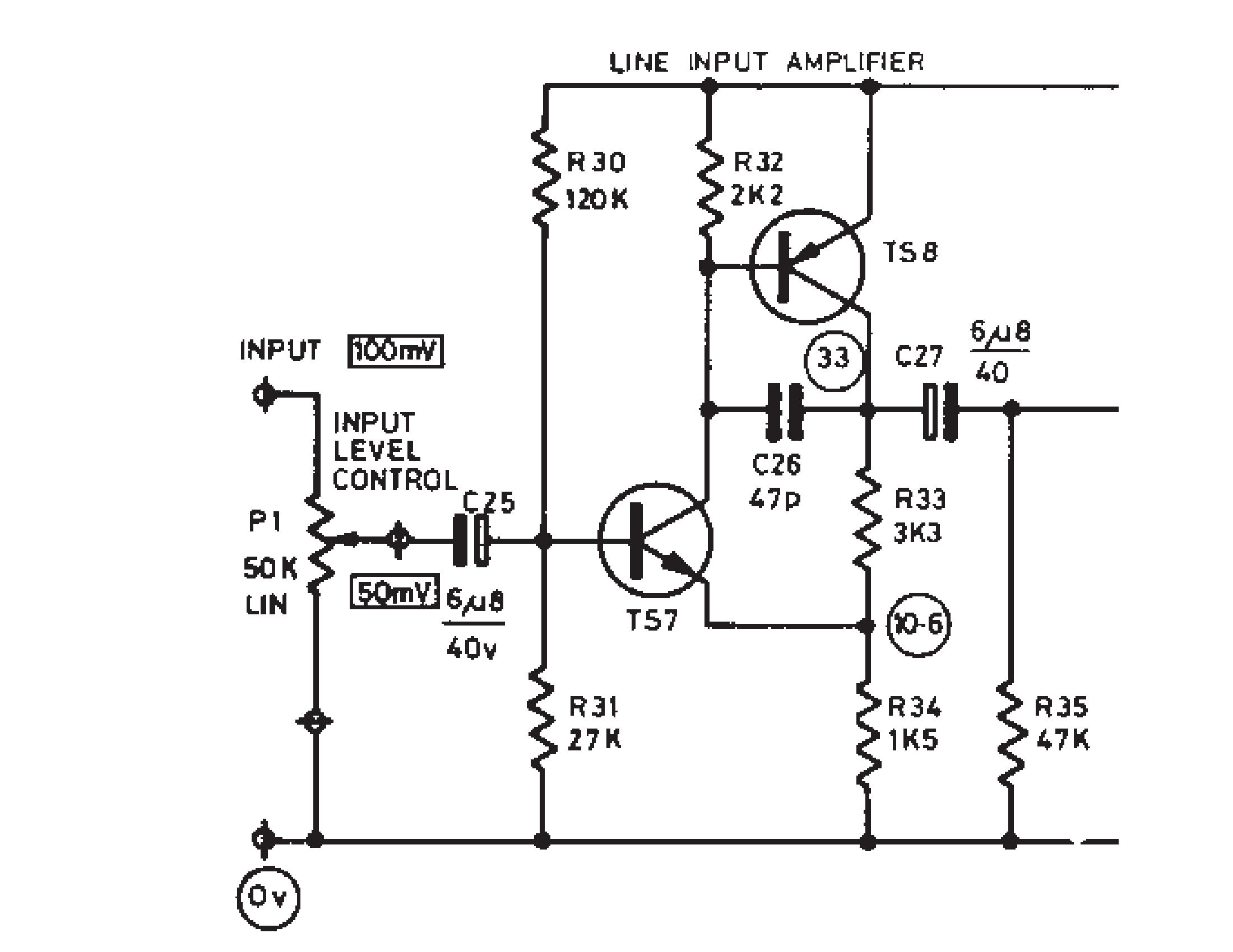

Hi and thank you very much indeed for your valuable advice
So you mean that a stage like the one attached has no chance to be linear and extremely low in distortion ?
This is a very fundamental question for me at this stage.
Anyway ... i understand that i am quite alone in seeing the challenge of achieving extremely good performance with extremely simple topologies 🙁
Maybe i am mistaking but i remember at least one very famous designer saying that after all his simpler (topology wise) designs were also the better sounding.
Personally i would start from that statement when selecting a suitable design, at least for a line stage that is the my major and almost only interest.
I wonder if someone is so nice to simulate it for me ... just for fun.
It could be a surprised.
The single supply voltage is 0-60V and the bjt can be almost all signal/driver pnps and npns. The pnp tends to heat up a little.
Kind regards, gino

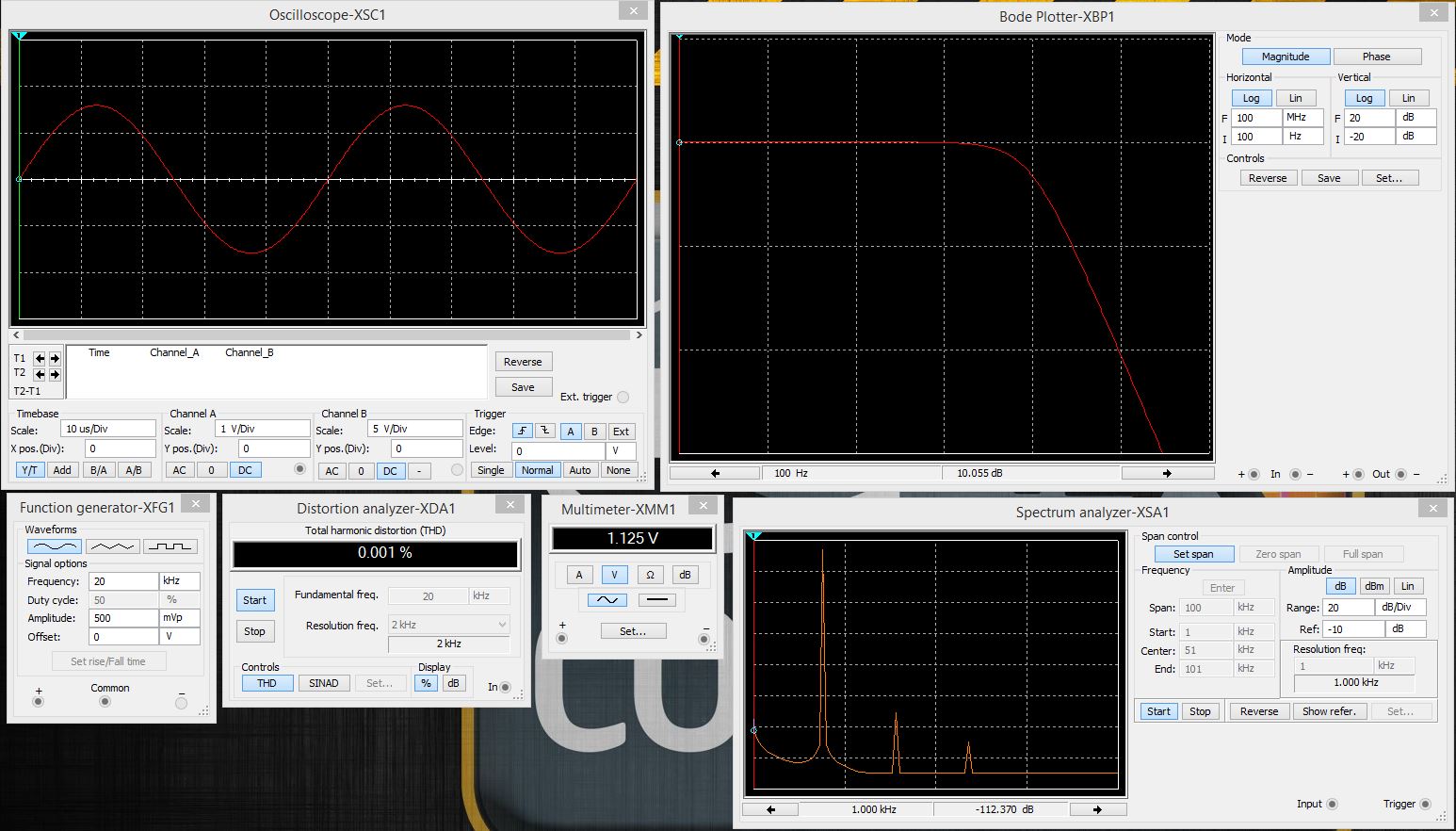

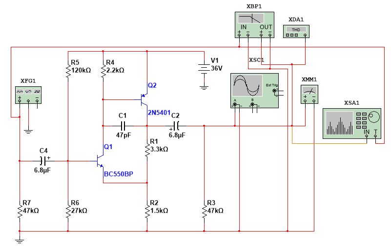

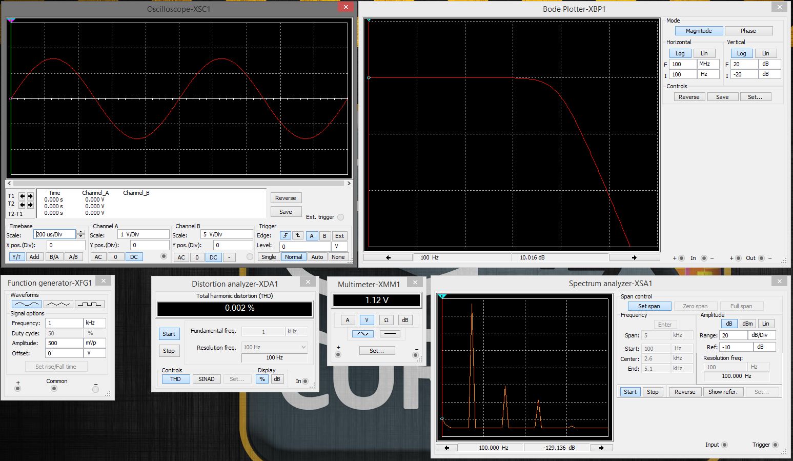

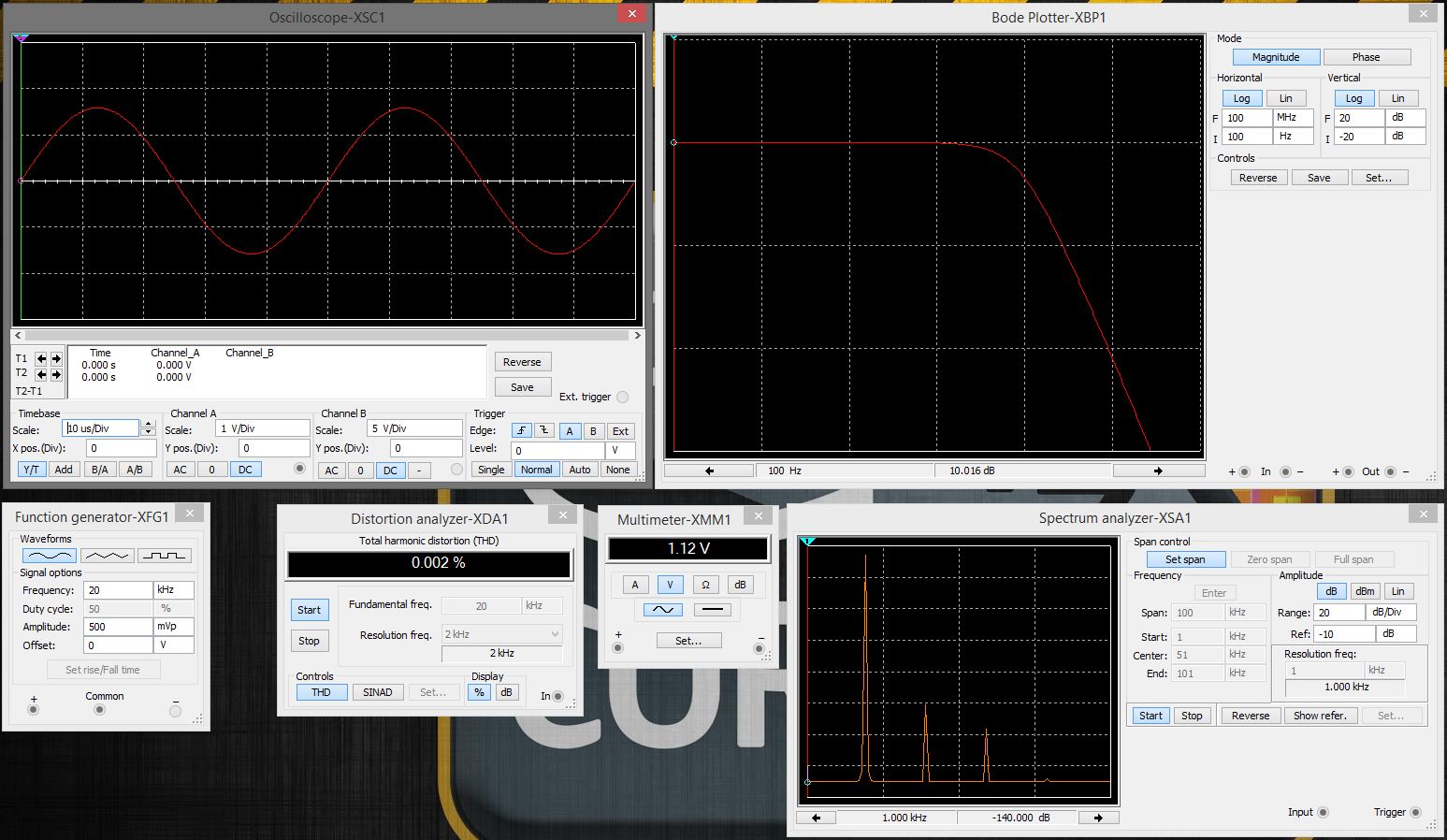

Simulation - easily 🙂
First picture shows the setup
With 36V power supply, collector current of Q1 = 330uA, Q2 = 5mA
Voltage gain = 10db
Frequency response - linear up to around 300KHz
Second picture - output swing 1.12V RMS @ 1KHz
Third picture - same swing @ 20KHz
Forth picture - same as the third one, but showing the phase responce instead of the frequency one
Harmonics distribution is nice.
Lower power supply voltage leads to significant distortion increase.
If you have questions - let me know 😉
Voltage gain = 10db
Valery
Voltage gain = 10db
Valery
Valery
Hi sorry Valery ... i have not been clear enough
The supply voltage is 60V not 36V !!!
This is the very secret ... a very high voltage supply i have been told.
maybe the distortion could be even lower ??? that would be fantastic !
If so i will focus completely on this circuit to try to build a line stage
I have already seen a kit on ebay for a nice 0-60V single power supply
Tell me about your set up to run this simulation ... i low the screen output.
Beautiful indeed !!!! Is it expensive ???
Thanks again and kind regards, gino

OK, sorry, no problem )
For 60V supply we have to use a higher voltage transistor than bc550.
See an updated schematic attached. Q2 will be good to equip with a small heatsink - dissipation will be around 200mW, relatively high for T)-92 transistor.
Overall distortion is a little bit lower, but what is more important - 3-rd harmonic (the "bad" one) is significantly lower. Don't worry about the 2-nd one. Very good performance for such a simple circuit.
Valery
Valery

I can tell you that i tried to make a prototype of this circuit
I was the mind 😱 a friend of mine the arm. I think he is quite good at diy, much much better than me. But he is a tube guy ... i think he is very wrong anyway ... tastes are tastes.
We noticed that the pnp was heating up so we decided to use a toshiba pnp in to220 i do not remember the part, but it was a good one ... a 10W piece i think and this did not required the heatsink
Something like this one here ...
http://www.customworks.cz/wp-content/uploads/2012/09/2SA1837.pdf
( i would use even a 150W just to avoid the heatsink)
I was liking the sound quite ... nothing special i would say but decent
My friend was not impressed. We use cheap metal resistors but an attenuator and very good mundorf pp caps.
Then he replaced the feedback resistor with a Caddock i think ... or something similar.
What a big improvement. At that point the project stopped for his family problems (the prototype was in his living room and the wife protested)
even if i was sure that the circuit had some potential for good sound. I had this feeling.

I think that the simulations have answered most of my questions.
That is that acting of the various conditions like Vsupply, bias currents and so on very low distortion figures can be obtained with quite basic topologies.
I have to simulate something for myself now.
Thanks again for the helpful advice.
