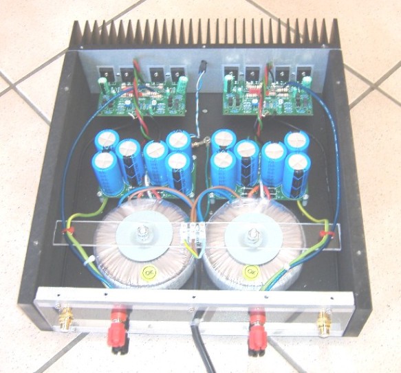

Hi HiFiddleHiFiddle said:It has veneered MDF sides and the base , front heatsink and top mesh plate are grounded to the mains ground.
Very nice. Is it the standard 150D or have you applied all the current mods to it?
rgds
No, I built the modules as per the instructions I received before the mod was released.
I thought I'd burn it in and have a good listen before doing the mod. The way it's constructed, I can drop down the front heatsink 90 deg to access both sides of the PCB so it should be simple.

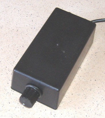

Looking forward to it. Greg is making up a volume pot with active buffer for me to run the CD player direct and still have a low impedance drive to the GB150. He has PCBs for these. I should have it in a couple of days.

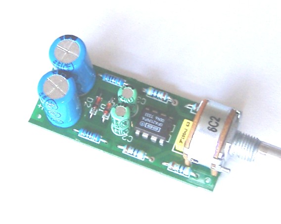

Hi HiFiddleHiFiddle said:... Greg is making up a volume pot with active buffer for me to run the CD player direct and still have a low impedance drive to the GB150. He has PCBs for these. I should have it in a couple of days.
Sounds good. Keep us posted on your thoughts/impressions and progress 😀
In the meantime the active buffer sounds interesting. I use a passive volume control, so, I must send him email and ask him about them 😎
What benefits are you expecting (or Greg has informed you off) by using the active buffer 🙂

Greg gave me a pic of the PCB. It's small enough to fit into many amplifiers, not mine though. You should contact him -
http://members.dodo.com.au/~gregball/guru_001.htm

couldn't wait for my cases.
Jury rigged my first GB150. No mains safety earth, there's nothing to connect to.
300VA, 35Vac +35Vac (from 230Vac but used 240Vac).=103Vdc
+-2*15mF63V smoothing = 60mF total.
Dual 25A bridge rectifiers.
100r+47nF pes snubbers across each leg of the bridges. Just a guess.
100nF cer across the ~~ of the bridges.
Both cap and Zener modifications incorporated into the LTP CCS.
10uF63V electro, 36K, 18K & 20V5 Zener. not 27k+27k+15V.
0.6C/W sink.
On first power up (using light bulb) the voltages rose nicely and output offset was 7mVdc, with the input co-ax shorted. Didn't need to tweak the presets. Output bias low at 280 to 400mV (28 to 40mA) and seems to vary oddly but both halves always identical.
Now plugged direct into mains, output offset =9mVdc
But unusually, the output Vac measures 0.0mVac on my multimeter. All my previous efforts read at least something on the lowest scale. Seems as though the PS artefacts are completely eliminated in the volt amp stage!
If the zero DMM reading means less than 0.05mVac (half LSB) then hum and low frequency noise are about -120db below maximum output. That's an excellent result. I have never achieved this before.
Now dare I try listening when the contraption is sitting on an offcut of chipboard flooring?
