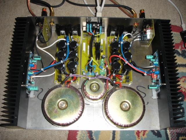

Hi guys,
I've been reading this thread for quite a while. It was reading this that made me decide on the GB150's in the first place. We'll, I've had mine run for quite a while now, although the case is not complete yet (I'm not into metalwork too much, so it's been painfull). I've attached a pic showing how far I am, but there is still quite some work left. Basically, I just bought 2 modules to see how it would sound, before splurging on buying the rest to complete my HT setup. As anyone who has built these can attest, these things sound FANTASTIC!!!!!
I suppose it goes without saying that I'll be purchasing more of these to complete the system!!
I'm not one for the fancy audiophile speak, but all I can say is that this is THE most fulfilment I have had with a DIY project in a REALLY long time. All the comments in previous posts are spot on, regarding the SQ of these modules.
By the way, I write embedded software for a living, so my amp just HAD to be microprocessor controlled. It's not complete yet, but it'll get there. I kinda got side-tracked listening to the thing instead of working on it. Also, I added the ability to have DC protect and anti-thump, plus balanced drive.
Anyways, just thought I'd share
Cheers
Gert
Cheers
Gert
Hello Gert,
Couple of q's:
I am also in SA; Where did you buy your transformers, what are their specs (VA and AC) and what did they cost?
What rectifying diodes are you using on the power supply?
What is the board with the relay on it on each channel and did you buy it or design it?
What is the board down the center?
Have you built a gainclone before and if so, how does this compare soundwise?

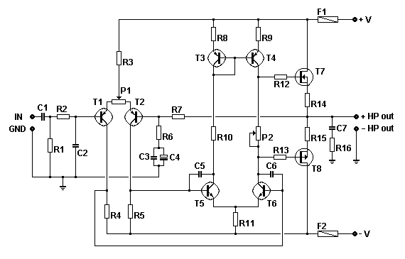

Please take a look at this schematic that i found at http://users.swing.be/edwinpaij/ampli_mosfet_simple.htm and tell me your opinion(or anyone in this forum),if it can be work well, at least it seems to be a decent circuit, with more controls to adjust it (I don´t want to explode mosfet´s because are more expensive that the BJT´s).
Even in this page there is an upgrade version of this amp with some components but that.
Also if somebody build it that write a comment
Thanks to all
Thanks to all
Hi Ryan,
Whew, I'll answer the q in order
1. Transformers are from Toroidal Technologies, they are 225VA each with 35-0-35V secondaries. They cost around R220 ex VAT. Tel number is 011 615 7245, talk to Jan
2. I can't remember the rectifier diodes part number, I'll check at home. They are TO220, around 1kV and about 10A or so.
3. That board is the anti thump relay and it will eventually have all the balanced line receiver parts on it. The anti thump is my own design, controlled by the MCU board in the middle and the balanced line circuit is pretty standard. Don't have schematics with me.
4. Board down the centre is the MCU board (I know, it's overkill!!)
5. Nope, I haven't built a gainclone. I suppose I've never liked chipamps, personal thing really! The SKA is not THAT expensive in kit form, so what have you got to lose. At least that's what I figured and it turned out quite well.
Cheers
Gert

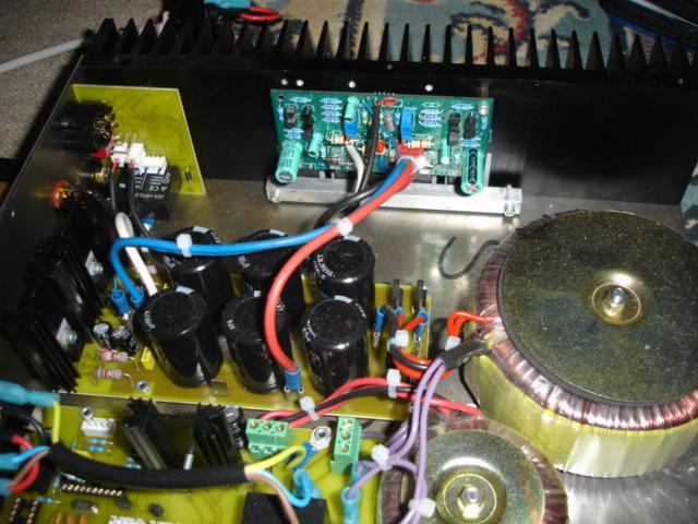

Hi Gbyleveldt,
You have some pretty good skills showing through there.
Can I make a couple of suggestions.
1. the input coax runs a bit close to the PSU to amp power cables and they are parallel. Try re-routing the input coax near the case edges.
2. the two bolt fixing for the output FETS leaves the strong possiblity of flex in the Aluminium bar allowing more force on the outer FETs and considerably less force on the inner FETs. In the extreme the inner FETS could have no clamping force if the securing bolts were tightened excessively.
One extra bolt in the middle removes most of the problem.
Would you like to share the monitoring schematics with us?
Is the software easy to download if sharing?
What level of expertise do we need if we were to follow down a similar route?

@ AndrewT
Thanx for your suggestions, much appreciated! Regarding the alu bar, I put small pieces of rubber between the bar and the fets, so creating even pressure over all the fets, but I agree that your's is a better idea, I'll definately incorporate that. Why didn't I think of that
I'm still busy finalising the DC protect side, it is a little board that plugs into the CPU board. I'll try have a draft up a bit later. I haven't had TOO much time to play with the software, I spent most of my time on the pre-amp software (another project). Not all the safety features are running yet, I just couldn't wait to hear the thing, so I took a temporary shortcut!
I do most of my software in C running on AVR CPU's. They're VERY easy to use. I will gladly share the code and schematics once I'm done 😉
