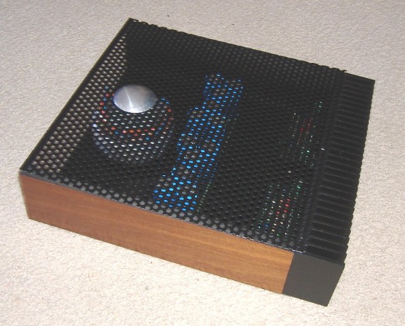

Greg sent me pics of a 'simple' stereo GB150D chassis he has near completion. It uses 300mm square steel base plate, steel perforated mesh cover and nice 'warm' wooden sides.
Seems corrupted. I'll try for another copy and post it later.
Here's Greg's simple SKA case concept

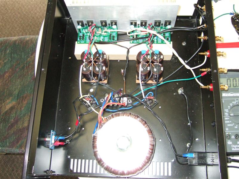

ska up and running
Finally got my gb150d running, only 30 minutes. Transformer is avel y23 500va, ended up 51v dc. Caps are 4 nippon chemi-con 63v 6800uf kmh 105c per side.
Heatsink is barely warm, my speakers are fostex ff165k, 94db in bib folded pipe.
early yet, will have to re-check bias and dc on output
Most people find these projects a breeze but I found it challenging
enough
cheers
doggy:cool:
is that a wire I see before me?
From the central bolt between the smoothing caps to the terminal block I think I see a pussy cat, no, a bare copper wire link, am I correct?
I do not recommend you connect chassis (mains safety earth) directly to the audio ground. Are the two black wires the PCB ground reference?
How have you connected the smoothing cap common to the audio ground?
grounds
Hi Andrew,
Yes, that is a solid copper wire link from the ct junction to ground. The output grounds are also connected at the ct junction block. There is also a separate mains ac ground over to the side.
There is very little hum, you have te get close to the cones. The input signal wire is coaxial.
Where would you attach the board ref. ground?
cheers
doggy :)
an audio ground could be formed from a brass bolt with a selection of brass nuts left floating above the chassis. An insulated tag strip could be used to support it and the disconnecting network that you may decide to fit.
Bring all your audio grounds to the brass bolt and attach them in groups to the bolt with a nut between each group:- Transformer & PSU, power (Large I including decoupling and speaker), signal (small I).
