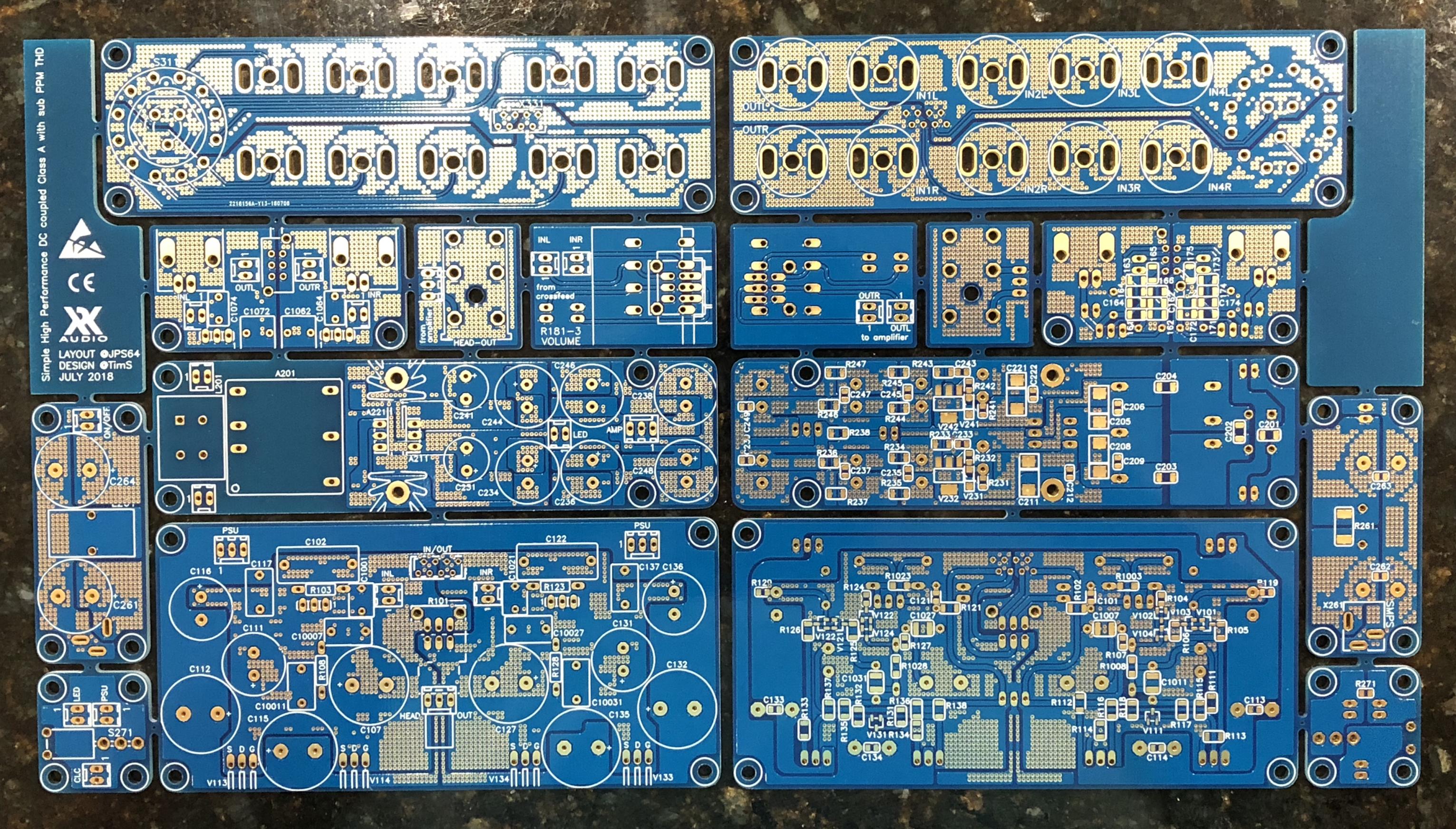

The design for the GB is now completed:

This amp design by TimS achieves SE Class A and does it with an all DC signal path so that capacitor coloration does not get in the way. It is very transparent, natural, and powerful sounding. I think quite good - up there with the best of my amps.

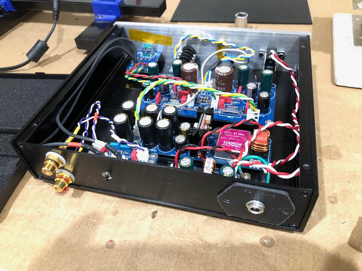

So after gathering dust for several weeks, I finally completed my though-hole version of this awesome amp.
Dead quiet, kickass bass and excellent dynamics. DC offset is around 5mV on the left and 7mV on the right - pretty decent.
Thank you TimS and XRK!

Beautiful work BDHM! You never even said you were making one until now. 🙂
What are you using for the PSU?
I boxed mine up and it’s using the DC-DC dual rail supply with cap Mx and LDO regulators.

The bass is indeed very good, and so is everything else. It’s a fine neutral amp with some guts.

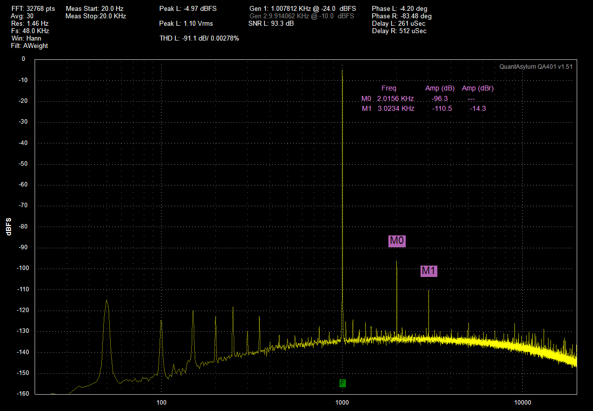

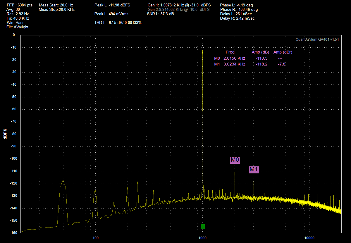

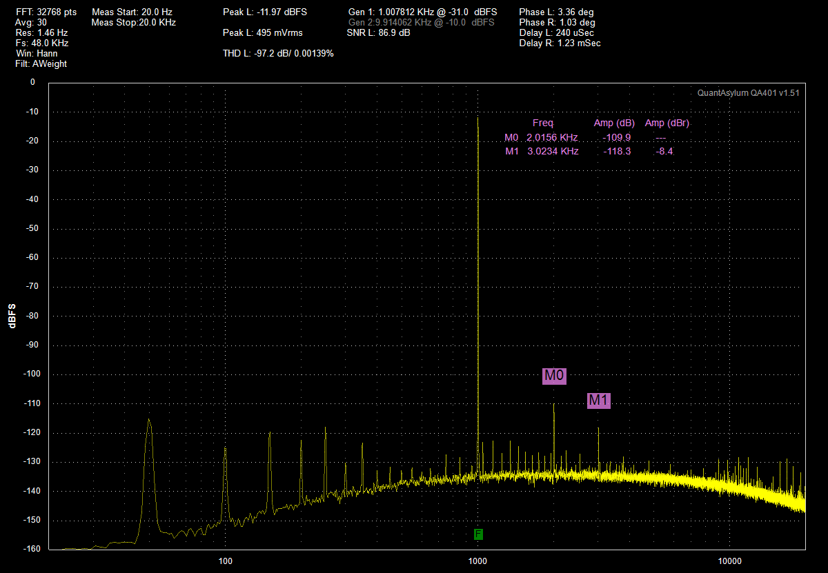

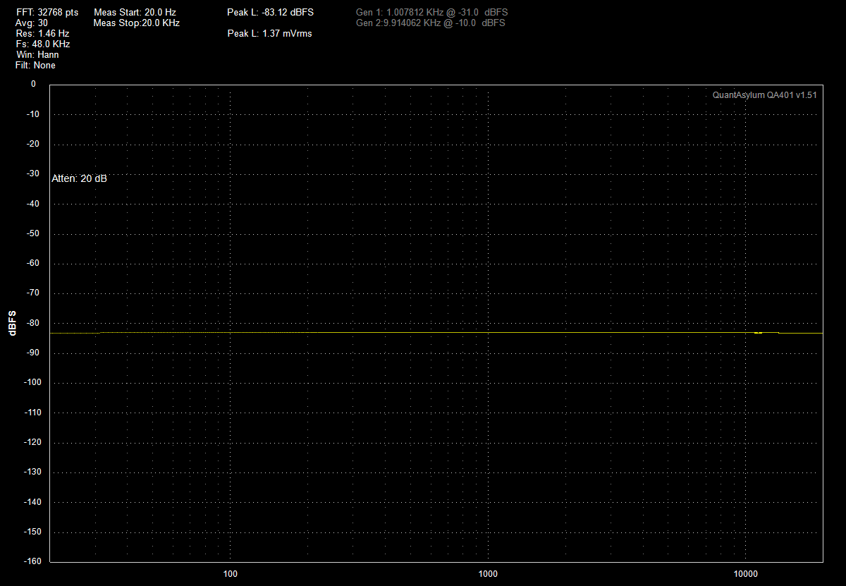

Here are the QA401 results. These were made with everything just sitting on my desk, exposed wires and all.
THD at 0.5Vrms 1kHz is 0.0013%. The others are 1.1Vrms 1kHz and frequency response. Interesting minor upsweep at high frequencies.
Note: this is for my basic through-hole version. I am certain the full-fat JPS version will be better.

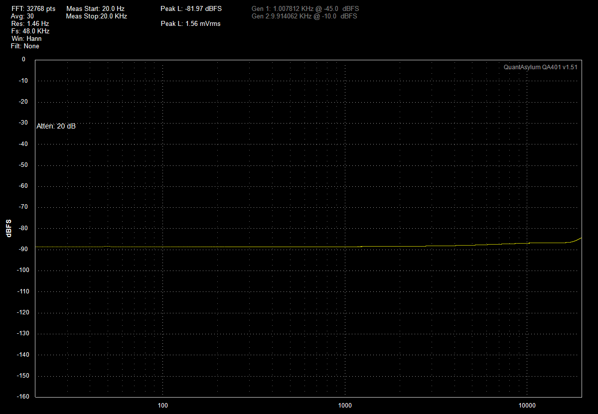

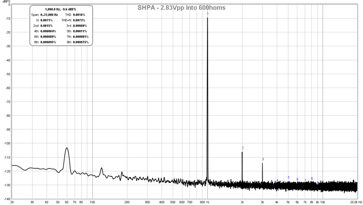

Those look good BDHM. For reference, here is the JPS64 layout driving 1Vrms into 600ohms:

What kind of measurement ADC are you using? Odd that the low frequencies drop below noise floor of -130dB (same on both our setups). I find that DC coupled amps have a rise in the low bass due to lack of a high pass input coupling filter that would otherwise block infrasonic rumble.
Your background noise floor shape might be noise from your PSU.
Oops! I forgot to mention, the tests were done into a 32ohm load. I'll do the same tests with 600ohms later tonight.
To quote the QA401 product page: "The input stage to the AK5397 ADC consists of a relay attenuator, an OPA1612 buffer, and an OPA1632 diff amp"
Good point. I'll throw a capacitor in front of the amp and see what happens 😀
Yep. Plus fluorescent lights and nearby SMPSes.
