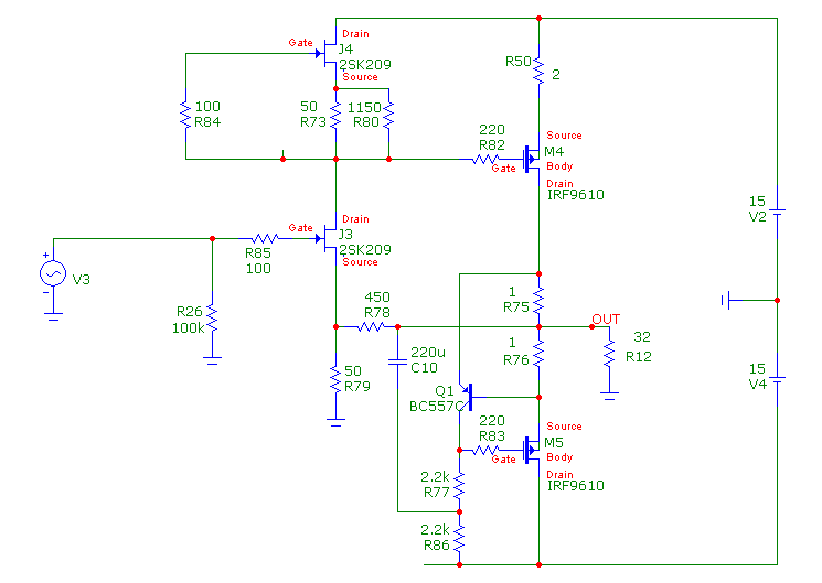

Hi Patrick
Constructive criticism is always appreciated.
1) I totally agree lateral and low Vgs MOSFETS will not work, but this still leaves a large number of devices to choose from, though it should have a low input capacitance and high transconductance.
2)This is indeed an effect but it isn't the main reason for having to trim the circuit. From testing in sim and building my prototype this effect causes an output change only in the mV's.
This could be improved by cascoding J3 and J4 , to keep there Vds's constant and equal. I am thing depletion mode mosfets but then it wouldn't be a simple circuit anymore.
The main problem, and I feel very stupid for not seeing it, the main issue is R79 going to GND!!.
In my original circuit, the setup for J4 is that it sets a bias current where the Voltage at the gate is equal the voltage at its source and through matching it is setting a bias current through J3, where the voltage at the gate is the voltage at its source and since the source it connected to the output then the voltage at the J3's gate is the voltage at the amplifiers output. If you then add a source resistor to J4 then the exact same source resistor has to be added to J3, but it can only connected to the amp output only!!
So how to we add gain? We put back R79 but we can't allow bias current to flow through it and the simplest way to do this is, I hate to say it, add a cap!! but it would still be dc coupled input to output.
We could still trim but the output offset will drift with temp and supply voltage and I am sure it kills its PSRR so I wouldn't recommend it at all.
I also sim'ed your version of the circuit (attachment 1). I increased the output bias current and added boot strapping, put matching resistors for R75 and R76. (The asymetrical resistors allowed lower static bias but additional distortion when the output current started getting high).
On the sim I was getting 0.003% distortion swinging +/- 10V output into 32R at 1kHz and then again 0.030% distortion at 10kHz. I use microcap and I am not good at ltspice and it wouldn't load your mosfet model, so I stayed with the IRF9610, but the JFET model was fine.
Attachment 2 shows how you circuit with gain should be done with an untrimmed 3mV output and a lower 0.002% distortion at 1kHz.
Cheers
Tim

Tim,
Was never meant to criticise. Just intended to add a few remarks.
And it is a clever little circuit, so many congratulations.
The distortion numbers corresponds to those of my Spice results with the lower bias and no bootstrap.
So they more of less agree.
I have no problems trimming DC in my model.
(As you can tell from the different values of the JFET source resistors).
I also think equal current sharing is better.
But it is easy to try various ratio, and only listening will tell what sounds best.
I always have a gain of 10 because I use crossfeed upfront which sttenuates the input by -10dB.
But it just sounds so much more natural.
I suggest you try the Fairchild MOSFETs.
I like them better than the IRFs in the F5-HA.
Patrick

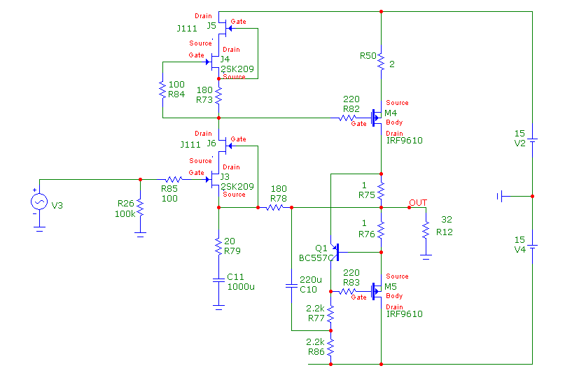

I simulated the cascode version of the 2SK209 amp with gain.
It fixes the issue with offset changing with supply voltage. It doesn't improve performace otherwise, probably the J111's own transconductance is quite low so doesn't add too much to the open loop gain.
Cheers
Tim
IMHO you should consider what addition really makes a sonic difference, instead of chasing THD numbers.
Compared to post #1, it is not so simple anymore.
Patrick

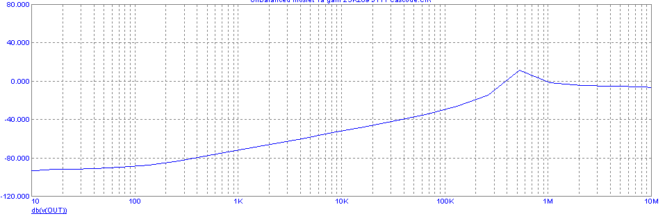

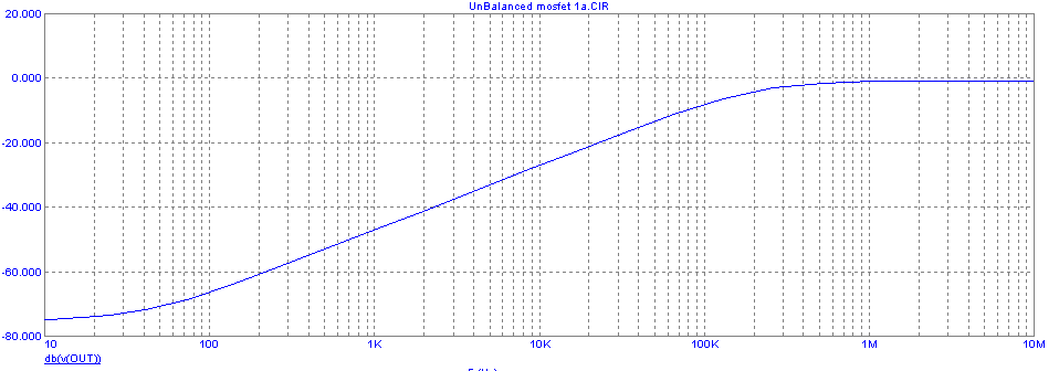

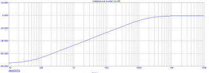

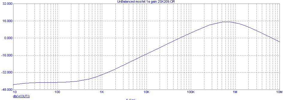

All True
As a single ended headphone amp I have stopped at my first design, but I am thinking ahead to my next designs and I wanted to see what cascoding with the J111 was like.
The advantage, of reducing the output offset variablility to the supply voltage, is improved PSRR.
The first graph is of the PSRR of the cascoded version and the second is without. The third is the PSRR of my original design which has decient PSRR.
Cheers
Tim

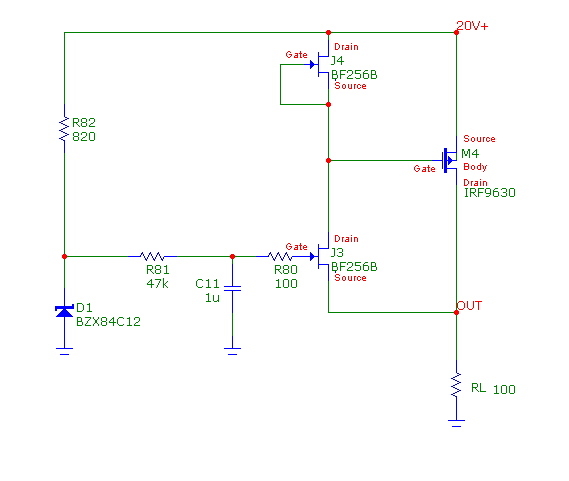

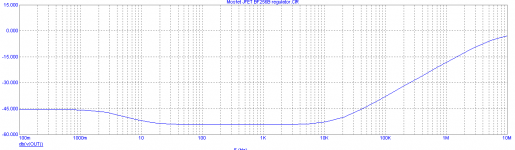

Hi TimS, I´m collecting parts to build the buffer. On post #8 You mention BF265B and BF256B says the first schematic. On post #26, BF256B, which part should I buy? Do you have a schematic for power supply? I like your project, thank you!
When JE1973 asked me about the PSU schematic, I really didn't have a plan I was running it off my lab PSU, I thought I would just suggest the usual LM317T and LM337T but then I remembered that the LM317 is noisy so I performed a little research and there are plenty of low noise designs out there.
Then I had a brain storm, this thread is about a DC coupled JFET amplifier so why don't I use it as a DC amplifier ie a voltage regulator but I would use the more available (ie I have plenty) BF265B's. I would also just use a zener as a reference but with the JFET high input impedance I could use a large resistance and high quality capacitor RC filter to get rid of its noise.
So I matched a pair of BF265B's and built a pair of the circuits below.
Measurements:
- The supply voltage needs to be about 7V higher than the output voltage, so not particularly efficient.
- The output impedance is about 0.2R. I switched from 200R to 100R loads and the output changed 10mV, so not too bad.
- The voltage difference between the zener and the output is 30mV. Since I built this circuit twice I got about the same result which I think is fine for a PSU (better than the zener voltage) and the 30mV difference doesn't change much over time.
- Noise, I couldn't measure any using my scope I might try using my sound card later to better quantify this.
Last night I was running the lab PSU through a pair of these regulators and then into my original design headphone amp. I think it sounded better, low level detail became clearer.
My theory is the output impedance and so noise stays low across the audio range compaired to my lab psu.
I don't have a suitably sized transformer so I can't check for ripple performance, but looking at the sim's the PSRR (2nd attached) is 54dB at 50/60Hz, so maybe it will need some preregulation or maybe cascoding of the JFET's, we shall see how that goes.
Cheers
Tim

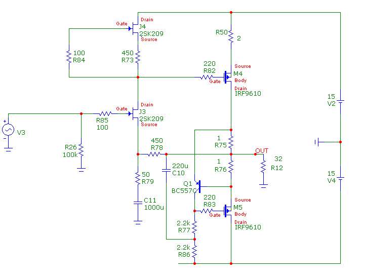

682713d1527107266-simple-performing-headphone-amp-2sk209-headphone-amp-cascode-png

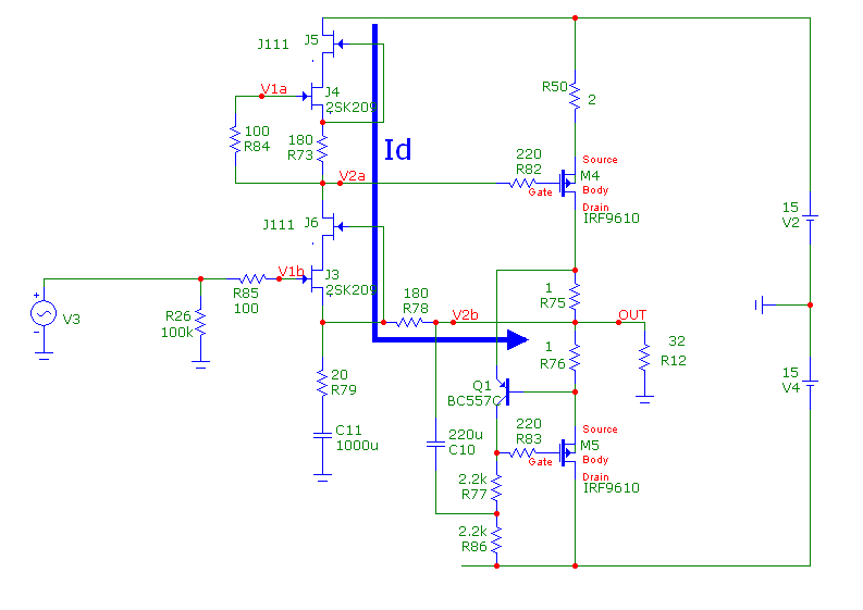

This has a -0.461v DC offset in the LTSpice sim. It works well otherwise - how do you get rid of the offset without adding an input cap and bias network on the gate of J3?
The crux of this trick is J4 and R73 setting an Id where J4's gate voltage V1a (on drawing below) is equal to the voltage at V2a, since V1a and V2a are effectively connected.
Since J3 is matched to J4 and R73 is equal to R78, and the Id is the same through both JFETs then the voltage at V2b is equal to the J3's V1b gate voltage.
This all sounds great except for one thing the Id for any Vgs varies with Vds, especially with low transconductance JFETs. This is where the cascode comes in, it keeps the JFET's Vds the same so the offset doesn't change with the supply voltage.
If you are seeing an offset then one of 3 things:
R73 is not equal R78
or J3 is not matched to J4
or R79 is connected directly to GND
If R79 is connected directly to GND (ie no C11) then the current through R78 is not equal to the current through R73. R73 should approximatly be equal to R79 in parallel with R78 with some 'trimming'. In this case the parts matching is also less critical.
Cheers
Tim
