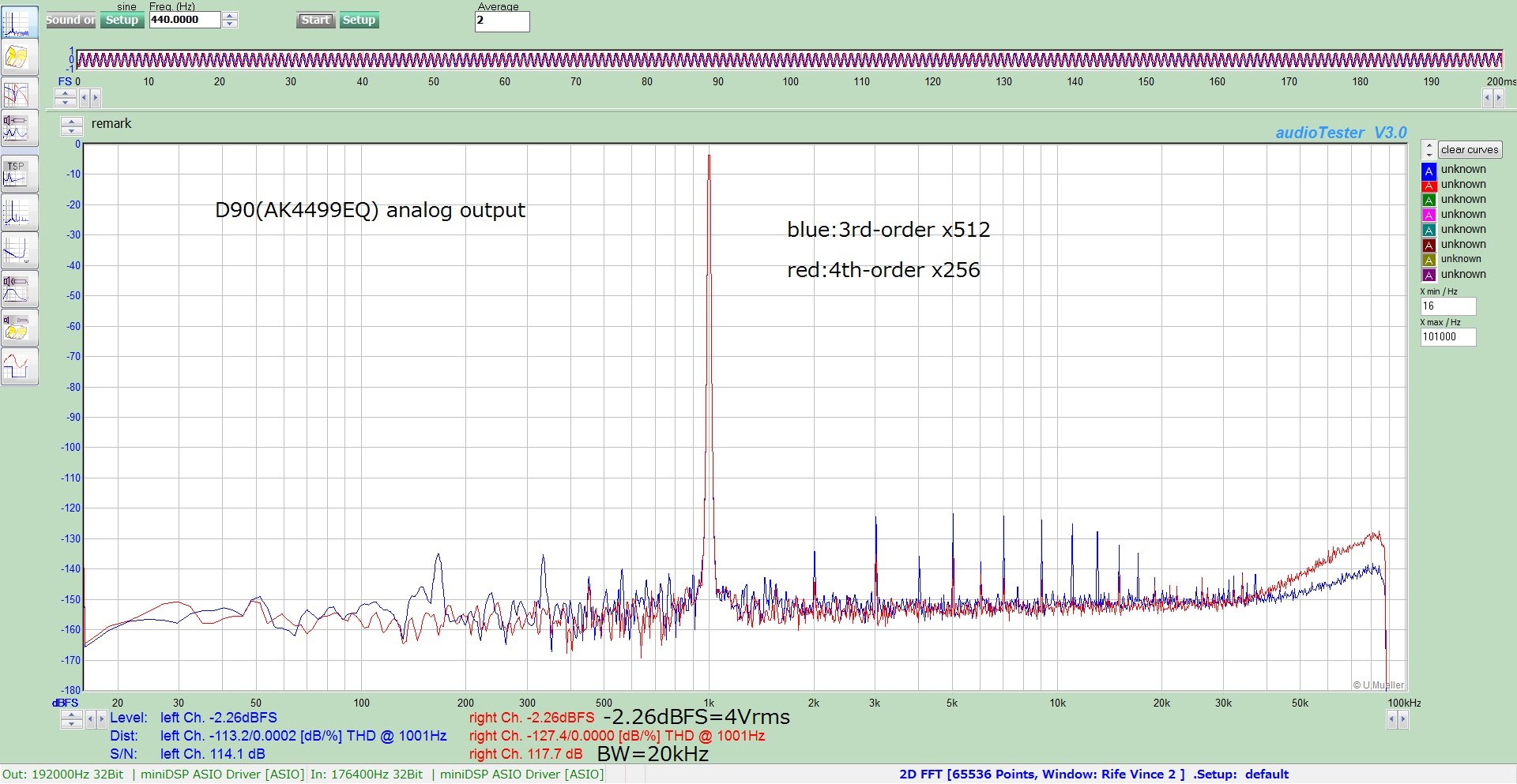

Only a limited number of DACs support DSD512, and while it doesn’t offer better numerical performance, it allows for lower modulator orders, resulting in higher maximum stable amplitude(MSA). So, I designed a DSD512(3rd-order) targeting monolithic DACs like the AK4499EQ.

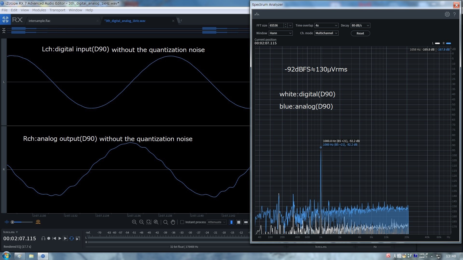

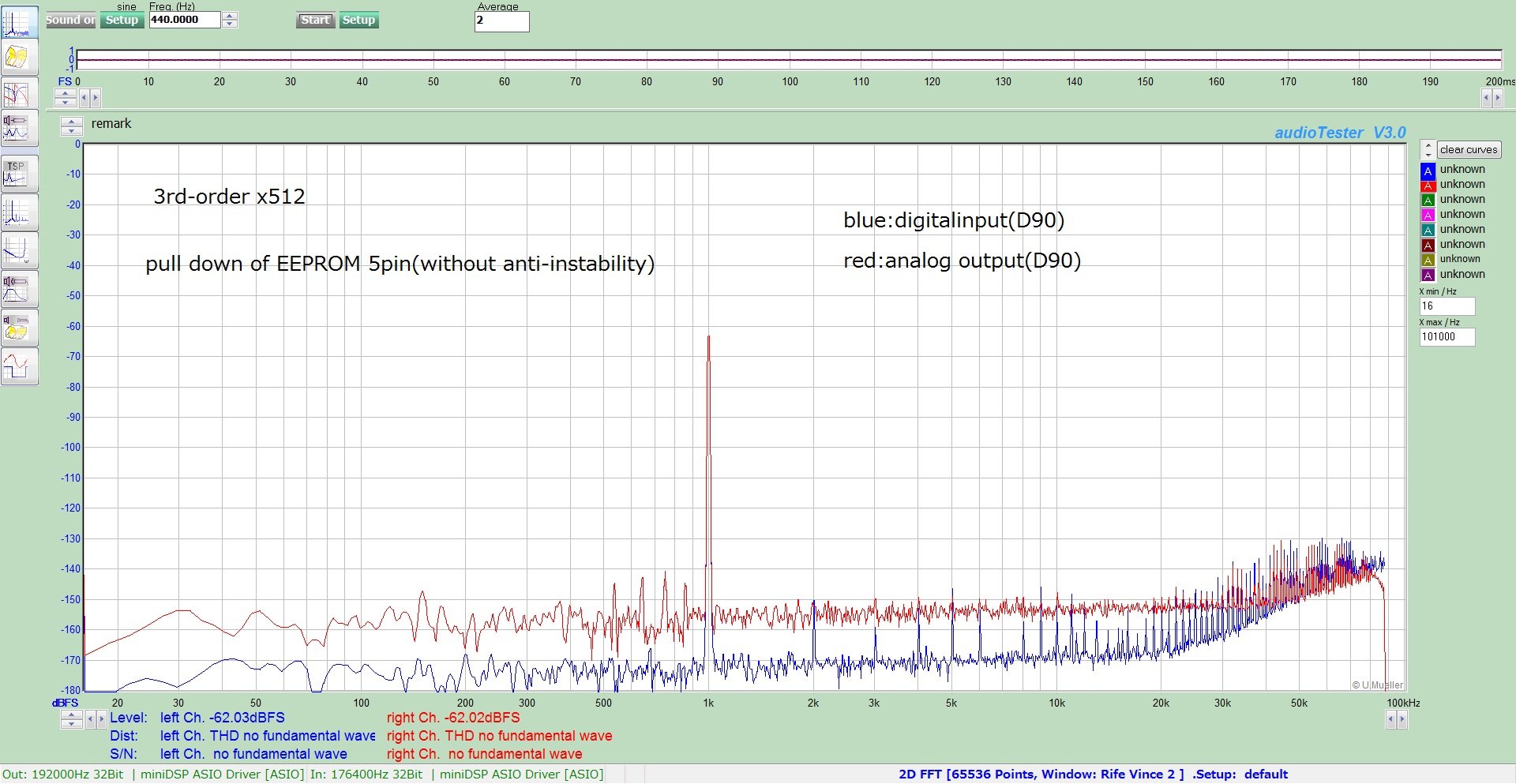

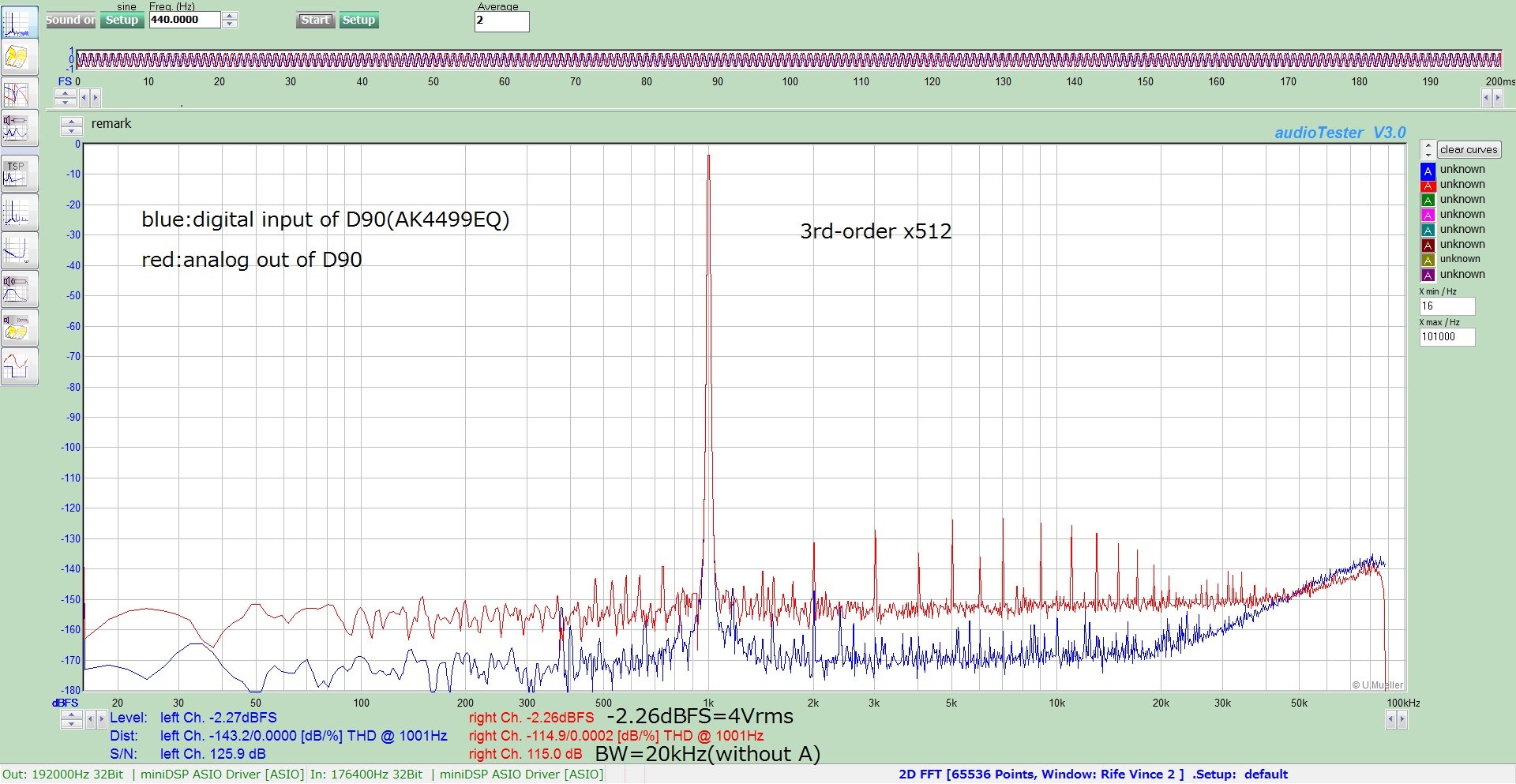

Pic 2 shows the digital and analog outputs for a 1 kHz (0 dBFS). Numerically, the digital performance is similar to DSD256, but the quantization noise is reduced. However, the analog output shows worse THD and SNR than DSD256, though still within acceptable limits. The performance of discrete DACs is uncertain.

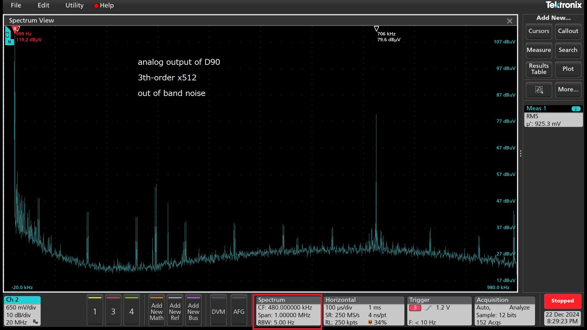

Pic 3 displays the out-of-band noise. The level of 706 kHz for stabilizing is higher than in DSD256. Using a 1.4 MHz carrier might be better. Many other spectral components originate from the D90’s SMPS; similar artifacts appear even with I2S input. Pics 4 and 5 compare the output at -90 dBFS, showing no significant difference from DSD256, though DSD128 performs noticeably worse.

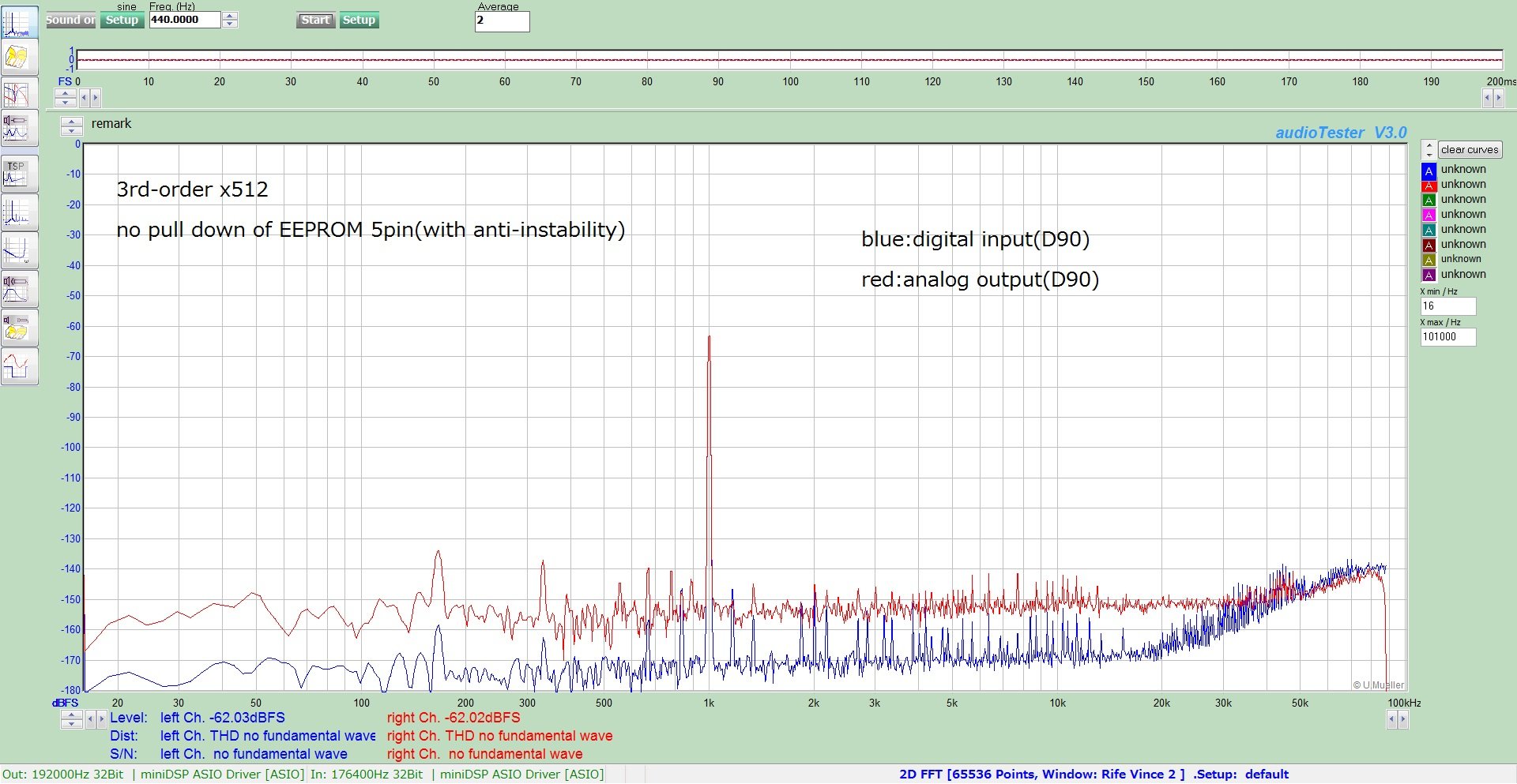

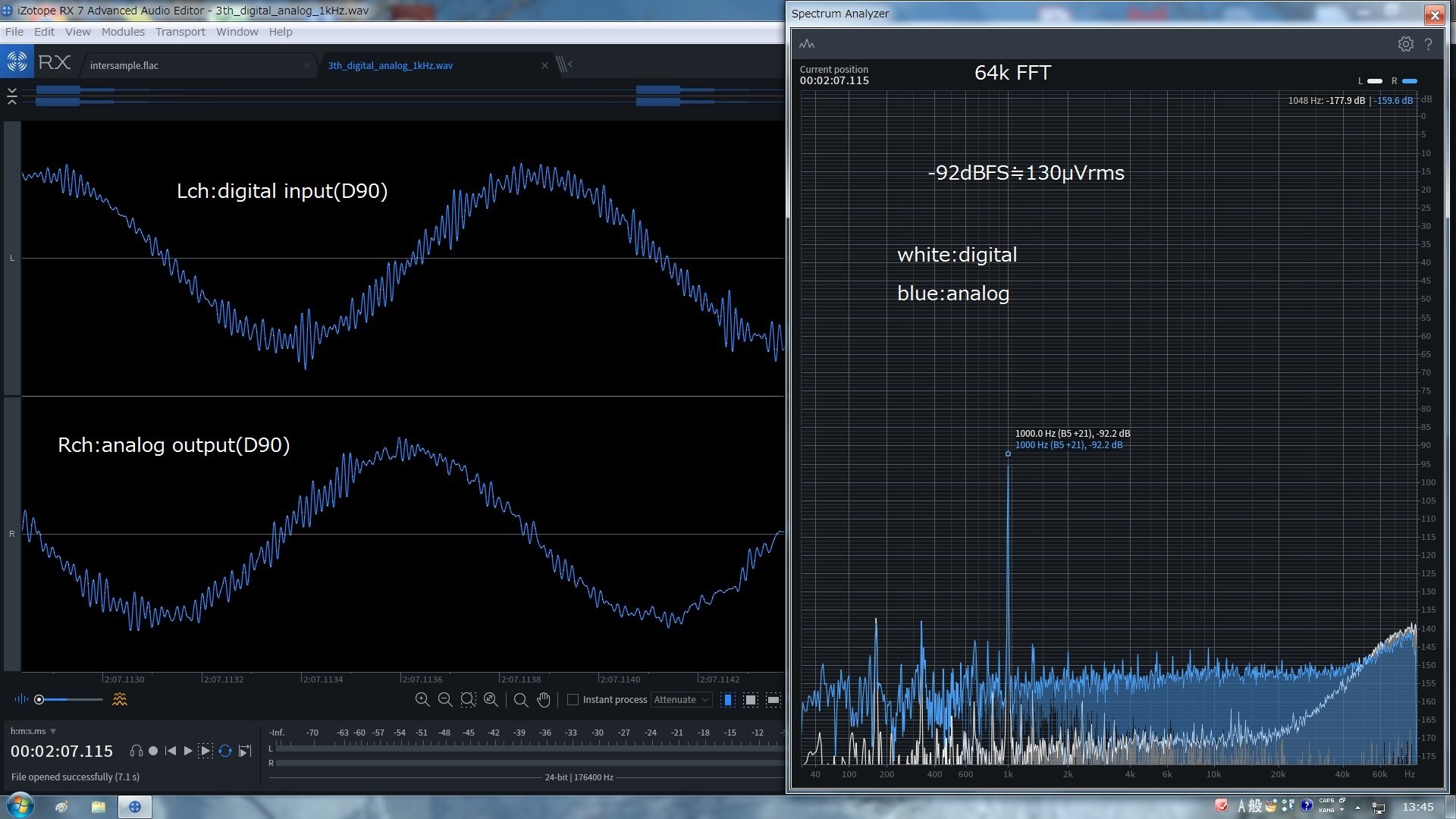

Pics 6 and 7 illustrate stability at low levels (-60 dBFS). As with DSD256, introducing a 706 kHz carrier results in sideband-like components but stabilizes the quantization noise. Without the carrier, DSD512 exhibits significant noise fluctuations at roughly one-second intervals. While these variations are likely below the perceptual threshold, avoiding large fluctuations is preferable. Distortion components increase above 20 kHz due to overlap with quantization noise, but the distortion level remains similar to lower frequencies. Pic 8 compares DSD256 (4th-order) and DSD512 (3rd-order), highlighting differences in quantization noise levels.

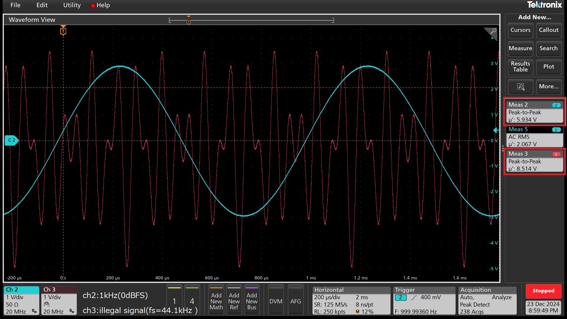

Pic 9 is interesting. The blue trace shows a 1 kHz (0 dBFS) signal with a D90 output of approximately 2 Vrms (Single End), corresponding to about 6 Vpp, which clips at this level. The red trace represents a deliberately constructed signal at 44.1 kHz sampling to produce maximum amplitude. That's why this is "illegal". Despite expectations, the D90 extends the output to 8.5 Vpp, approximately 3 dB above the clipping threshold. Both signals are PCM over USB.
Some DACs, like the Benchmark DAC3, intentionally allow a 3 dB headroom, but most DAC chips clip at 0 dBFS, resulting in significant distortion. Consequently, CDs under the "loudness wars" often clip and distort heavily. However, the D90 seems to avoid this, likely due to the AK4499EQ's characteristics. This could result in an audible improvement when playing CDs.
With DSD, the situation becomes more complex. The DSD128 (5th-order), DSD256 (4th-order), and DSD512 (3rd-order) files use a gain setting of 0 dBFS (PCM) = -6 dBFS (DSD), ensuring no clipping during oversampling.
However, the inherent MSA exists in 1-bit DSM. For DSD128 (5th-order), saturation occurs at around -5 dBFS, leaving only about 1 dB of headroom when oversampled signals exceed 0 dBFS. This means up to +1 dBFS (PCM) is safe. The limit for DSD256 (4th-order) is around +2 dBFS, while DSD512 (3rd-order) extends to approximately +3.2 dBFS. This increased headroom is a key advantage of 3rd-order, making a 5th-order DSD512 implementation nonsense.
Thus, when driving the D90 with DSD, DSD512 will likely offer the best audible performance for CDs. The numerical performance degradation is negligible, and The high MSA makes it a strong candidate. Ultimately, the choice depends on personal preference, but DSD512 is my best option.

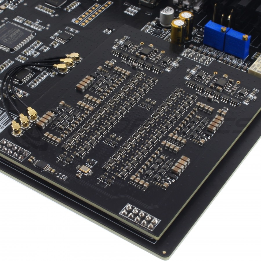

Pictures of it look pretty much like a discrete FIRDAC with a local clock:

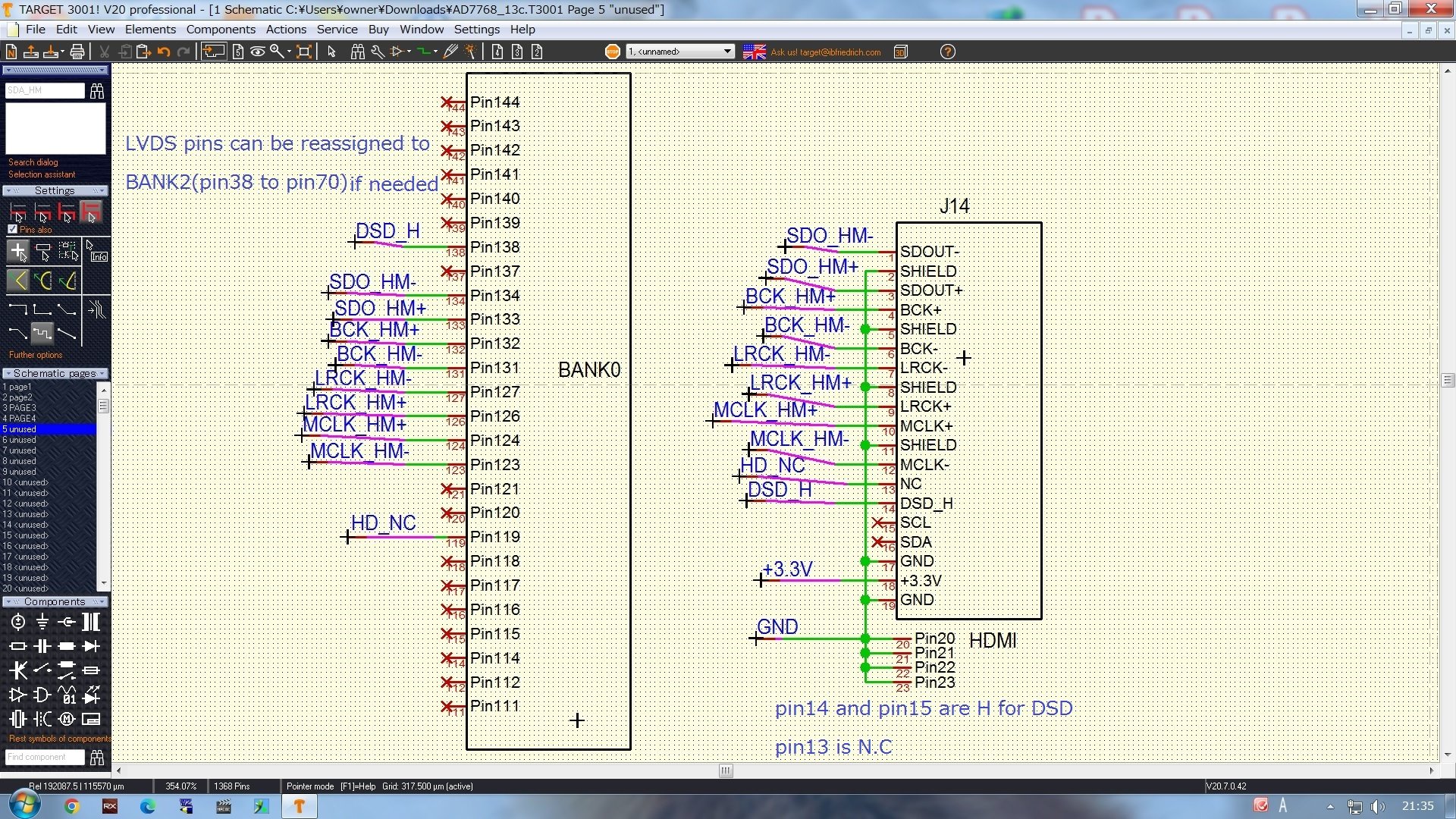

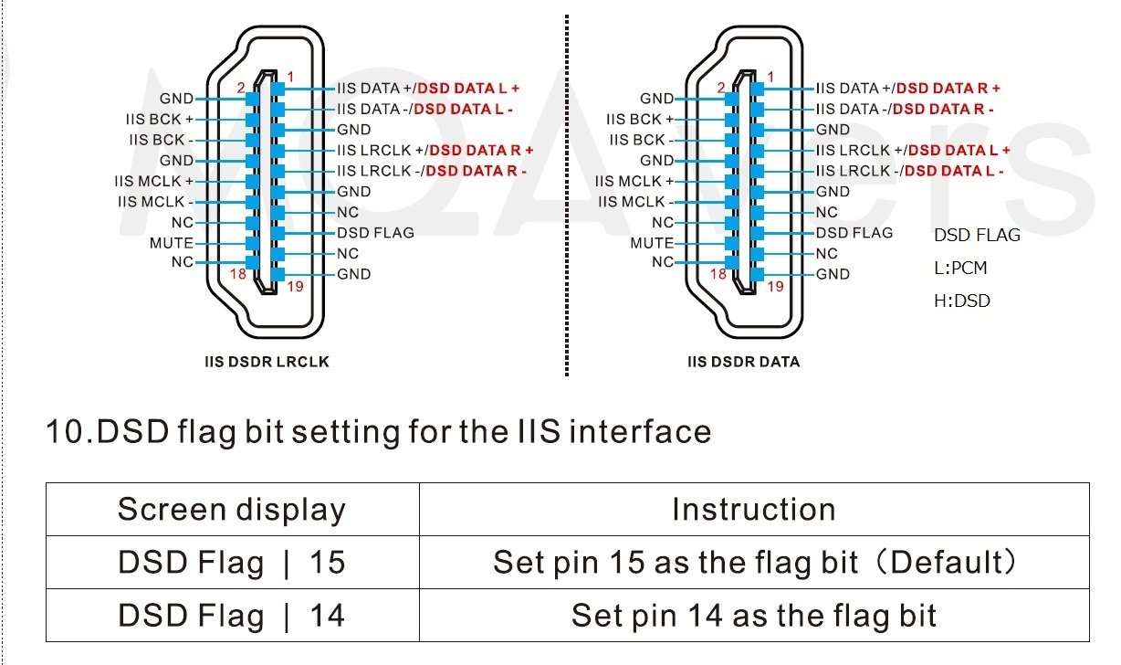

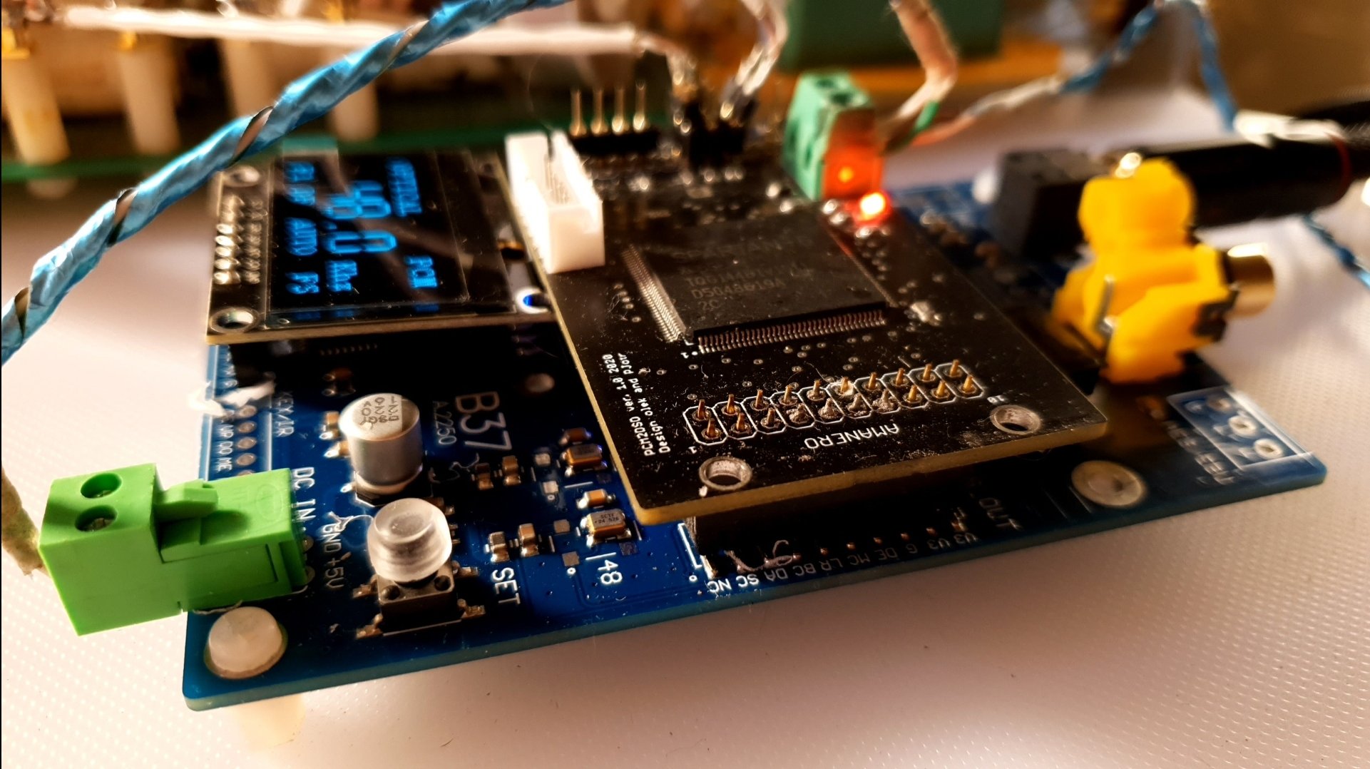

Trying to connect this processor to a FifoPiQ7 board.
Anybody has succeed on using a FifoPi? Any concealed trick?
I take I2S signal from the PCM2DSD output interface and connect those three LRCK, BCK and DATA to iancanada board J1 GPIO originally intended to connect a Rasperry Pi as input.
It is a green light under the clocks, but till now unable to suck the signal out of it.
