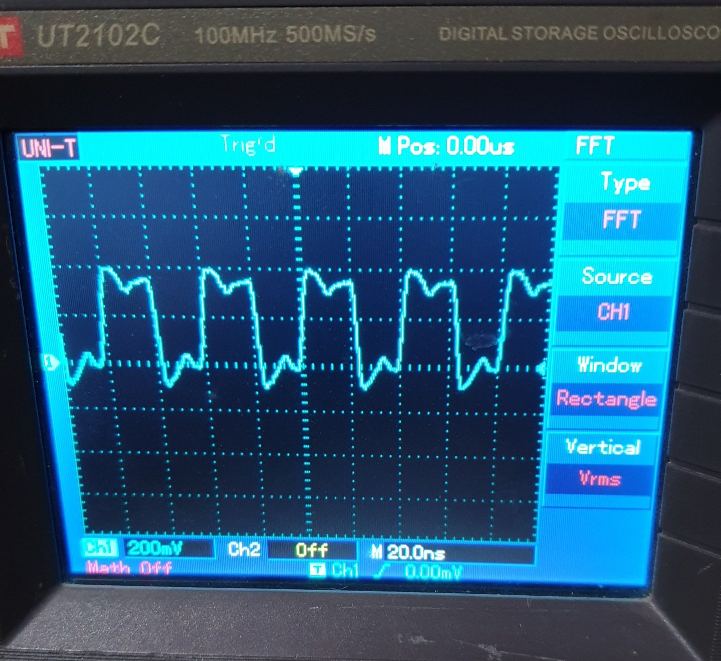

Yes sure, measured MCLK from U.FL FifoPiQ7.
