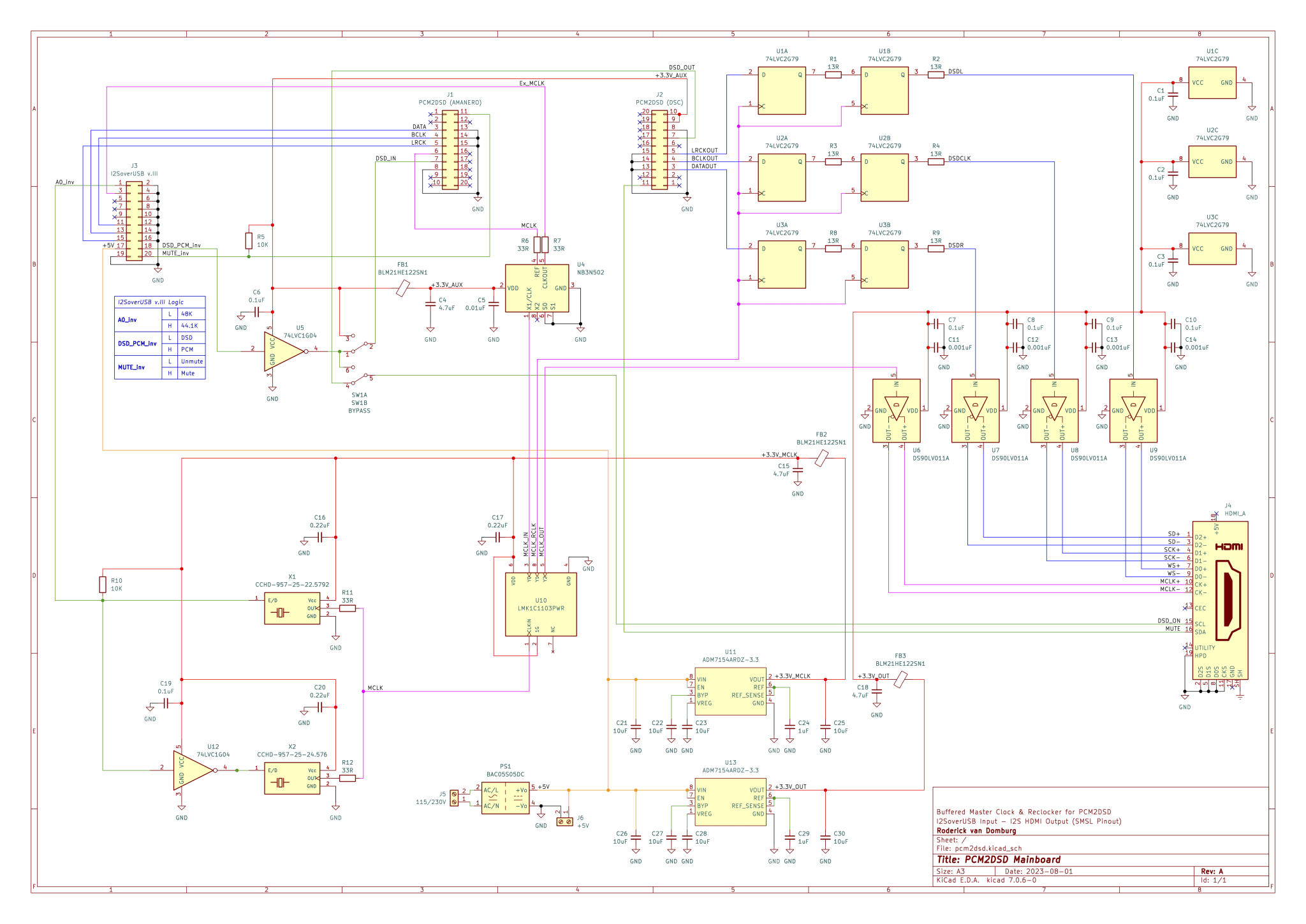

Simple DSD modulator for DSC2

Here is revision A. Changes:
  • Changed quad DS90LV031A to single DS90LV011A LVDS drivers (U6-9, C7-C14)
  • Separated power between clock and output sections with a second LDO (U13)
  • Changed LDO to ADM7154 (U11)
  • Added pi-filter for NB3N502 clock doubler (FB1)
  • Changed pi-filters to share LDO output capacitors (C25, C30)
  • Changed to ferrite beads parts with lower DC resistance (FB2-3)
  • Changed bypass capacitors in clock section to 0.22uF (C16-17, C20)
  • Added option for 230VAC/5VDC SMPS module (PS1) or supplying external +5V (J6)
I'm not completely satisfied with the pi-filters yet. Instead of having one per voltage rail, it would probably be better to have them locally and then a couple more. So, for the +3.3V_MCLK net, having one with the clock buffer and another with the VCXOs.
