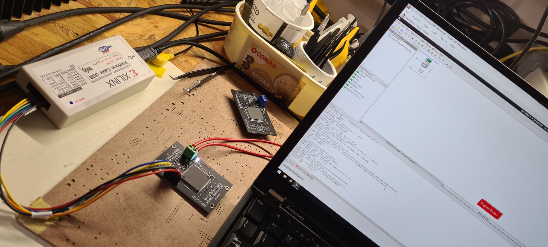

Today i have soldered and tested succesfully 2 boards.
Electrically speaking they are good to go...
but, because i still miss the serial flash needed to "store" the program i have started experimenting a bit.
I have a a couple of Macronix MX25L3206 (32Mbit) that i have bought for a bios swap on a motherboard.
I have tried anyway, they are pin-per-pin compatible.
from impact i have prepared a prom file with 32M size.
then loaded and selected an N25Q32 from the spi flash selection.
I did that because i found a paper from macronix that state they can be used with that trick.
But when i start the programming, the fpga loaded the firmware (led turned on on the board) but then it said "SPI flash not found".
i was expecting an ID mismatch...
Except i am missing something major... i guess i need to wait for the postman to ring my door 🙂

I guess there are two possibilities. One is simple but sometimes occurs; cold joint of config-related pins (TCK, TDI, .., CCLK, and DIN). I recommend you examine such pins if soldering is OK. The other is Xilinx cable will not accept your EEPROM even if you specify ignoring chip ID. If so, you may need another EEPROM that Xilinx can recognize.
If you have an EEPROM writer for a BIOS update, you can use it for writing config-EEPROM; desoldering the EEPROM, and writing it with an EEPROM writer. In such a case, an EEPROM writer requires mcs file, not bit. Which way is convenient for you?
I had more than one problem with the ISE 14.7 on VM (as released by xilinx)... skip_id_check didn't worked.
I found a way to let the 14.7 run on windows 10 x64 baremetal and here i was able to activate the env variable.
In the end i had success.
since the flash is 32Mbit, 4x the recommended 8Mbit in the BOM maybe i can multiboot with the xx3stksm version and the original one. Not sure if it possible... must check 🙂
Board flashed correctly.
Good.🙂 But you can't do multiboot from an 8Mb EEPROM because FPGA always reads data from address 0. If you want to multiboot with an SPI EEPROM, some tweak(two EEPROMs) is necessary. You need to reflash if you want to try my file.

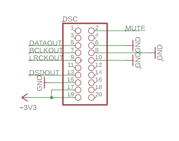

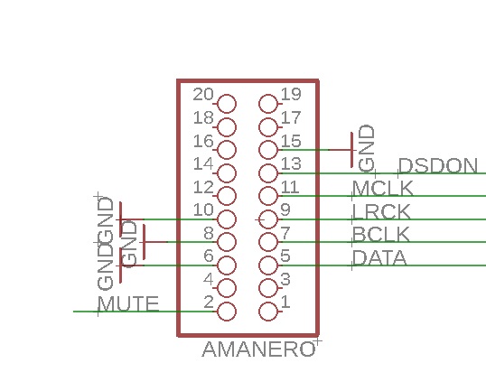

can i have a pinout of the two 2x10 connectors ?
the one labeled "amanero" and the one named "DSC"
thanks
thanks
