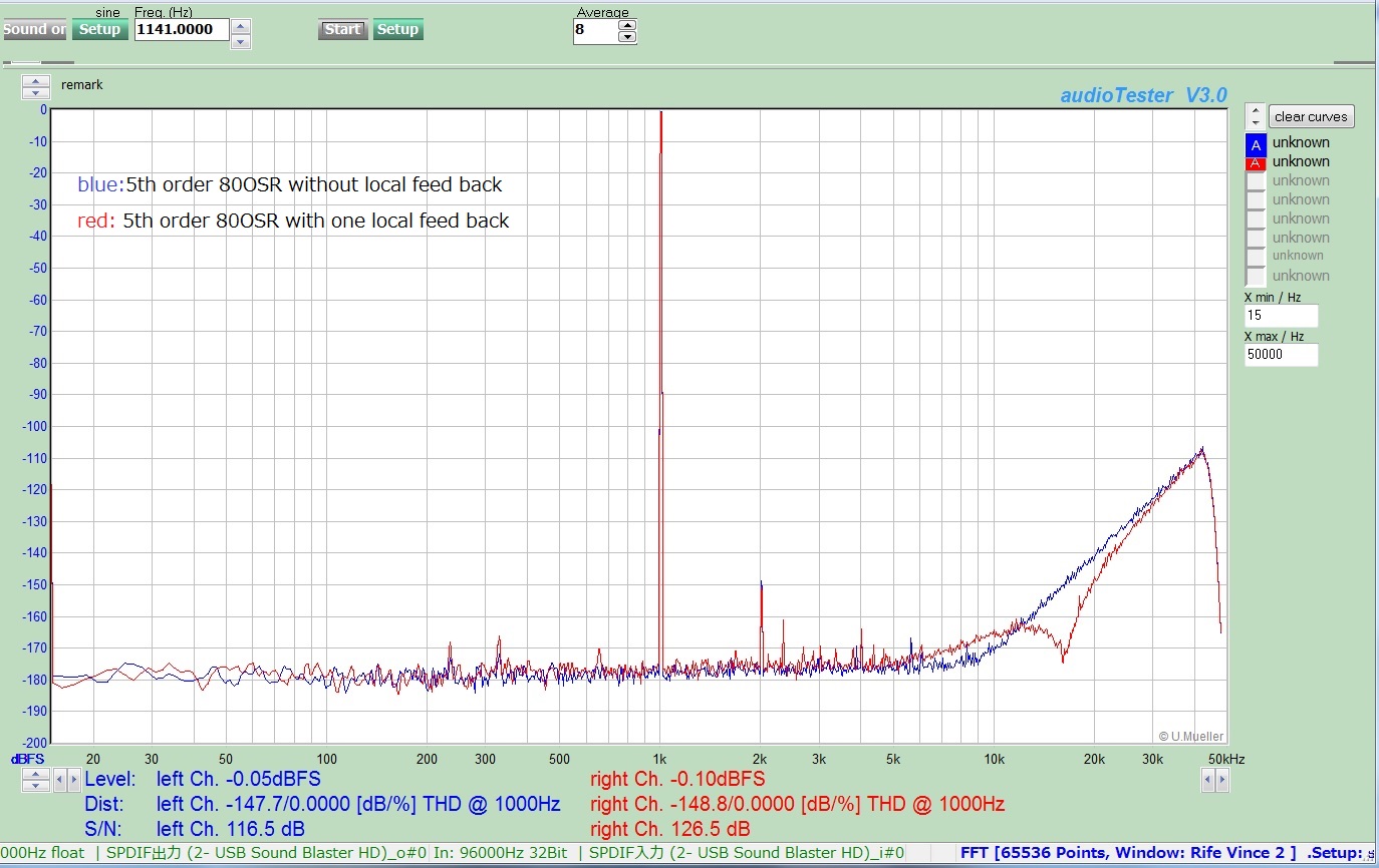

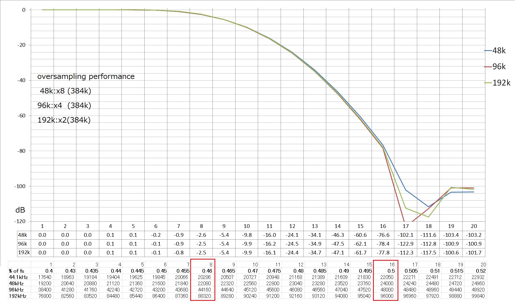

I have successfully squeezed my xc6slk25 version into xc6slx9(pic. 1). The differences between them(post#30) are an oversampling stage and two 5th order DSMs. Xc6slx9 has a half-size FIR because of time multiplexing, which results in a bit large HF droop(pic. 2). More than 0 dB(+0.1dB) doesn't mean clipping because the gain of oversampling FIR is almost -8dB; -5dB for DSM stability and -3dB anti-ISO. I guess -3dB is enough to guarantee ISO-free. One advantage of the FPGA-based preprocess is easy to implement anti-ISO logic. I'm sure ISO is a more dominating factor than clock jitter as long as I have experienced it.

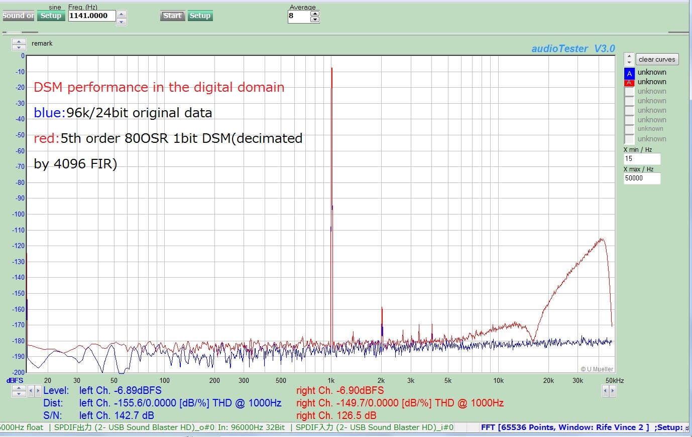

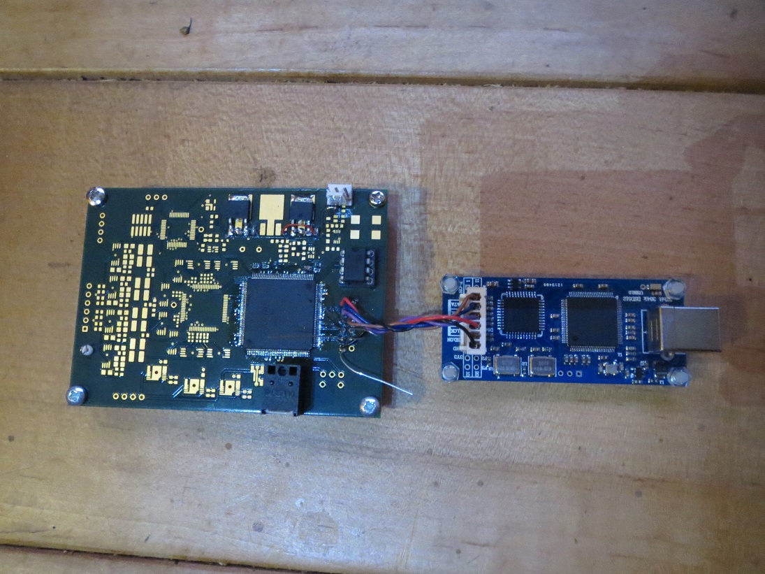

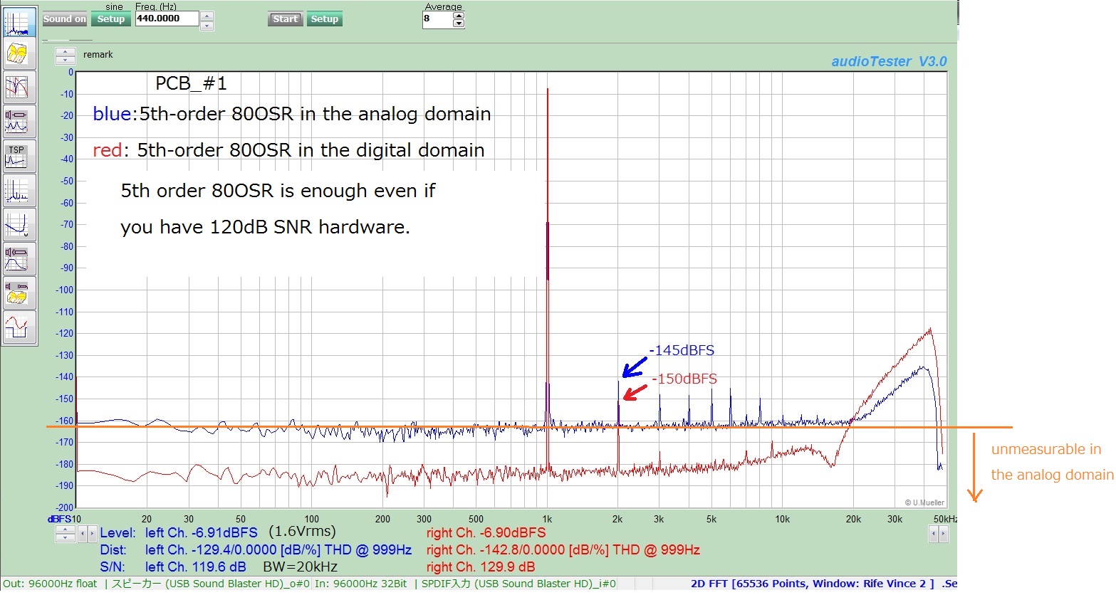

Xc6slx9 version has an option to select 160OSR or 80OSR; EEPROM 1pin=open:160OSR,EEPROM 1pin=GND:80OSR. Pic.3 is the digital domain performance of 5th order 160OSR. There is small quantization noise above 20kHz; almost no degradation. Pic.4 is 80OSR. You can see large quantization noise if you compare it with 160OSR. But what you need is the analog domain performance, not the digital. Even if you have excellent hardware(120dB SNR), 80OSR is enough in the analog domain;pic.5. High OSR means high sampling frequency, which ends up poor performance in the analog domain. I prefer 80OSR to 160OSR, though you have an option which to use.

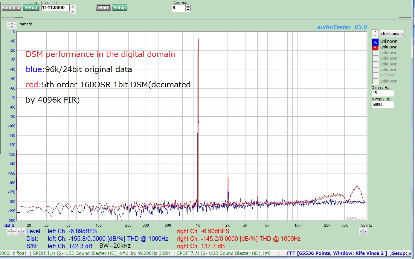

Xc6slx9 has a different pin assignment from olo111's PCB because the development was done with a spare PCB(pic.6) having an xc6slx9 footprint. It's a straightforward process to change the pin assignment when his PCB is ready. Then, I will post the final version.
