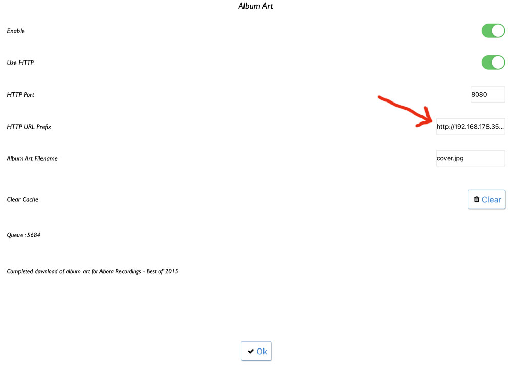

Ah, I think your cover art problem may be caused by your settings in MaximumMPD -
I think the "HTTP URL Prefix" field should be blank, or just
Code:
If I do so nothing happened, no acvtivities: Queue=0, Status=completed. If I take back the setting to NAS-URL. MaxMPD starts processing the queue ... even if it seems pointless.
