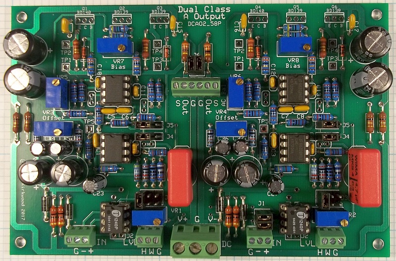

After selling out of the original run of boards I added features. I kept the original biasing scheme, added gain, added the option of overall NFB for outputs >>100mW and "0Ω" (40mΩ) Rout, and sprinkled in more jumpers.
The result is this:
Dual Class-A "DCAO2" Headphone and Line Amplifier Schematic
Dual Class-A II, DCAO2, Headphone and Line Amplifier PC Board
More information can be found here: Pro Audio Design Forum • View topic - Dual Class-A II Line and Headphone Output Board Documents and here: Dual Class-A II Line Output and Headphone Amplifier

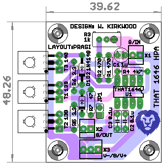

I posted your schematic in another thread, and Prasi was kind enough to do the layout:
641084d1508438947-esp-hpa-ha-r1-sch-png
Here is the layout he made:
641085d1508438947-esp-hpa-that1646-r1-png

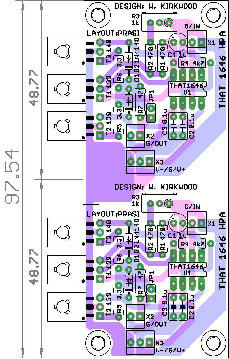

The stereo version is here:
http://www.diyaudio.com/forums/solid-state/310732-esp-hpa-5.html#post5218559
There is even a version that looks more integrated to avoid some PCB fab houses that think you are trying to make 2 boards for the price of one:
642674d1509207423-esp-hpa-that1646-r1-2-pcb-png
Gerbers here.

Thank you for the update and the really cool layout. Prasi did a great job. I appreciate the design credit on the layout.

For those that needed higher power and sub-Ohm output impedance I replaced it with this one: Dual Class-A II Line Output and Headphone Amplifier
This is the current board minus output transistors:
Though not as simple as the original it's the same topology as the THAT1646 driver (with the THAT1646 replaced by LME49720s) and has either class-A open loop, class-A closed loop and class-A/B closed loop at Pout >100 mW. It's able to produce several watts for difficult-to-drive 'phones.
For those interested in the design you can follow it here: Dual Class-A II Line and Headphone Output Board Documents - Pro Audio Design Forum

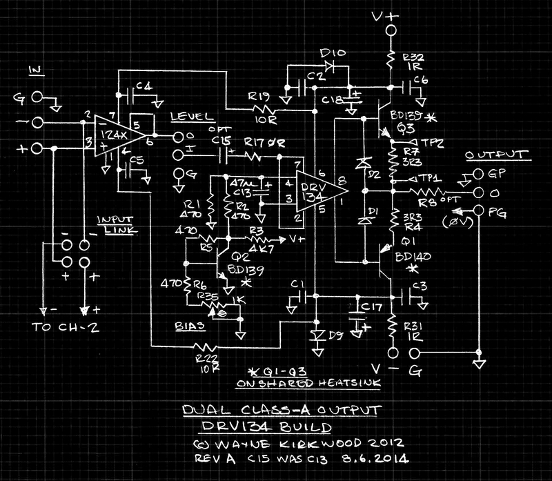

Thought it would be a good idea to revisit using a DRV134 instead of a THAT1646.
When using a DRV134 a voltage divider needs to be added to the Vbe multipler.
The THAT1646 has a gain of "2" through it's differential input; the DRV134 a gain of "4." (In Line Driver applications the parts operate similarly.)
Here is the DRV134 schematic that shows the addition of R1 and R2. When using a THAT1646 R1 is not installed and R2 is 0Ω.
Dual Class-A Output schematic using a Current-boosted DRV134
The differential input is used for bias, if the 1646 circuit were not modified for a DRV134 the bias current for the outputs would be excessive.
I ended up using the DRV134 for later builds due to its controlled clipping behavior when using "common mode" drive through the sense pins 2 and 7.
There's a circuit description here for those interested: Dual Class-A Line and Headphone Output Board Documents - Pro Audio Design Forum

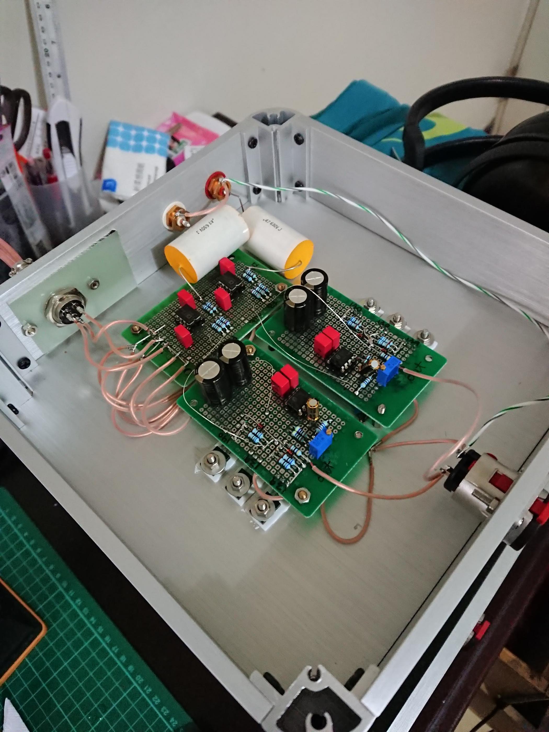

Finally, I finished the amp.
One issue emerged. I can't adjust the bias, and the THAT1646 became very hot!
What can be wrong?
Compared to the original schematic, the only difference is that I used a 4.7uF to replaced the 1uF, Is that OK?
