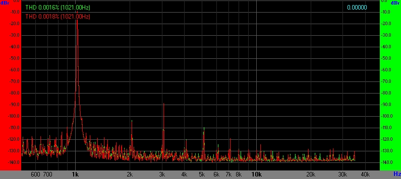

Thanks Wayne! It’s WIP. I’ve been learning TinaTI and wanted to sim your circuit.Nice!
Where is the third transistor/Vbe multiplier? I see the "bias" port on the sch but no circuit.
You don't really need a servo in this circuit. The output Vos is low - it's the sum of the 1646 output offsets plus 1/2 the Vbe difference of the NPN/PNP output pairs. Typically its under 5 mV.
I would remove C2 and C8.
Noted about the servo, thanks! I’ll happily send you a board and source files once completed and tested.

Where is the third transistor/Vbe multiplier? It provides thermal feedback. I see the "bias" port on the sch but no circuit.

The 47 uF across the Vbe multiplier provides start-up delay.
How do you propose to heatsink all those SMT output transistors?
Thanks!The 47 uF across the Vbe multiplier provides start-up delay.
Lots of 0.15mm vias to 4 layers and a pool of potting compound… hopefully
