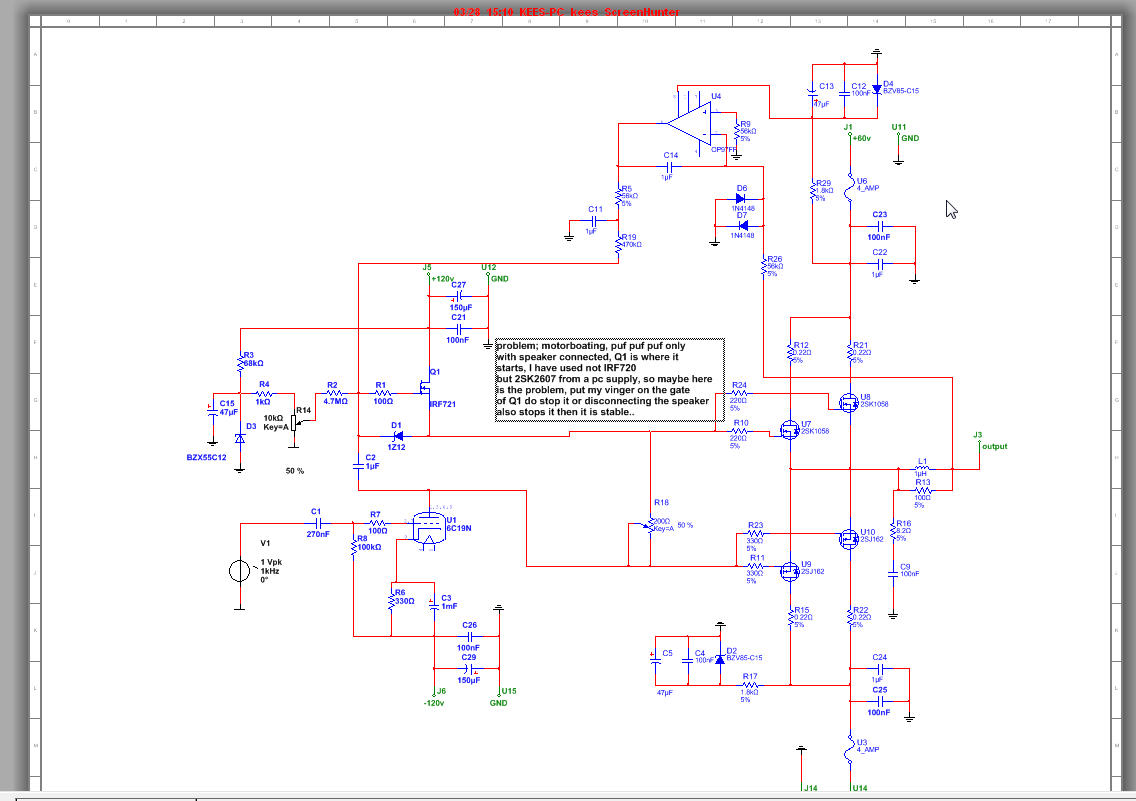

My design of a hybrid with a mu stage and mosfets dc coupled did not work well, if I connect the speakers it go puf puf puf, (motorboating) if not connected with a scoop it shows 100 volts PP without clipping, so I have to see the supply, I have make the transformer myself, maybe somewhere coupling, I have isolated the windings.
on a simulation it works perfectly, even witn a difficult load, there is some feedback on the supply if motorboating..

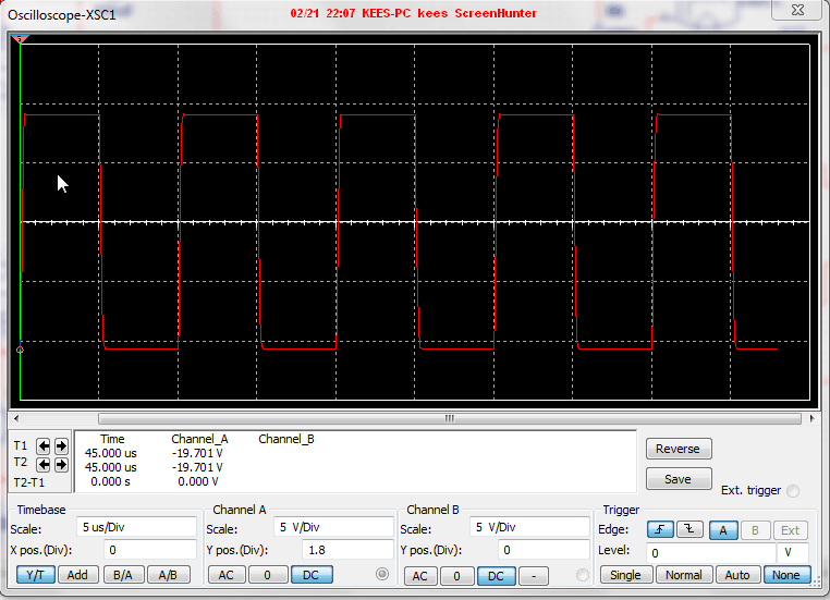

I still have a little problem. The offset voltage at the output is not constant. It moved slowly from about 5 mV to 50 mV.
Either I regulate it active, or I disconnect the DC in the feedback with capacitors. (100µF 😡 )
The bias is now relatively stable and the transient response of the square wave is also solved.
Here are some pictures:
1. 10kHz/ +/-10V/8ohm
2. 10kHz/ +/-10V/8ohm + 1µF
3 1kHz sinus clipping at +/-36V

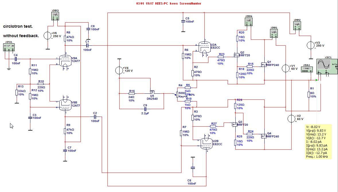

Afcourse this don,t belong here, it is not a circlotron but a part of a new project what I have put here but must be a other place, so ignore it please.

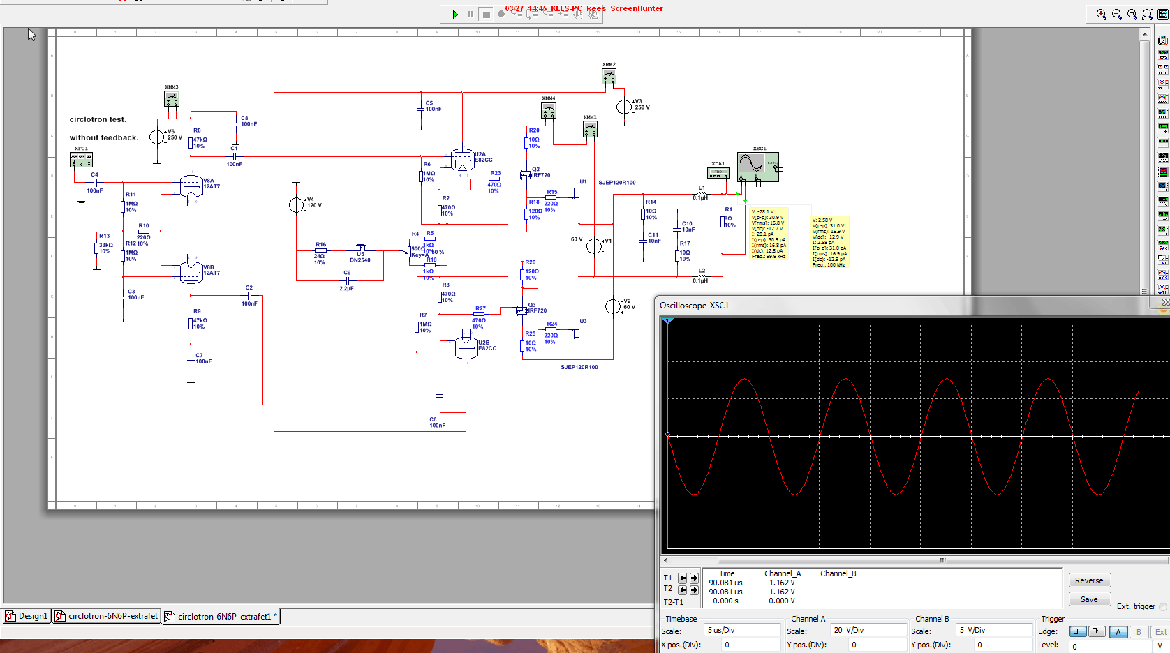

this is what I did mean, see pictures what is a circlotron but not yet tested. I am happy now to be ready with a lab supply who have al the voltages I need, now just a case around it and ready.
see pictures of the circlotron, who already was here I believe.
but the motorboating hybride who has no cathodefollowers anymore was fun, puf puf puf, bradly resistors in the supple where the cause of it (to high impedance.
Your qour questions about Q1 it is a mustage who drives the gates, the source resistors are in my project in the source and not in the drain, it is because the schematic was already drawn that way, to let see why it did motorboated, but I like fishing so the motorboad works. the amp works now faulty resistors in supply.

This was a coincidence. I was playing with LT-spice to find the final frequency compensation. I started with the millercompensation, these are the capacitors at the VAS-mosfets (C1, C2 in latest circuit). The frequency response looked pretty good with 220pF in the simulation, so I try to make a simulation with a square signal. At the output were clean edges of the signals 🙂
Then I tried to limit the frequency response with a capacitor (C3 in circuit #38)
There appeared suddenly my transient... 😎 caught it.
