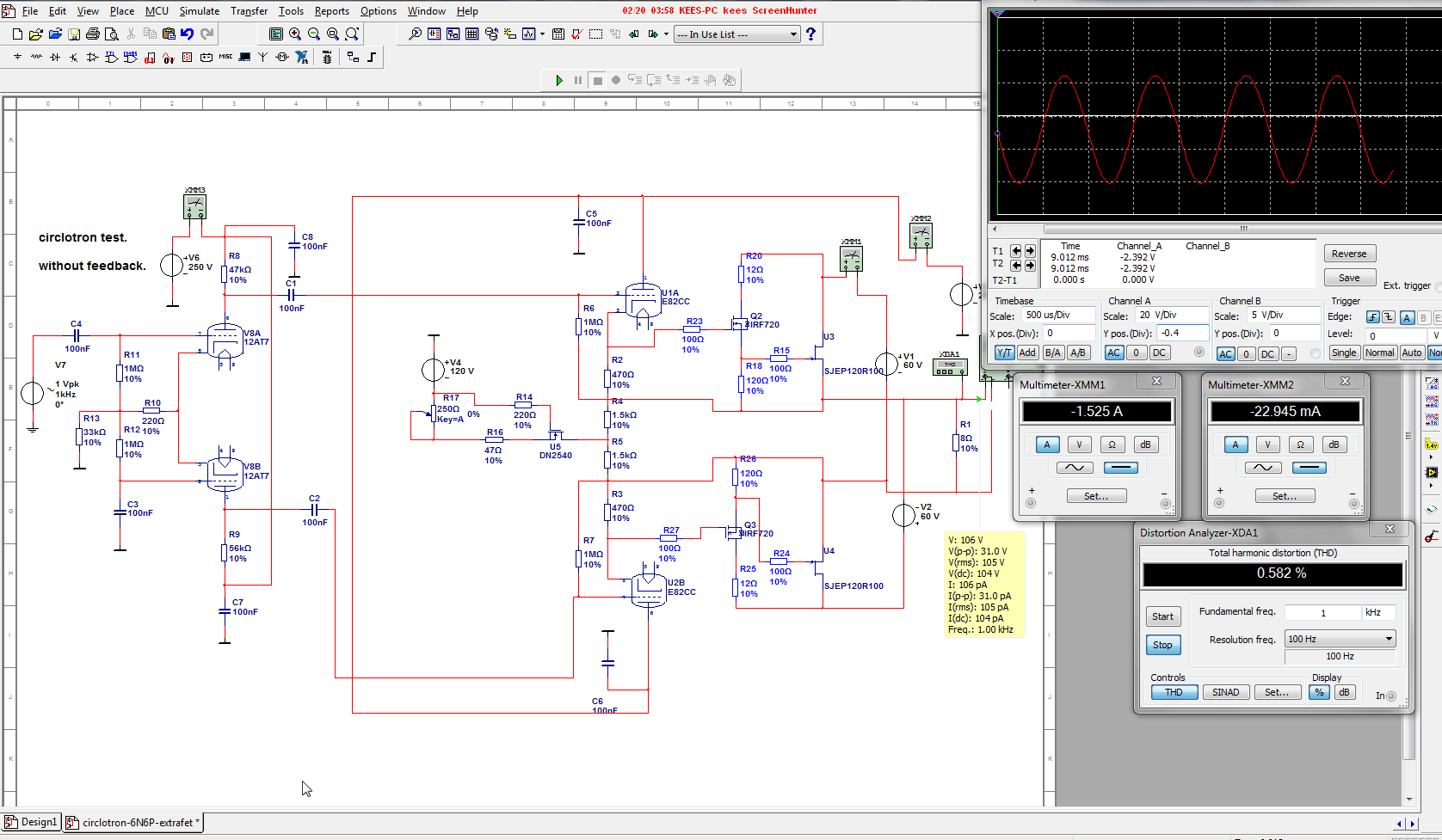

Nice work, I have done a hybrid circlotron in multisim, a time ago, I have made time to go als for a version who have allfet.
Change just mosfet for the semisouth one, distortion dropped in circlotron to 0.5 procent from 1.6 procent with the 2sk1058
goodluck, very nice design you have.
