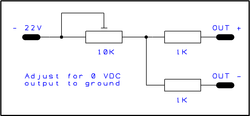

Yes you're right and good that you say that.Yes, but let's be clear that what you are adjusting is the relative DC offset across the output terminals. There is still absolute DC offset voltage between each output and ground due to the front end return current through the 1K resistors. You don't have to correct it, but prospective builders should understand it so they know how the circuit will normally behave.

If you want, you can probably get rid of the "pop" at turn-on by removing all DC offset from the circuit as discussed earlier.
Also, I don't know if this will be a problem, but if your power transformers pass any common-mode noise, you may see it from each output terminal to ground. If so, a common mode line filter at the AC power input may help.

I have the opamp in suspicion. 😡 I will test it tomorrow...If you want, you can probably get rid of the "pop" at turn-on by removing all DC offset from the circuit as discussed earlier.
No, not yet, but i will eye it.Also, I don't know if this will be a problem, but if your power transformers pass any common-mode noise, you may see it from each output terminal to ground. If so, a common mode line filter at the AC power input may help.

Hi Joe,
I've tested your circuit and it works. Unfortunately, the voltage is not very stable and wobbles around zero volts. I have just reduced the values of the resistors (R5, 11) to 220 ohms. Now I have a stable voltage of about 0.5 volts to ground.
The offset on the speaker is 40mV. (The first stage is not matched.)
But that changed nothing against the popping.
After I disconnect the supply from the driver the Amp switches on with silent. I will put in a soft start for the driver-supply like juma said.

Hi moschfet,
Thanks for the feedback. The circuit may work better with a current source in place of the pot, but is probably not worth pursuing if it doesn't help. I hope the soft-start on the driver solves the problem.
