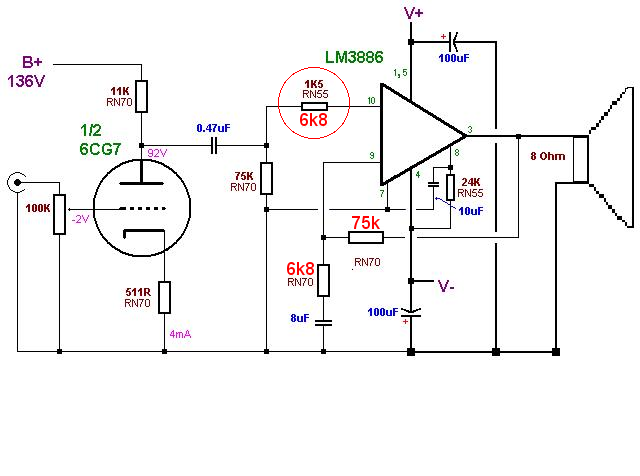

What is the minimum gain that a 3886 likes in its circuit? That is why I left those values blank.
The minimum gain has to be 10 or bigger, according to the datasheet. I would use the tube as cathode follower and let the LM do the job.
daniel, for that circuit I would do it like in the image attached. The NFB cap has a reactance of 1mOhm at 20Hz, so it's big enough. The gain will be in this case
12 (21dB).
daniel, for that circuit I would do it like in the image attached. The NFB cap has a reactance of 1mOhm at 20Hz, so it's big enough. The gain will be in this case 12 (21dB).
Thank you!! This appears to be a non-inverting LM3886. Is that correct?

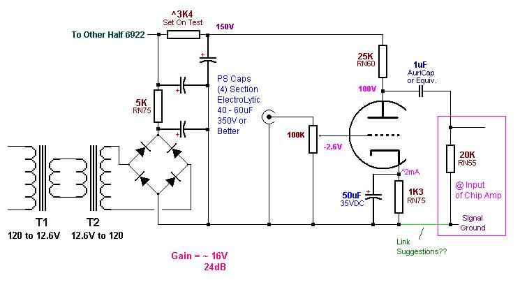

Two points
#1. Cathode Follower is less than Unity Gain, which means we need to use ALL of the available gain the Chip would have UNLESS
a: we use TWO tubes a Gain Stage and the follower.
or
b: No follower just a simple Resistance Coupled amp as drawn with some compromises on the gain.
2: In the tube world I tend to shy away from regulated supplies, in this case it is not really an issue because of the low currents needed, a Zener String could do it, or a Vacuum tube regulator can be used. The regulator tubes look real cool because they burn off the extra voltage as a "glow" inside the tube. They are really NOISY.
Lets all "AGREE" on the overall topology. Here's my .02 cents.
Inverting Chip amp with a gain somewhere around the 10 area? What would be "ideal" there maybe 12-15?
I say Inverting because the tube inverts the signal so we end up with an "in phase" output matching the output of the sound card.
If you are looking for an overall gain of 50 or so then we use the 6922, I prefer less gain because we end up amplifiying all the noise also. I will use a 6CG7 (that is my bottle head preference) but will help this project allong with the 6DJ8/6922/ECC88 specs since those are typical audiophile tubes.
I suggest that we use the simplest form of the tube amp. NO Solid State devices as CCS or anything, just a tube and four resistors. (one of which is "shared" with the chip)
I am also going to go out on a limb and specify we use about 110-120AC rectified to about 150DC for the plate supply. Any higher and we need large Plate/Load resistors and get more unwanted gain. I will draw up a 6922 Schematic with a simple Power Supply, you SOLID STATE gurus draw me up the power amp section with an imput impedance of 20K.

20k? The tube and the chipamp don't share a common ground. They only share a signal ground. Inverting or non-inverting doesn't seem important as long as we avoid putting voltage into the amplifier enclosure. The 0.47uF decoupler in the schematic makes it easy. Given that, correcting the inverted signal is as easy as switching the leads. In that case, the front page of National Semiconductor's LM3886 datasheet and the chipamp.com kit will all work at 20k (they are at 20k already).
12 (21dB).
At a gain of 10 (+20dB) the amp is just stable.
At a gain of 12 (+21.6dB) it is slightly improved, but the phase margin is still low.
At a gain of 20(+26dB) the phase margin is getting better.
At a gain of 30 (+29.5dB) the phase margin is ~80 to 85degrees.
Many listeners report that the 3886 sounds good when the gain is around 26 to 30 times. I suspect it's due to the improved phase margin avoiding overshoot on fast transients.

Let's START with something, so here is a 6922/6DJ8 input section.
Needs only a VERY small amount of current 2ma/channel.
100K input impedance should go well with the Sound Card output?
Resistor and cap values in the PS will need to be tailored to whatever transformers/mains voltage you might have.
