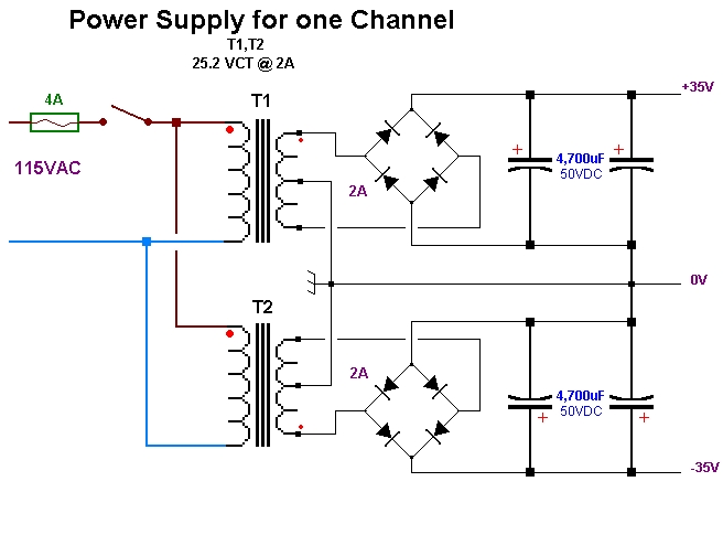

The suggested PS for a stereo amp into 8 ohms is a 25V 300VA tranny.
I am thinking that four 50-60VA trannies with sufficient capacitance would work? One tranny for each Pos. & Neg. supply per channel?
A quick PS schematic is attached.

ooh,
The PSU schematic doesn't look right.
Should the CT's be left out altogether? This is what I was thinking originally.
The trannies are actually 25.2VCT @ 2A so that is 50VA?
So 100VA with 2 trannies per Channel.

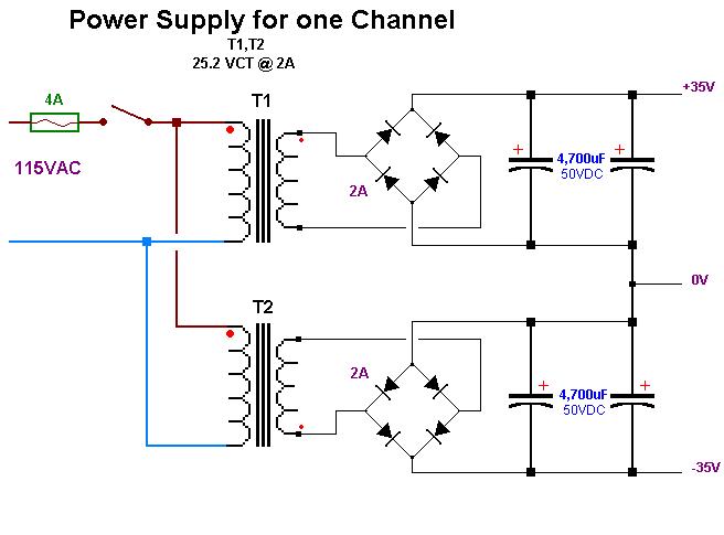

You have to forgive me because I rarely work with Bridges and dual supply circuits, all my other stuff is TUBEs and I work from B+ to ground using Full Wave tube rectifiers.
As re-drawn it should be OK?

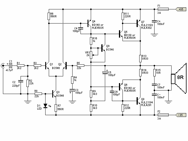

I revised the schematic on that project removing the bridging and SIM optional components.
Couple of questions
#1 Feedback resistors and caps are they R5,R4 and C3??
These determine overall gain and LF cutoff correct?
#2 How to increase Input Impedance (to about 50K min) and assuming I have no DC from the source and the source is cap coupled to prevent DC back into it can I remove C1? and what is the purpose of C2?
#3 Notes say that C4 determines HF responce this will be a SUB amp so what components determine that POLE so I can lower it?

How did you go from P2P chipamp to ESP 3A?? And why?![]()
Hi MJ!
Methinks he wants high-current design like his tube amp.
As to function, my only guess is that maybe the discrete design will make for an easier time with a unified volume control, since the discrete design is easier to mod because it isn't sealed inside a chip.

Power supply looks correct (oops, bottom bridge is upside down!) .
Input impedance: Change R2 to ~50K, change R5 to match and adjust R4 to get the same ratio (22:1). C2 is part of the input low pass filter, it's a good idea to maintain this.
Lower C4 (NO!) or lower the HF response?

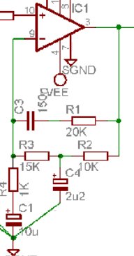

Actually I have a better question: is that a passive or an active filter?
They are passive filters. Those designs really do need a unity stable quad op amp as a buffer instead of too-much reliance on those resistor mixers.
Now, THIS is an active filter (photo):
