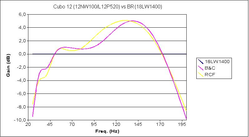

The claim that it has greater output than an 18" BR box, for example. That will have to be some pretty cheap 18" driver in that case. And what size is the box?
I have not come across a proper FR measurement for a Cubo 12 at 2.83V, just "comparison charts". All the HornResp attempts I've seen at modeling it are flawed (not surprising, as I don't think it can be modeled accurately using Hornresp), and those show a response that's more than -10dB at 50 Hz, not what I'd really consider to be a bass speaker.
In fact I think it's one of the most honest comparisons you can get. The 18Sound 18LW1400 measured in a bass reflex with a nett volume of 175 Litres (6,6 ft^3) tuned to 37 Hz vs. Cubo 12 (with all drivers measured).
Johan
Johan
Is the Cubo 12 also tuned to 37 Hz? If it's not, then the comparison is not honest.
An 18LW1400 in 175 L tuned to 37 Hz, is twice the price, twice the size and more than double the Sd of a Cubo 12 loaded with i.e. the RCF L15P520.
An 18" reflex cabinet tuned to roughly 40 Hz, is perhaps the best known and widely spread benchmark in PA. You don't have to be an expert to relate to it and know what it's capable of. All I did was create a high quality version of this benchmark, so people from all levels of expertise can relate to what is shown in the graph. You might never have simulated or measured anything and still grasp the essence.
You (Brian Steele) are able to simulate an 18LW1400 in 175 L tuned to 37 Hz. You can tune it higher, lower or directly compare it to whatever design you like, including your own. You can see exactly what it does, how is that not fair?
You are comparing a cabinet that can do 40 Hz with ease with one that can in barely do 40 Hz and will likely exhibit gross distortion if you force it to do so. It's not an honest comparison IMO. You're comparing two systems with totally different passbands and therefore totally different design goais.
If you want to compare a Cubo12, which looks like a ~50 Hz cab (in fact, I've seen sims that suggest it rolls over before there too - the response looks a bit more like a kick-bin than a pro audio subwoofer), then it really should be compared with other 50 Hz cabs. A THAM12, perhaps, which has a 2dB advantage in its passband over that same 18" BR - different design goals.

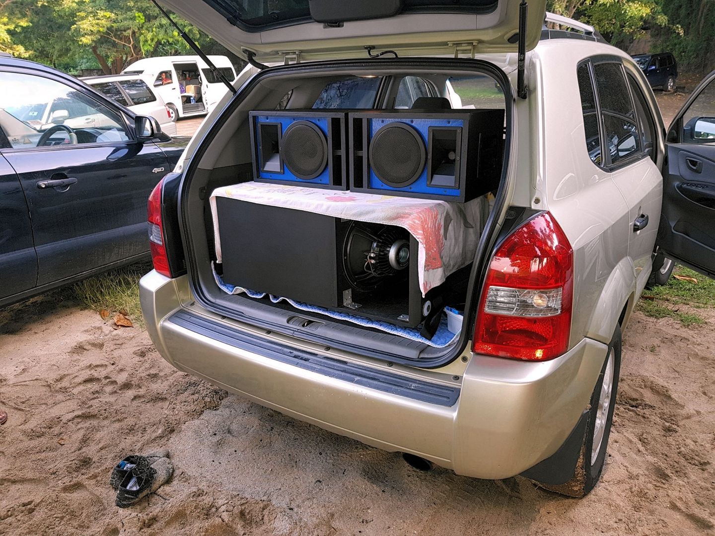

Well, yes I'm aware of the difference in output. But my main constraint for this build is size, because I already have something that makes lots of sound. Could you recommend any driver that would perform better in the poc6?
Theoretically the Eminence Kappalite 3012LF should provide a similar response curve and up to 6dB more peak output above 48 Hz in the same box. It's more expensive than the Dayton PA310 of course, but you should end up with more output capability and a lighter box.
If you're building this to transport in a car however, I suggest giving serious consideration to maximizing the use of the available storage in the car. You might just be able to get away with larger bass boxes 🙂

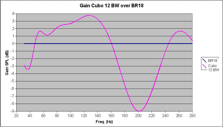

It will equal or outrun a single 18” BR* , from 50-55 Hz and up in terms of sensitivity.

Yes I did, and I'm not sure you understand my response. You are comparing two systems with different design goals. One is designed to do 40 Hz, the other is not. Comparing from "50 Hz ~ 55 Hz up" does not make the comparison any more valid.
The design goals of the THAM12 and the Cubo 12 are a lot closer and would likely form a better comparison.
Having built a 50 Hz box, I know a lot of music will play on them fine, but no-one with decent hearing is going to confuse them with a box that can do 40 Hz.
