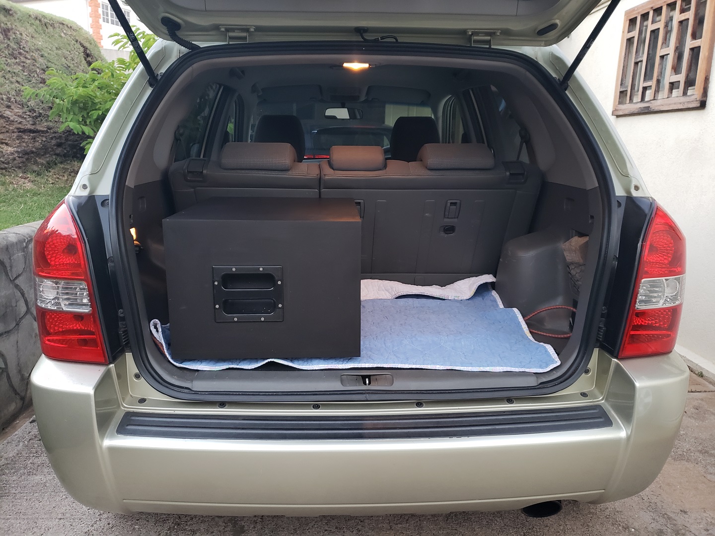

Is that two x poc6 in your trunk on that picture? they are so small, omgosh. And did you put a hf horn on top?? I will definitely build the cubo12 for another project, but if that picture is correct, I have made up my mind.
Nope, that's the POC3, equipped with the Kappalite 3012LF driver. On top are my Blastoramas.
As I mentioned previously, that's a POC3, not a POC6. However, I was curious as to how many POC6 boxes I can get in the trunk of my vehicle. Turns out I can fit two, with a little space to spare (the picture shows only one, but it takes up only half of the trunk, so...)
I think I lucked out here there. It certainly wasn't designed with optimizing trunk space usage in mind.

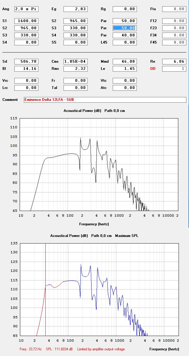

I think this kind of box would be ideal below my Fane 12-250TC boxes. I wonder if Delta12LFA could be used to get some meaningful output at the low end (I have a pair laying around). I did some crazy modifications - and got some low end extension at the cost of efficiency and box size...as expected🙂
I got back to this box type and came up with this. I am pretty sure someone could improve on this - but a 110 l box with Delta 12LFA is not too bad when crossed over at 100 Hz I guess - and that is all I need. Anything smalled than my > 300 l bass horns will be space saving🙂

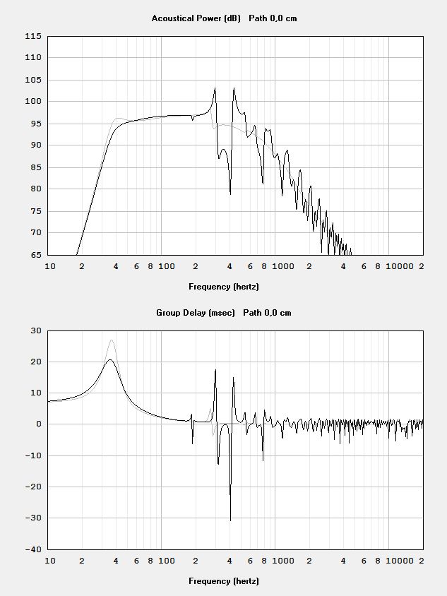

I played with the foldings and Hornresp and I compared the MLTL to a BR with the same port size and volume. I found the only difference in the group delay, the MLTL is ca 5 ms better. Is that worth one extra piece of wood? I think yes. And please keep in mind, this is intended as a home subwoofer with 100 W max and proper highpass. And I have two Delta12LFA speakers left from another project, so I think I will build a pair. I must say, the Excel sheet is a really nice tool, thanks!
