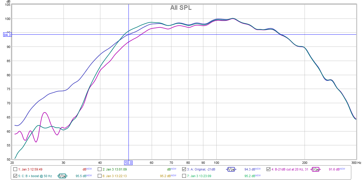

The audible distortion manifested itself at frequencies below Fb (~50Hz), and it was during a swept sine wave test at different SPL levels, which can be particularly hard on vented designs (or any design where the driver is unloaded below a certain frequency). I configured REW to start the sweeps off at 44 Hz and then changed it to 48 Hz for the sweeps at higher power. I still wasn't able to achieve 10% THD in the passband, but I got very close.
I was able to find some temporary stuffing material yesterday afternoon, so I'm going to perform another set of tests today on it, including the filtering suggestion I gave in a previous message.
Hey, I can even make a good recording of it (using the UMM mike) playing back a few tracks. Any suggestions? 🙂
The results of the filtering look pretty good - see attached. Basically I minimized the 20 Hz and 31 Hz setting, then increased the 50 Hz setting a bit to compensate and add a little extra at that frequency.
I also tried running it again at the maximum volume I was prepared to drive it. My multimeter suggests that 32.2V at 70 Hz and 37.7V at 50 Hz. It survived the playing of some test tracks with lots of low frequency bass (e.g. "Mi Gente") intact without sounding stressed. At peak levels it did lose that "effortless" sound of the POC3 TH alignment though, but that may be due to my "confirmation bias" at work again 🙂

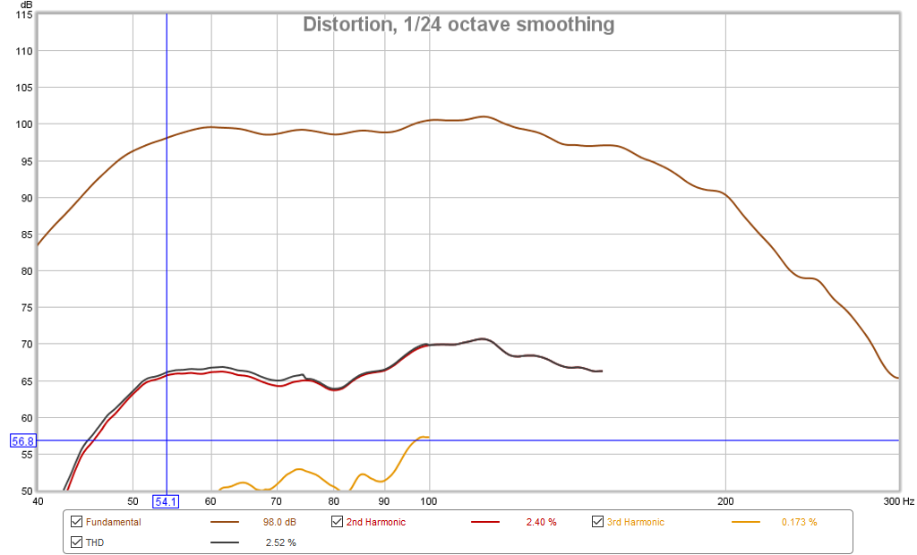

Interesting you'd mention that. Per the measurement below, the distortion is primarily 2nd order in nature (though at high levels the driver's terminals can be heard buzzing via the vent). We are not sensitive to distortion at bass frequencies, and we are certainly not sensitive to even order distortion at bass frequencies - it can actually make the bass sound "fuller". This might work in this design's favour.

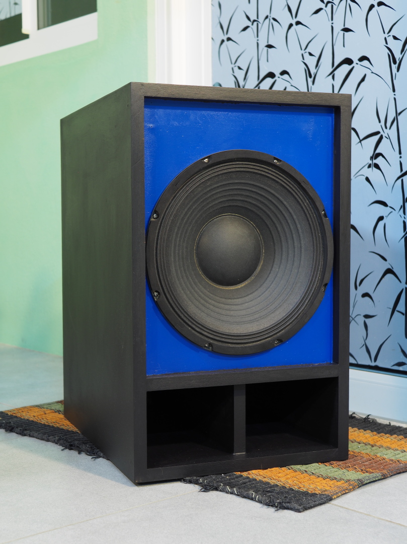

Just a minor update - I've finished the first paint job on the POC6 (which of course exposed all the flaws that need to be corrected). I built this as a sort of "reference", but it might actually end up getting some use outside, so I've got to find a way of protecting the MDF from the elements (the occasional beer spill, etc.). Paint and a good mesh grille for the driver should do the job.
The POC6 actually sounds pretty good, with a nice punchy sound with most music. It's about the third time (that I know about) that the MLTL workbook has been used to successfully design a subwoofer (though with a 48 Hz Fb, and a rolloff that starts a bit above 50 Hz, this is more truthfully a bass module than a subwoofer!).

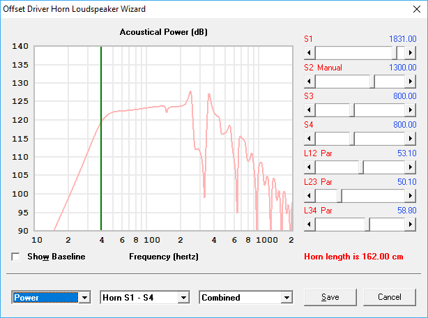

The end user wonders if these would work in a TH. He already has PAL12's for smaller gigs but has a pair of mid-high boxes that don't go below 100 hz. For side fill use size matters on stage so that is a factor. Active x/o.
