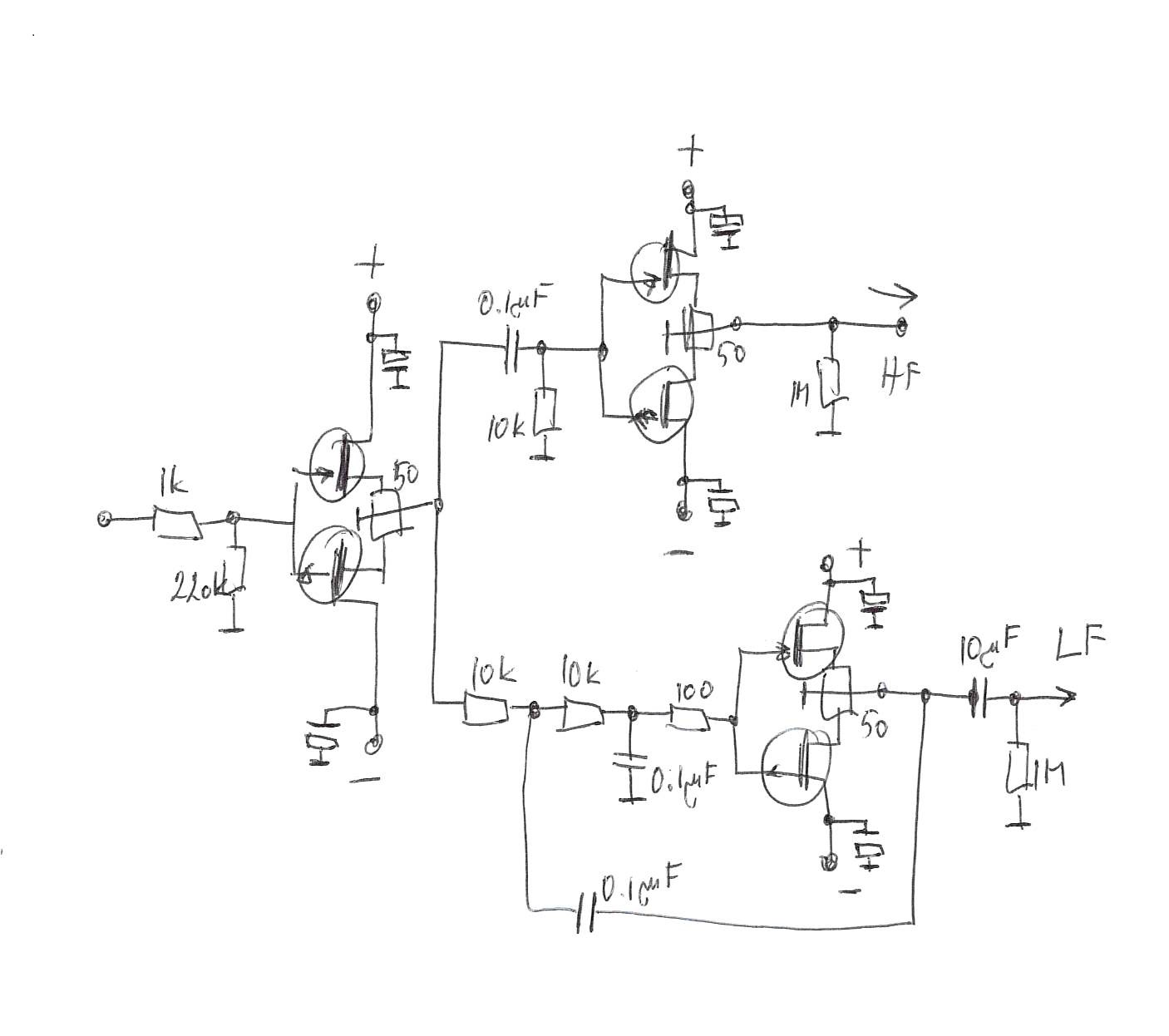

I am thinking about building yet another active crossover. I am debating as to either make steeper slope with feedback or just simple lower slope crossover.
Crossover will be ~150Hz as this is what I was always using so far to power mid/tweeters with classA amp and below that with classAB for woofers. Normal stuff.
I am looking for highest purity of tone, highest clarity for mid and tweeter, so less caps the better, plus I am using open baffle with natural roll off. So 6dB/oct should be plenty.
For woofers, I prefer steeper crossover. Can I just combine both types? Will there be negative consequences for phase or uneven fr response around crossover? Or should I stick to the same slope?
Btw, if you see any obvious mistakes on the schematics, please let me know, I just drew it from other active crossovers I have seen around. Thanks.

if mixing slopes is no problem, this is what i am going to build
can't get any simpler
one cap upper path
output cap in lower path can be avoided, but its less critical, i may use bipolar
lets built it then
one cap upper path
lets built it then
Sometimes mixing slopes is the only way to ensure you get good phase matching 🙂
I have seen very few crossovers (active or passive) where the slopes and frequencies for any two non-coincident driver combinations is identical. It never works properly if you do that.
VituixCAD allows you to simulate active crossovers by using functional blocks (which you would replace with your circuitry).

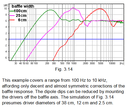

I noticed that your schematic does not have any sort of shelving for the baffle step correction, which will be mandatory. Also there is an acoustic offset to be accounted for because of the difference in acoustic centers, which needs to be factored in.
