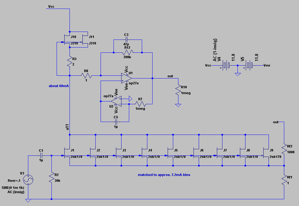

These are the experiments I've tried. First, the attached circuit measures for me around 0.43nV/rtHz at 1kHz.
1) to rule out that the noise comes from the PSU (batteries), I built a filter similar to the one syn08 uses in HPS 5.1. The noise was higher than with batteries, when powered from the lab psu, and the noise was the same when the filter was between batteries and the circuit
2) to check again that a passive load would have lower noise, I replaced the 2xJ310 CCS with wire wound resistors of various values and measured the noise at 1kHz. The lowest noise with a resistor load was about 0.51nV/rtHz.
3) to eliminate the noise from the second stage I disconnected R8 from node a11, and Rf2 from node out. Then measured the gain at a11 with the CCS and with the best resistor load. The gain with the CCS was about 39.4dB, and the measured input referred noise measured at 0.42nV/rtHz. The gain with the resistor load was 26.3dB and the input referred noise measured at 0.48nV/rtHz.
4) to check if the noise could be further reduced by paralleling more devices I tried 18x2sk170bl with various different loads optimized (CCS and passive). Could not get the noise below 0.43nV/rtHz.
The batteries were freshly charged.
A few notes about this "bastardized" design. Matched the Vgs of jfets J1-J9 as close as I could. Chose J10, J11, so that their combined Idss would be a bit larger than the combined current through J1-J9. Then chose R3 to get the highest gain at node a11. The voltage at a11 is around 5V. Tested the circuit with LT1028A for U1, but the noise was the same, so I left the OP27 in.

I'll start first quoting myself from post 326. This experiment was intended to measure the first stage with both resistor and CCS load, so the second stage was completely disconnected.
To measure the noise the setup was as follows:
0R -> preamp -> analyzer 1Meg input -> analyzer screen
To measure the gain the setup was as follows:
a) 2.5mV RMS 1kHz sine wave from HP function generator -> true RMS voltmeter (Fluke 931B)
b) 2.5mV RMS 1kHz sine wave from HP function generator -> preamp -> true RMS voltmeter (Fluke 931B)
So gain is measured value from b) divided by measured value from a)
With the CCS the gain was 39.4dB which is approx. 93.3
With the resistor the gain was 26.3dB which is approx. 20.6
With the CCS, the measured noise at 1kHz (read on the analyzer screen) was about 39nV/rtHz. The HP 3585A analyzer has a "noise level" function which rreports the noise spectral density at the marker position (in this case 1kHz).
So I divided 39 by 93.3 to get 0.42nV/rtHz, the equivalent input referred noise of the preamp, ignoring the analyzer noise floor because I didn't think it was significant. If I had subtracted, the result would have been 37.7nV/rtHz = sqrt(39^2-10^2), or referred to the input, 37.7/93.3 = 0.4nV/rtHz.
Now, the resistor load case. The analyzer reported 14nV/rtHz at 1kHz. Because 14nV/rtHz was so close to the analyzer noise floor, I subtracted it. So
sqrt(14^2-10^2) = 9.8
which when divided by the gain of 20.6 results in 0.48nV/rtHz
This is the reason I said that to me it appears that the CCS load results in lower equivalent input referred noise than the resistor.
It is possible that I made a mistake though.

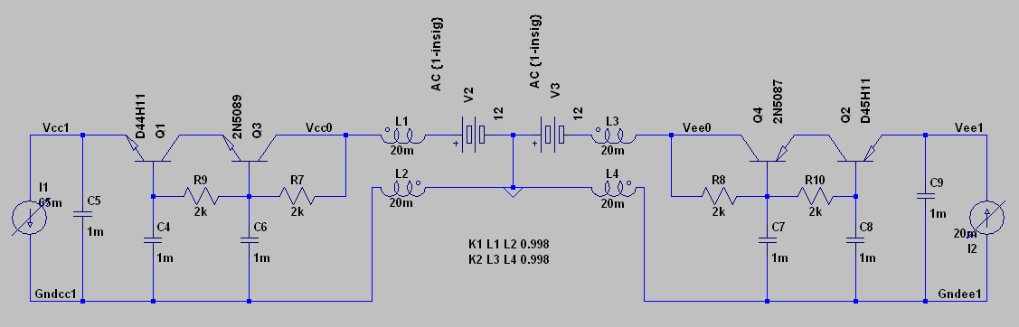

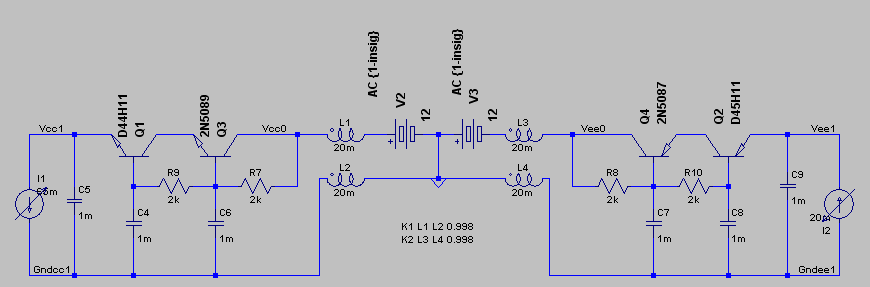

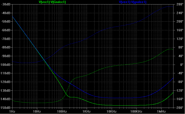

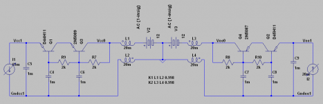

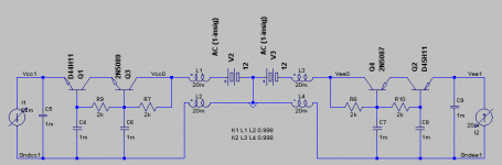

Thank you. In an attempt to improve the PSRR and get rid of some of the RF junk I implemented this simple cap multiplier (Joachim, good suggestion!). Also added a common mode ferrite choke like those found in the psu of many CRT monitors. This filter made a difference in powering the circuit from the lab supply which is terribly noisy. It cleaned up most of the junk. The filter output impedance is dismal, so I may come up with some filter/regulator that's better than this one.
One issue might be the filter self-noise, hence I used the D4xH11 in that position, which seemed to be more sensitive.
Now, with the preamp input shorted, and powered from the lab psu, the equivalent input referred noise was almost as low as when using batteries. In fact the difference is so small that I'm not sure. For me this is a bit of progress because I can live with a tiny bit higher noise than using batteries, but get rid of the nonsense of recharging.
