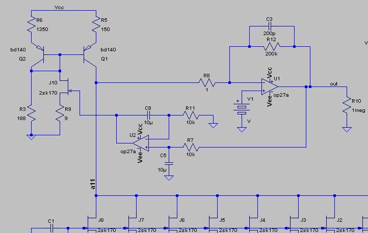

Simple 60dB discrete low noise amplifier (lna)
He uses 32dB gain as standard he mentioned.
The circuit he posted earlier has 60dB gain. I have no doubt this kind of thing is trivial for syn08 and Samuel. It's probably really frustrating to them to see what I'm doing.
jeepee, I'm not sure if this is what you had in mind? I'll read your post again more carefully.
Edit: actually I'm sure I got it wrong.
Hi Ikoflexer,
well done, you translated my "netlist in words" to the schematic I had in mind (literally). Are the results satisfactory? What's the voltage on node a11?
Your late night experiment with dissapointing noise, points again to the fact that whatever you put on the drain side of the input JFET's, is simply in parallel to that input JFET drain current noise. So it adds up and spoils your ultra low noise input stage performance...
Can you simulate the noise of your circuit(s)? Just for fun, take you simple schematic, the one with the 150 Ohm Rdrain and make the supply 10x higher and the drain resistor 10x150 Ohm, what happens to the noise? Try again with 100x supply and resistor value. Don't change the OpAmp supply though 🙂
So what I don't understand well is why the BD140 current mirror would have such higher noise, whereas the simple 2xJ310 CCS achieved the lowest noise.
Ikoflexer, try again with 150 Ohm degeneration...
BTW: that late night circuit, even though AC coupled, still has the "fighting" current sources... You need to "slave" the upper current source one way or the other. There is no degree of freedom in that circuit. Loopgain is not important, since the input JFET drain (signal) current is sinked (sunk) by the near 0 Ohm small signal input impedance of the transimpedance stage (U1/R12). The circuit is a concatenation of a transadmittance stage, V-to-I [JFET J1-J9], and a transimpedance stage, I-to-V [U1/R12]. Open Loopgain is gm_JFET*R12. At the intermedaite node, a11, there is ideally no signal voltage. The signal is in the current domain.

With 3V on the +IN of U1, the DC voltage at a11 is 4.09V. V(out) is -10V. The currents through the current mirror are totally out of whack!
I think this isn't working exactly as you wanted. Let's see if I understood what we want here. We want the CCS DC current to be as close as possible to the jfet Id. Don't we then want to sense the DC jfet current and then via feedback of some sort manipulate the current mirror to deliver something close to that?
Your late night experiment with disapointing noise, points again to the fact that whatever you put on the drain side of the input JFET's, is simply in parallel to that input JFET drain current noise. So it adds up and spoils your ultra low noise input stage performance...
Yes, it just isn't clear to me why 2xJ310 would be less noisy than the BD140 mirror. The J310 is rated at about 6nV/rtHz I think. Perhaps the BD140 setup has quite a bit more current noise.
Jeepee, ltspice has a "noise" analysis but I wouldn't trust it at all. I think it does only very basic thermal noise analysis.

syn08, I don't even know what to say to you. Instead of addressing each point, I'll just go for a blurb. Please understand that I have a few objectives here. One is to eventually end up with a preamp that works. The other is to explore and learn, hence the moving target. I'm quite happy with 0.4nV/rtHz, but hey, why not push it as far as it goes?
I don't think I dismissed any suggestions so far. Out of respect for the time other people took to make a suggestion I make a point out of putting the time to test it. For every suggestion, first I plug it in the simulator, more to capture the schematic but also for basic sanity tests. Then I built it in the tin can. Why do you insist on a pcb? I could argue that using a pcb will add noise. Let's see if you laugh 🙂 In any case, I don't want to argue, I do what I can. You have the benefit of EE schooling. I don't. Think of what I do as "EE lab 101." I appreciate your input and followed your advice as well as I could.
To start over, you were given two solutions that were experimented and are proven as working properly. You dismissed both as being "unstable". Well, they are both (Samuel's and mine) rock solid and the only reason why your isn't is, guess what, the tin can construction. Now, if you add to the requirements "to be feasible for a tin can construction" then I can't certainly help (and I guess nobody can make anything but an educated guess).

It was my impression that the first stage should have enough gain so that its noise would dominate the total noise of the preamp. One things that I don't understand in this transimpedance amplifier + feedback is how the gain of the first stage is maintained as high as possible, when in the same time the feedback is applied to the jfet source, and also the gain is set roughly by gm*opamp_feedback_resistor. So, in trying to understand this, I wanted to see what happens trying to get the highest gain possible from the first stage (using a CCS load).
The 2xJ310 not a CCS but working as a gate controlled resistor. I guess you use the term CCS to refer to an ideal CCS? Whatever it is, I got higher first stage gain and lower overall noise using the 2xJ310 than with any resistor. And believe me, I've tried to come up with the best value load resistor. If the J310 was just a resistor, I should have been able to replace it with another resistor or proper value. The way I think about it is that the 2xJ310 is nearer a CCS than a simple resistor.

IKO, I am going to give you yet another 'guide' to low noise design.
First, 0.3nV/rt Hz is the equivalent noise of a 5 ohm resistor, 0.4nV/rt Hz is eq. to 10 ohms, and 1nV/rt Hz is 60 ohms approximately.
For whatever reason: the EQUIVALENT R for a resistor is about .7/Gm of the total group of paralleled fets that you use. This is the best case, usually it is a little worse, because of biasing resistors and 1/f noise.
That comes out to about 25 ohms for a single 170 j-fet. Could be a little more, could be a little less, depending on devices and operating current. More current gives more Gm and lower noise, UNTIL the junction gets too hot. Paralleling 8 devices gives an ideal effective noise of 3+ ohms and with the added 1 ohm feedback resistor, it is theoretically possible to get 0.3nV/rt Hz.
Now, what is wrong?
First, current source loads can be very noisy, and usually add something significant. Why just not limit your design to a resistive load, either wirewound or a very high quality metal film resistor. This will not AMPLIFY its own noise, at least, although, make sure that you get a voltage gain on the input stage of at least 10, hopefully more in order to not have the second stage contribute much to the total. Just remember:
Vg>10=(Gm)(Rl). It is necessary to drop a few volts across the resistor be able to use a fairly high value with the given high current, and get you safely out of the added noise zone. Start, for example, with 100 ohms and see. Still, .4nV/rt Hz is pretty respectable.
This is a little bit clearer -- you can grab a beer between averaging the analyzer -- the SSM2019 has fewer issues with 1/f noise than the Colin Low Noise amp. (The case in which this SSM2019 is housed appears a little problematic.) I used the AP "equiripple" window, and averaged 256X.
The Colin amp, an LSK389 followed by an AD797 yields 1.9nV @10kHz, but 7.0nV @100 Hz. The SSM2019 @60dB is 3.1nV +/- 0.1nV down to 20Hz. The SSM2019 is least noisy at +60dB.

Good question. I'm pretty sure I eliminated the second stage as a possible suspect. Today I've replaced the op07 with an lt1028 and the measurement remained around 0.43nV/rtHz.
Two things about this. One, before trying the current source load I used a wirewound resistor. Its values was between 100 and 150 ohms; tried several values and chose that which gave me highest gain in the first stage, which amounted to around 30dB.
Then I tried a current source more out of curiosity; turned out that two paralleled J310 brought the overall noise down to less than 0.5nV/rtHz. Lower noise than with the resistor. Checked the gain of the first stage with this simple current source load, and it was, depending on its setup, between 40dB and 60dB. I didn't bother to look for the resistor that would give the highest gain here. Just as well, since I've been told (above) that trying to get high gain in this first stage is a mistake on my part.
In any case, the 9x2sk170bl jfets run at about 55mA DC. So I roughly matched a pair of J310 jfets to have a total Idss of more than 60mA, so that the right source-gate resistor would bring Id close to that of the paralleled 2sk170. So the J310 is rated at about 6nV/rtHz voltage noise. Two in parallel would have about 4.25nV/rtHz.
Something I don't understand well is why the noise of the J310 isn't affecting the overall noise more, and I don't understand why I was discouraged to get higher gain in the first stage.
