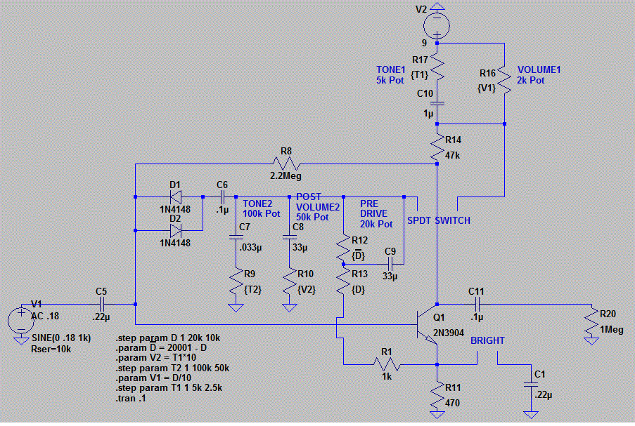

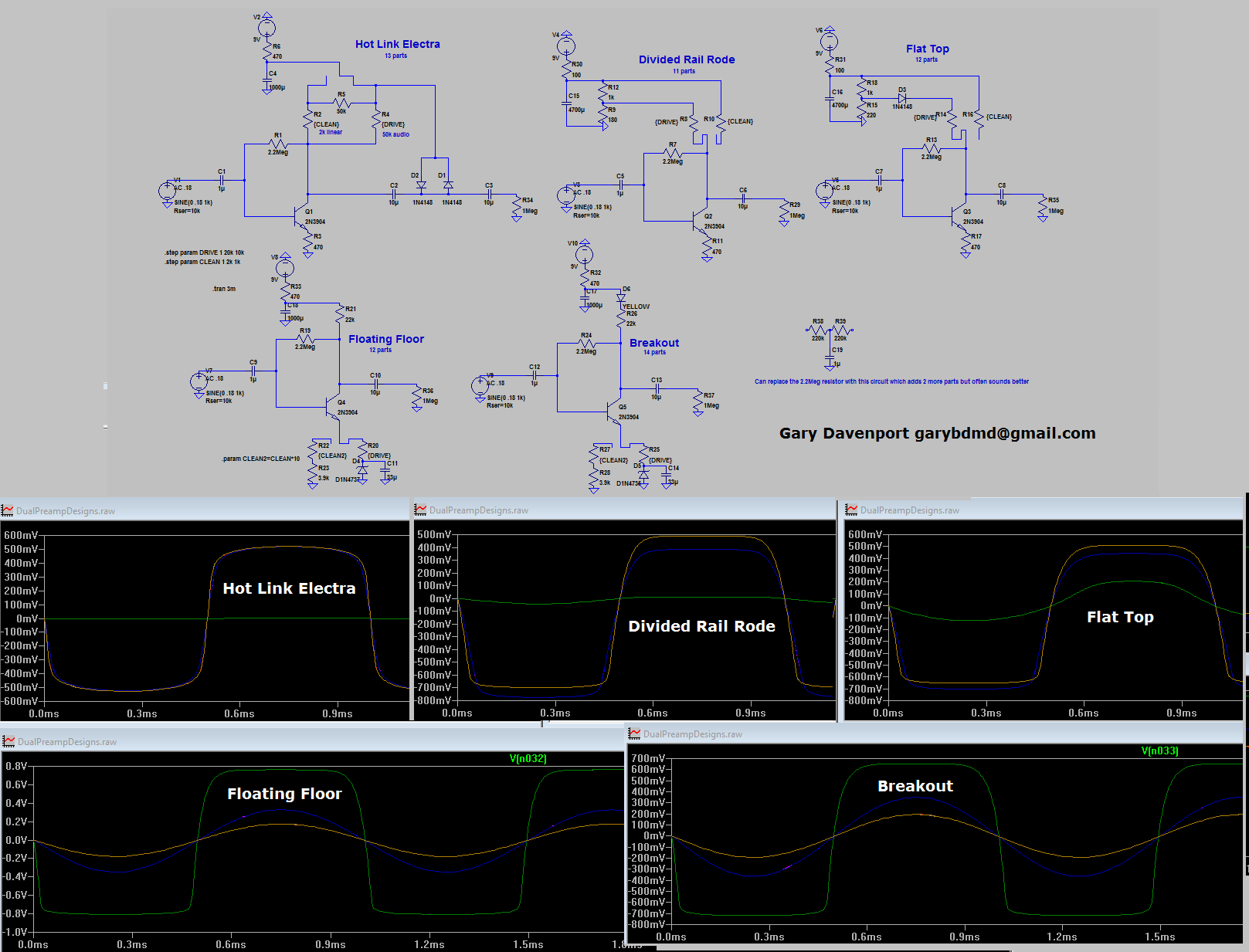

Single 2n3904 Channel Switching Guitar Preamps, 5 circuit ideas shown, please comment
Here are some circuits I have been working on. This is sort of a right of passage that I've not been using op amps and I'm just trying to learn how much can be done with minimal parts and simple circuits. I was impressed by Joel Davisson's Easy Drive circuit for guitar distortion as I thought it sounded ok for how simple it was. Also the electra distortion can sound quite good depending on the diodes used and the filtering and so forth. Anyhow these circuits have already been done, but I thought if I ever used one as a preamp feeding into a power amp, it would be nice to switch to clean channel and have the volume the same. In other words, I'd like a simple preamp which can be switched from high drive/distortion circuit to simple preamp probably gain 5 or so. This is very simple to switch from one of these circuits by employing a DPDT, 3PDT switch etc. But I plan on switching tonestacks and other things in the circuit, so I don't want to make the switching too complicated. If so, you might as well just add separate signal paths for different channels and use more transistors or op amps.
My goals here are essentially:
1 Single 2n3904 transistor
1 Single pole switch
ability to trim distorted or clean levels is ideal
output impedance <100k, ideally <10k
minimal parts, it would be nice keep the parts list low enough to use panel mounted switches and pots and solder parts to them
Here are the circuits I came up with and I'll describe the ideas behind them. I'm interested to hear from people about whether the ideas are good, bad, etc and why. I've named them just so its easy to refer to, and I have not really tested any of them fully. I'm looking to get feedback from people before I start testing them. (BTW I'm thinking you can replace the 2Meg resistor with 220ks and a .1u going to ground as shown on any of the circuits, for a little extra gain and tone shaping. This really does help the sound experimentally, although it doesn't do much in Spice Simulations.)
1) "Hot Link Electra" This is an Electra type distortion, but the diodes go to positive instead of ground. I've tested this by ear only on an electra distortion I built, I cannot tell the difference between the two audibly. There is a start up charging capacitor, so that when you power up it doesn't send a jolt to the output as the power slowly turns on. The capacitors around the clipping diodes should remain relatively well charge through the 50k resistor during either state clean or distorted. An LTSpice simulation showed that 50k was enough to isolate the drive and clean signals.
2) "Divided Rail Rode" This is based off a rudimentary distortion "Rail Rode" I made where the top of the signal clips at the voltage rail, and the bottom clips at the bottom of the transistor. This uses a voltage divider to knock the 9v down to around 1.5v so it clips at the rails. When you switch to clean channel the voltage divider is essentially removed from the circuit and the gain changes. This was basically one of the most rudimentary ways of making a clipper circuit that I could think of. It doesn't sound great, but if you replace the 2Meg with the circuit mentioned it helps quite a bit. (I have not tested the circuit with a 9 v battery and voltage divider, but with a 1.5v battery). This circuit is sensitive to having exactly 9 volts, but the voltage divider can be trimmed if needed.
3) "Flat Top" This is identical to the "Divided Rail Rode" circuit but instead of the top of the signal hitting the top voltage rail, it hits the bottom of a diode. I was guessing different power sources would clip differently and a diode might clip more consistently and possibly softer.
4) "Floating Floor" This circuit also clamps the signal, but instead of using a voltage divider, it raises the ground in the class A amp circuit from zero to 7.5 volts, leaving only 1.5v (9v-7.5v). It does this by using a zener diode (7.5 zener voltage). I ordered some zeners in the mail and will try this, I'm assuming this would work ok.
5) "Breakout". Like the old atari game where the pixel bounces off the ceiling and your platform at the bottom of the screen. This clips the bottom with a zener and the top with a diode. You could probably use multiple series of 1n4148 or 1n4001 etc or any combination to get the desired voltage drop needed at the positive rail. Basically you have 9v - zener voltage of 6.2v - (1.8 to 2.2 volts/~yellow LED voltage drop) = <1v
Please leave any comments, suggestions etc. I am looking to see if there are any basic problems with what I have done with these circuits.
I included the circuits and what the distorted waveforms look like for each circuit. The clean channels look like sine waves.

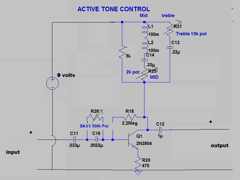

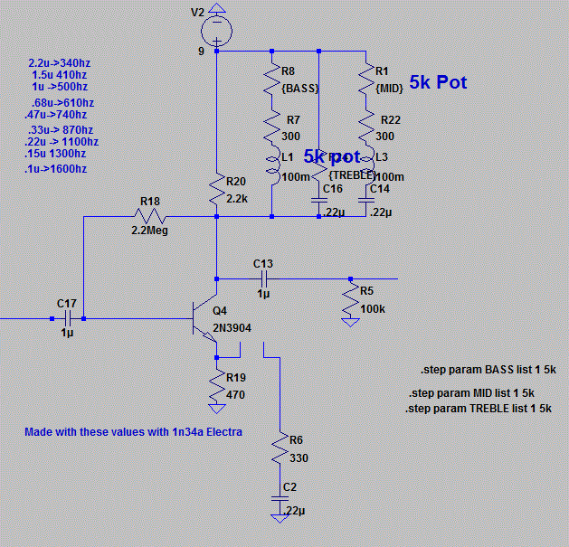

1 transistor 3 band tone circuit, will it work?
Hi, thanks for looking. My main reason for posting was to get advice on the midrange control connected to the transistor's emitter.
(I was trying to design an easy 3 tone control with one simple transistor. I know the treble and bass controls work). I circled the midrange control. I ordered some inductors to try this out. Has anyone seen a design like this? Are there any problems with this idea that you recognize?
Basically its a simple LC resonator that has high impedance and at resonance. Its placed on the emitter to limit the gain of the circuit at resonance. It is placed in the emitter resistor position of a simple class A BJT amp. The circuit has an input impedance of about 100k and output impedance I'm thinking of < 5k.

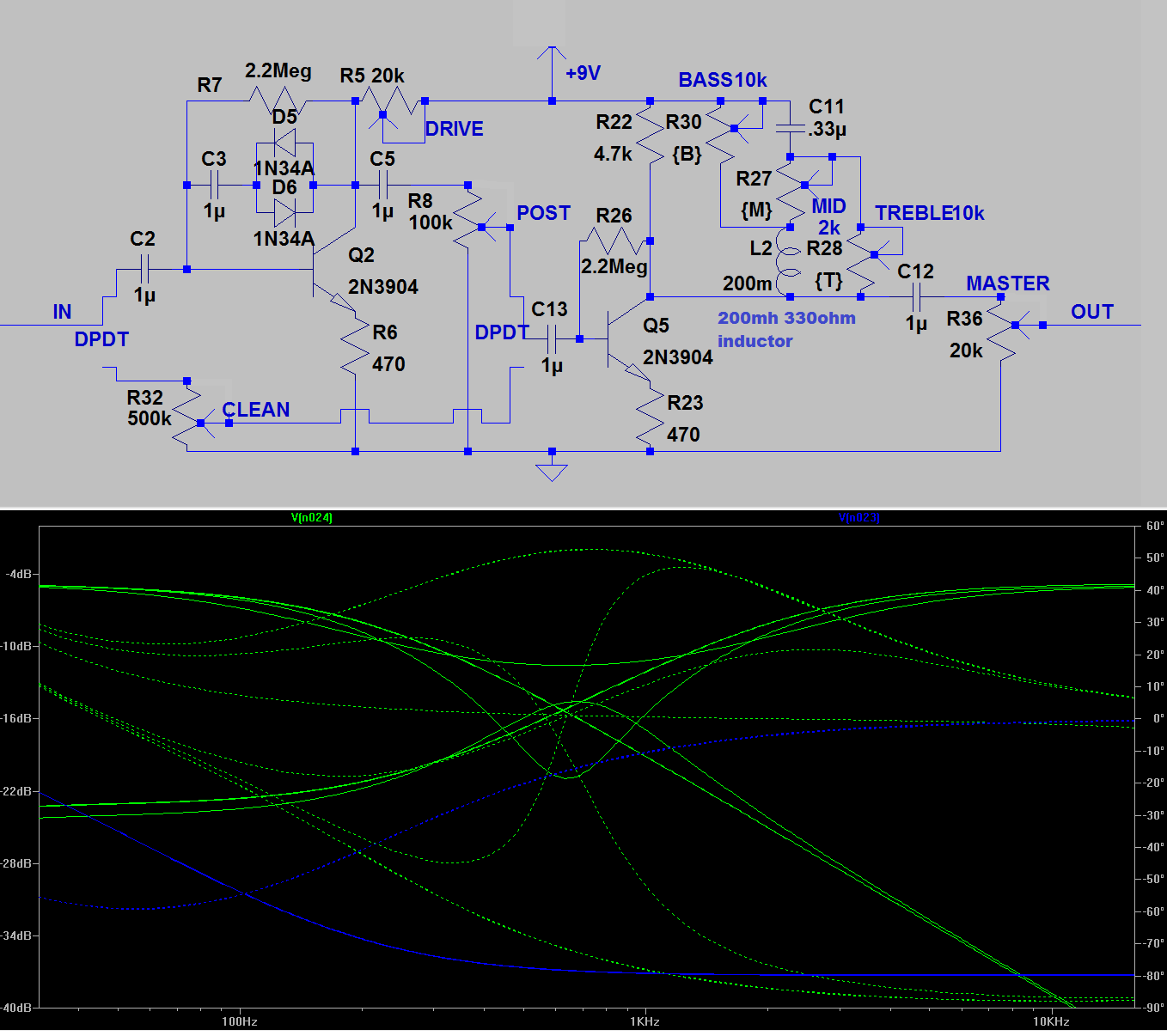

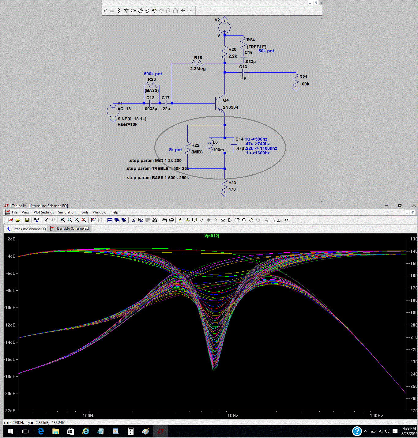

Simple guitar preamp with 1 transistor
Here is a simple preamp with channel switching. It has tone control for each channel. There is a "Drive" control which is unusual as it just bypasses the transistor from collector to emitter. (Basically the transistor is bypassed when the potentiometer is at zero, and at full resistance it forces the signal through the transistor. I did this originally with a pot, but then just allowed the ac to escape with a capacitor on the pots wiper, sounds better and better drive control) I did this because it allows simple wiring and a simple SPDT switch. It also has a "Post Volume" which is pretty rudimentary but better than not having it there. The tone controls are a bit interdependent on the volumes, but this doesn't seem to have much practical consequence as long as you understand how the circuit works (at low volumes the high treble cut is less pronounced). It actually sounds pretty good for what it is at full drive for how simple it is. Its similar to the Design your own distortion website and uses similar feedback as Joe Davisson's easy drive. Just thought I'd share this build if anyone was interested. The bright really only effects the clean channel audibly at least through a power amp and 1 12" speaker

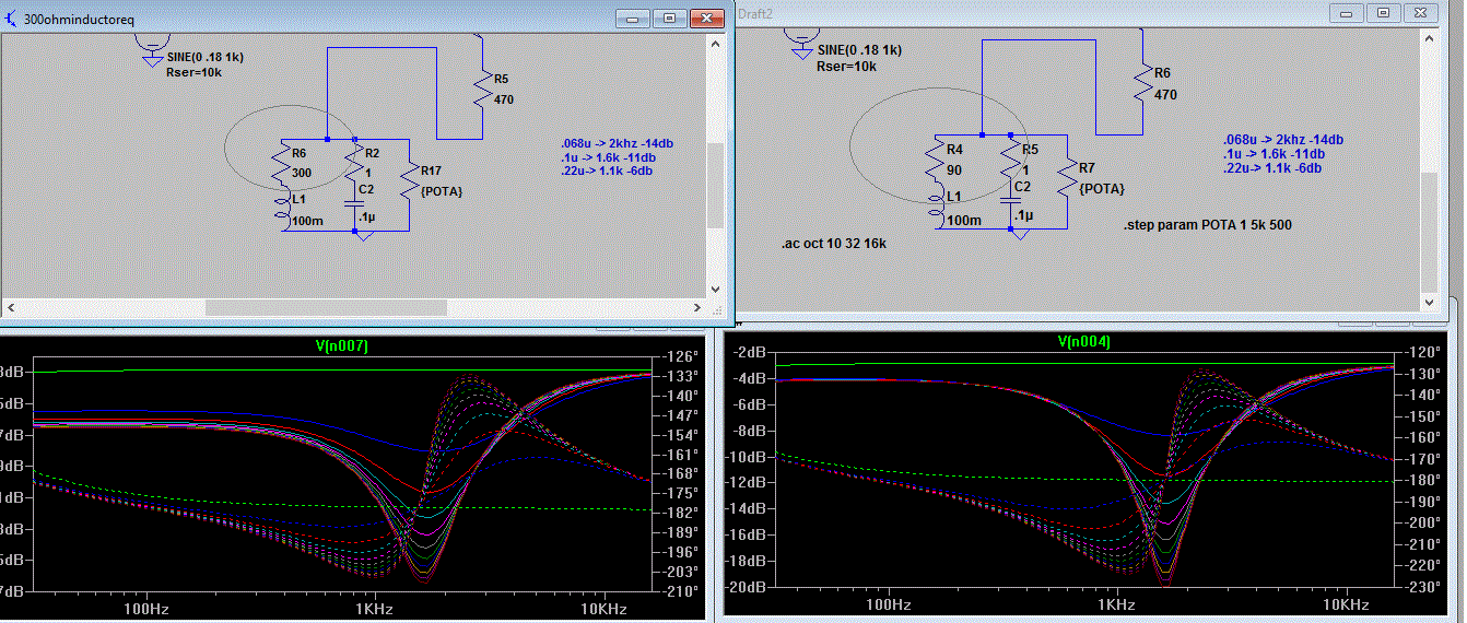

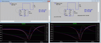

bass loss due to dc resistance of inductor
I am waiting to get inductors in the mail to try out. There were cheap inductors for 38 cents that had DC resistance of 300 ohms. A little more expensive for resistance of 90 ohms, then $2 a piece for 4.5 ohm inductors. I ran simulations on the 90 ohm and 300 ohms inductors to see the effects and there is bass loss. The 90 is not too bad with 2db loss. The 300 ohm is probably unacceptable for HiFi, but might be A-ok for a guitar amp as I've seen many tonestacks with some Bass loss in this range. I'm interested to see how these work out when I get them in the mail. Thanks for looking. I'm curious to see if this actually works and if its noisy. I've seen schematics for the cry baby wah but the inductors attached to the signal path not the emitter effecting the gain. So will repost after I test this circuit for anyone interested.

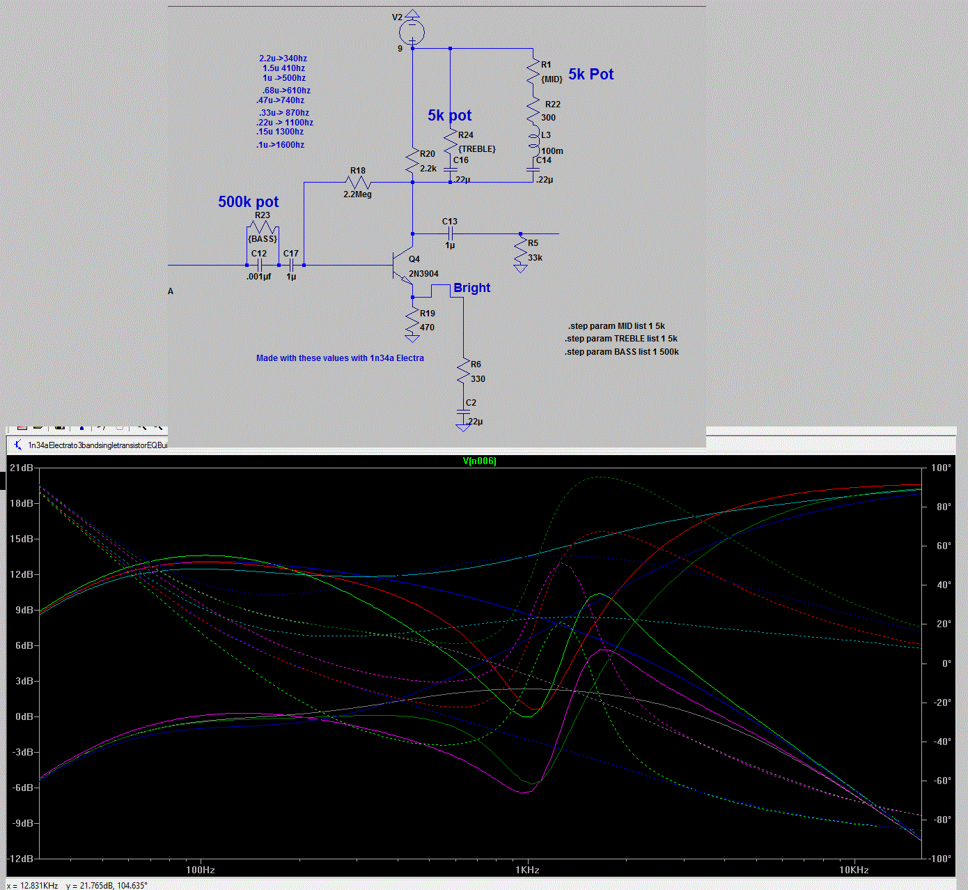

built similar circuit that works
I used a series LC circuit at the collector rather than putting it at the emitter. I ran an electra distortion with 1n34as on the output then into this circuit. I ran that into a flat power amp with no filtering with 33k input impedance and then into a 12" speaker in an open back cabinet. These are the values I came up with tweaking by ear and you can see the simulated bode plot. Seems to work fine. Didn't sound noisy with this setup. I like this tone control because it has 100k input impedance and relatively low output impedance. I did not hear any radio transmissions etc with the inductor but it was shielded. I used an inductor with a 90 ohm dc resistance and added another 120 to it, because I wanted to design the circuit with the cheap readily available RF inductors which are 38cents and have 300 ohm resistance.
Next I am going to run a clean guitar signal into one of these arrangements and tweak everything by ear, caps, pots, bright etc. Thanks for looking. IF anyone knows of a similar circuit filtering the gain instead of the signal let me know. I've looked around but haven't found anything.

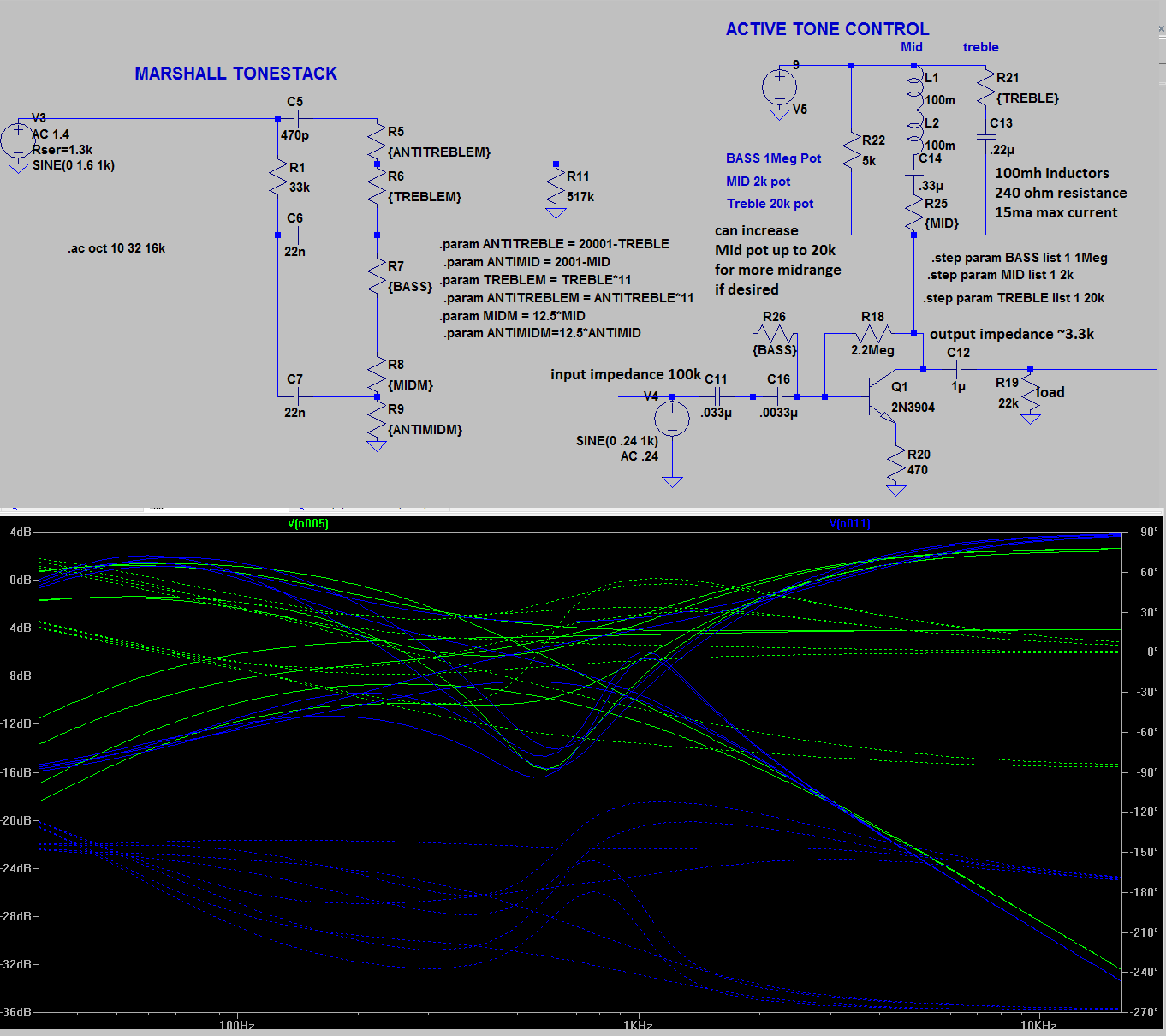

"Active" Marshall tone control
This circuit is intended to be placed between an electra type distortion or any distortion (20k output impedance or so) and a power amp 22k input impedance.
The electra type distortion I used had a collector resistor of 20k an output Impedance of 20k and 2 1n34as as clipping diodes.
It has the advantage of not requiring a buffer after the tonestack and preamp.
In other words just insert this circuit after the distortion and before the power amp.
I used common inexpensive 100mh inductors which I have measured to be 240 ohms dc resistance.
Its a reasonable approximation to the Marshall tonestack in terms of the maximum and minimum values of tone controls.
It also by its nature has a gain of roughly 12 db.
This allows you to run an Electra Distortion (1n34as) into this circuit with an output voltage of about 1vrms.

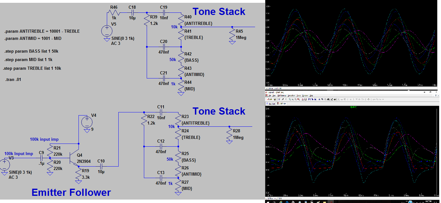

Puzzled about driving a tone stack, any help appreciated.
Hi there, I was working on some guitar preamps, and I was thinking I would increase the gain and then run into a tone stack, then buffer, then power amp. The tone stack is a scaled down marshall type tone stack. Anyhow, I get this clipping in the design which I don't understand. In the figure I am showing 2 circuits. The first is just a signal 3v amplitude going through a tone stack and I vary bass mid and treble and here is the result at 1khz. Looks fine. But then, if I add a simple buffer just before the tone stack I get clipping. Can anyone explain why this does not work correctly?
Definitely 🙂
You are trying to pass a 3V **RMS** which swings almost **9V PP** through a buffer which is fed by puny 9V.
As a side note, you did not assign internal impedance to signal generator, while real world ones will have a significatve one.
And at the buffer, positive signal half comes from the transistor, which can source a lot of current, easily 5mA and maybe 10mA, but lower half is pulled through a 3k3 resistor, which can sink best case some 1.5mA and that at very small signal levels, once negative signal peak is 0.5V from ground it can only sink 0.5V/3300 ohms= 0.15mA .... nothing!!!
So under load (the tone stack) the lower half clips early because of current starving.
One problem with simulators is that they can show you what happens ... but can´t tell you *why*.
Or to put it in correct perspective: a Simulator is a useful tool, but does not replace learning Theory.
