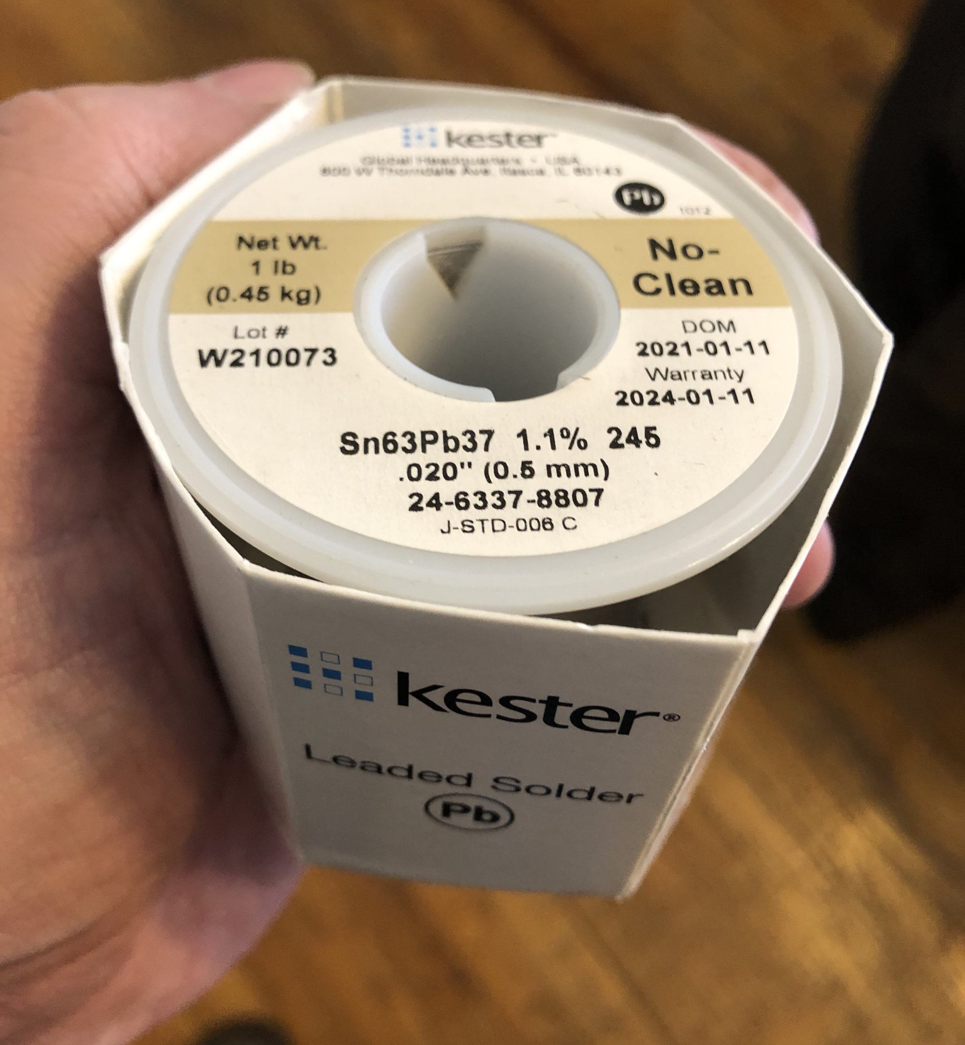

Got this nearly full roll for free. Was being thrown out at work for being "out of date".

Ya that's right. Every roll in the building was checked. There were probably 15 rolls in the box that was about to disappear. Expiration dates, on everything, is another focus point. If your blue Loctite has just expired but still 90% full, kiss it goodbye...
You know what I'm thinking, it's not so much that a $30 to $40 product (the price of the last 1-lb new roll of solder I bought, maybe 10 years ago) (x15) is being tossed, it's that 1/3 pound (x15) of lead being put right into a landfill, just the kind of thing that EU's ROHS is designed to prevent.
