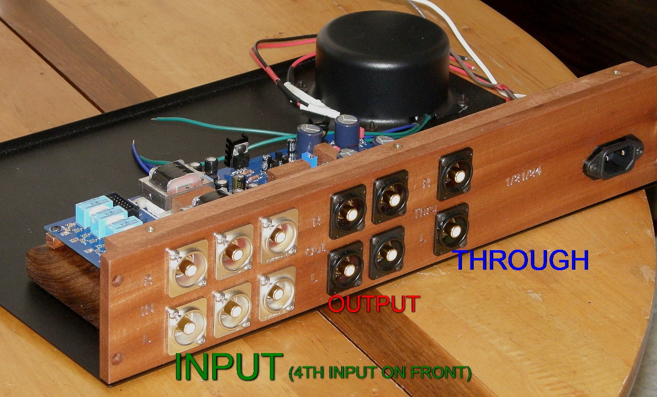

Maybe I should ask since I didn't get it right with my board. I have made a 'through out' for the rear of my Iron pre. I thought that I had it right, but just so I know where on the board would be the proper place for this connection? It wouldn't be the output. I figured that the connection that goes to the volume control (not after but before) would be the right place.
I mean to say that all input signals are available to this 'output' without any interaction with the preamp. For example, I have a separate headphone amp that would use this through output so that it only has a connection with the source. This would not be the case with the other 2 outputs that I am using.

wherever
just take signal from pot pads; GND and CW and route them to RCAs
that's Post-Selector
NB that Unenergized JFet stages are often acting as load/signal eaters, so in purpose you're explaining - Iron Pre either must be ON, or Vol Pot must be all the way CCW, so JFet gates shut to GND and signal routes isolated from said gates by value of pot itself
