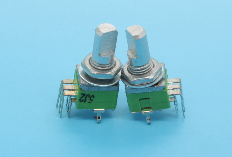

The thread that rose from the dead.... I just picked up some 50k single unit Alpha 9mm pots from Mouser. They are amazingly tiny, and very smooth and well damped. I'm currently running a pair of Bourns 50k conductive plastic pots in my new preamp with 19k Dale MF law-fake resistors. They sound OK, though there is some channel imbalance. I'm pulling the preamp this weekend to do some other changes, and I'll throw in the Alphas to see if I notice a difference...

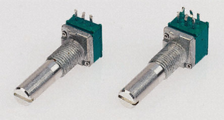

So as to push this thread another bit forward, I've just noticed in the catalog of RS the little, green, 9mm carbon pots, which are Alps. Apart from the name, they seem to be the exact same thing than those Jaycar/ Alpha taiwan pots.. They are of number 249-9137.
What is your opinion, am I right?!

Joseph K said:I've just noticed in the catalog of RS the little, green, 9mm carbon pots, which are Alps. Apart from the name, they seem to be the exact same thing than those Jaycar/ Alpha taiwan pots..
I went to RadioShack website but they don't list this pot. Can you post a pic. I'm very much interested.

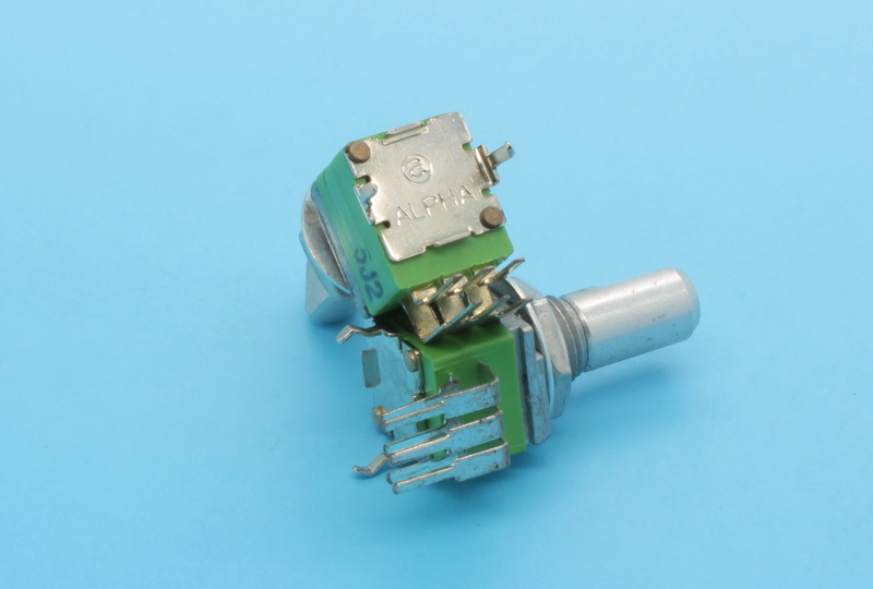

On the Jaycar silver-carbon pots, should I be getting the Linear or LOG taper..? I would be using them for tube preamp vilome controles @ 100k in dual mono or maybe even stereo pot.
I would think you will be better off with a log (audio) taper. The volume will rise too quickly (the control will be very sensitive at the beginning) if you use a linear pot. Apparently you can fake a log taper by adding a resistor to a linear pot, so that may be an option for you if the appropriate log pot is hard to find.

I now this thread is old but am searching a volume pot for my 26 tube preamp and I come across this thread. Would anyone confirm the pot below is the one that Joe R. talked about? Thank you all for your help!
- Chip Amps
- "Silver-Carbon" Pot ex Tawan - Photo - & ignore my ugly Pinky!
