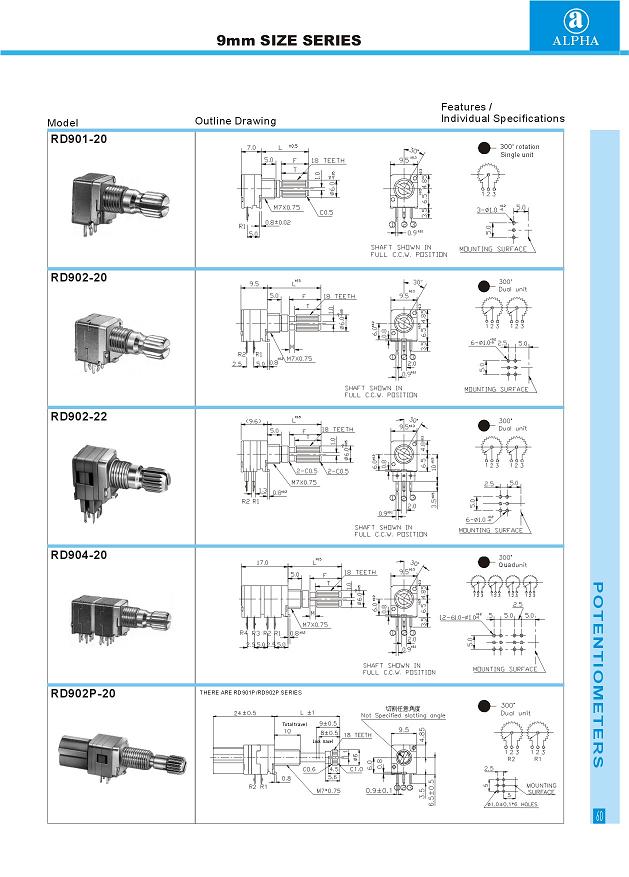

Mouser has a 9mm Taiwan Alpha series that look like these pots but they don't have manufacturer part numbers. Anyone tried calling?
From what I can see, the 9mm Alpha pots stocked by Mouser are all singles. They do have ganged 12mm units in both linear and audio taper, so you can try the quasi audio taper shunt resistor hack if you don't trust the tracking of the ganged audio taper pots. I have no idea if their ganged 12mm and larger pots sound as good as the 9mm ones, but they're pretty cheap, so it won't cost you a lot to find out either way...
