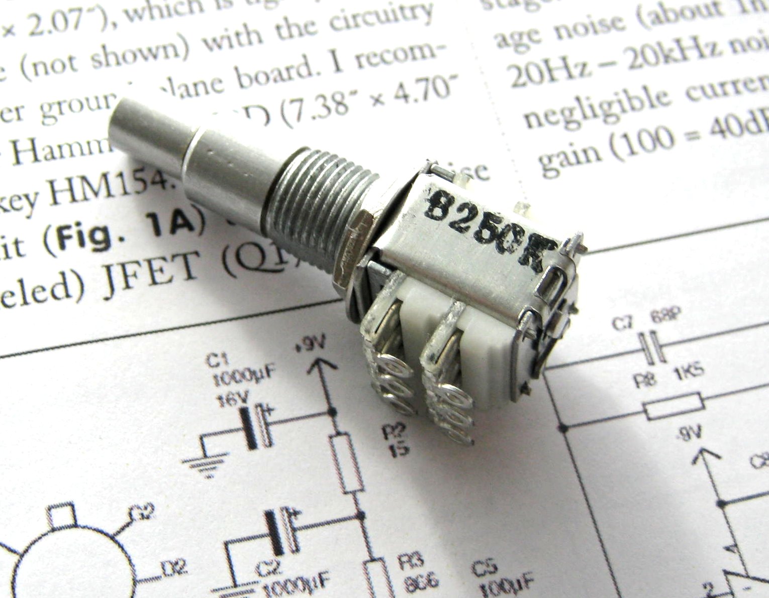

I'll be trying this guy out - whether it's Alpha or a knockoff I have no idea. It doesn't really matter anyway, as long as it sounds good - the basic point of this thread after all. The pot shown is 250k, linear taper with coencentric shafts. I'm waiting for some nice black knurled knobs to top it off - guitar parts sellers on Fleabay have them, which is also where I found the pots. The pot will be law-faked with a pair of good quality 41.2k resistors. I'll check back in after I've done some listening.

Possible to try both and compare - but clearly with the purpose of keeping the straight shaft version? Let us know if they sound different to you?

The box where that particular pot is destined uses a single coencentric volume control. Right now it sports a 10k coencentric shaft Vishay/Sfernice pot. I wanted to try something with higher impedance to make life easier for my signal sources. If/ when I try the Jaycar pots, they'd be going up against some Noble "black brick" 50k CP pots in my other test box. In that box I have 2 separate controls for volume/balance, so the Jaycar/Alpha pots would work there.
