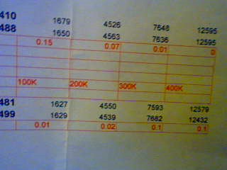

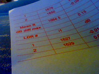

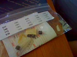

Just found these in my mailbox
Very nicely done, with careful documentation
Thanks🙂

1 and 2 have no significance.
Consider this: your normal listening level is probably between 10% and 60% rotation on the pot.
So anyway the series resistor would then be used most at about 450k-200k.
The series would be used from 50k to 300k.
Make sure that the LDRs you use for series have their best measurements on 200, 300, 400k.
Make sure your shunt resistors have their best measurements from 100, 200, 300k.
So if you have awesome 100, 200, 300k and then all of a sudden something like -.52dB on 400k then this is definitely a great option for shunt and the opposite for series.
Uriah
