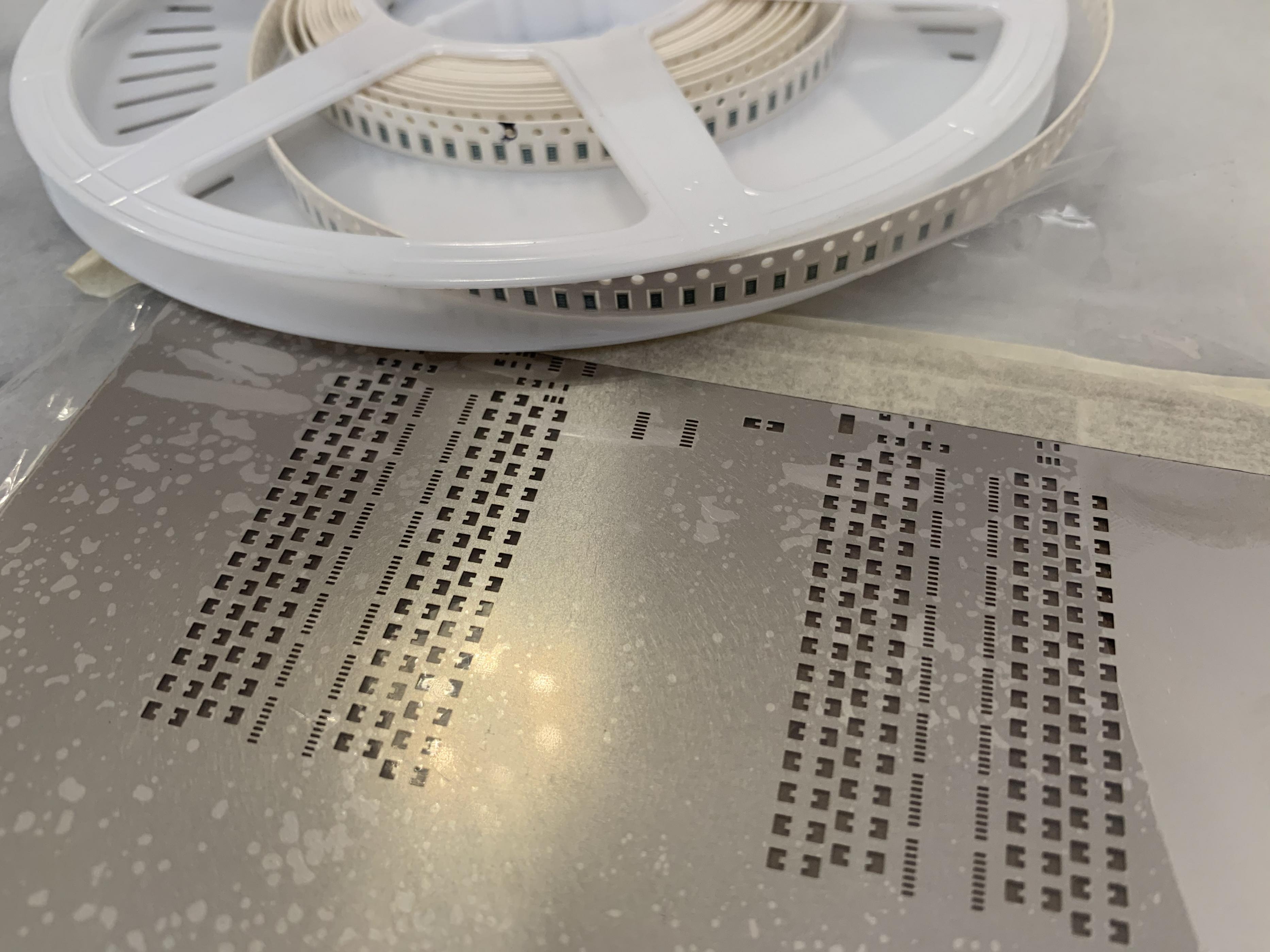

what resistors are they ? some NOS stuff or are things that we can actually buy off-the-shelf ? seems like something from the VSOR vishay line...

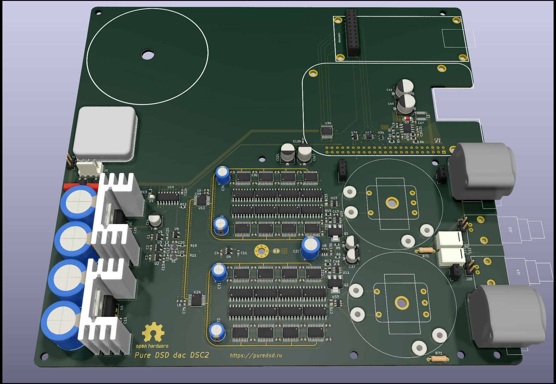

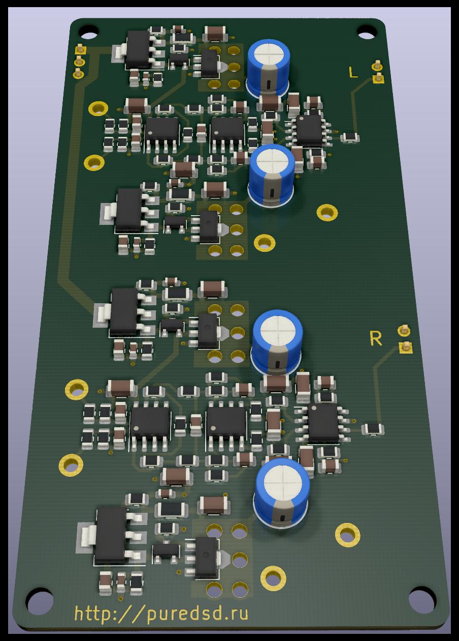

This is the latest release. It is likely that I will no longer develop this project. Only support.
The layout showed good sound quality. Registers 74LVC8T595 with separate output stage power. The power regulator is made according to the classical scheme "precision voltage references + OP + npn". Noise and dynamic performance is better than the LT3042. As resistors, Vishay NOMCT16035001AT1 is used. The active output stage uses shunt voltage regulators. Automatic switching of USB <-> Ethernet inputs.
Full documentation and gerbers will not be published until after successful verification of the first PCB. Unfortunately, COVID has violated the deadlines. Since the full documentation will be available, anyone can independently organize a group buy.
