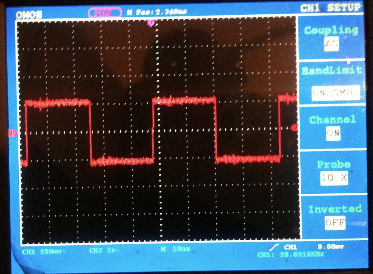

I found some (not so good) pic from the scope of 20KHz, square. TDA1540 was in NOS mode without digital filter just for the test. Without interstage transformer, just simple output test circuit, Riv + JFET gain stage + JFET buffer... (I didnt believe it at the first look, also findout that it get out with 384KHz SR in NOS mode, but latter note in datasheet 12Mbit datarate. Also note extremly fast changing SRates, without almost any transition or clicks. Much faster than other DACs with SAME USB/I2S interface, and same computer before)

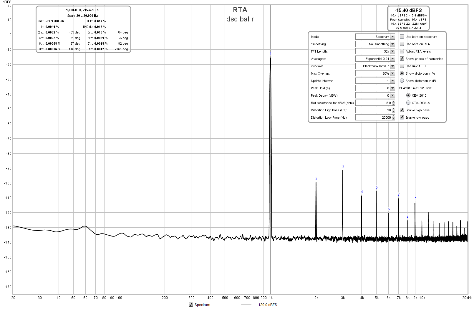

I took some time to make measurements of my DSC2 build (shown at https://www.diyaudio.com/forums/digital-line-level/254935-signalyst-dsc1-141.html#post5830294) before starting case construction. My results do not seem to be in-line with the measurements others are seeing. I'm wondering where I may have gone wrong and if there are any suggestions to get my THD measurements up to par with what other are seeing (https://www.diyaudio.com/forums/digital-line-level/254935-signalyst-dsc1-151.html#post5890188, etc).
While the measurements others have posted are around 0.007% THD, I am consistently seeing 0.013% in one channel, 0.017% on the other. I have attached my RTA spectrums.
Tests were run using a 1khz sine 384k/24bit wav file generated with SoX, -3db attenuation. This is upsampled to DSD512 or 256 in Roon (no meaningful differences in THD between the rates). Balanced output sends about 1.22V output to my Linear Audio Autoranger (which leaves attenuation to 0db) and then to my ESI Juli@'s balanced inputs.
Any thoughts on the cause of this? I have tried a few things to rule out some thoughts.
- Changed from a switch mode PSU with a cap-mx + regulator to a linear PSU + cap-mx + regulator. No changes in THD.
- Tried both SE and Balanced outputs, no change
- Tried HQPlayer instead of Roon for upsampling, no change
- Added 10k across the secondary of the output transformer (Lundahl LL1684), no change
Some suspicions I have:
- I ordered some 74AHCT595Ds from Taobao in an attempted to get old stock. It seems like they were based on NXP marking, but I wonder now if they are legit parts.
- It was stated by Vit123 that the Lundahls add significant distortion, but even for these transformers, is it expected to be this high?
- Any grounding issues? Right now its pretty isolated from anything, but I suspect this wouldn't be that big of an issue with balanced output. I also would assume any grounding issue wouldn't be spread across the harmonics as I'm seeing.
- Soldering or construction errors? Anywhere to start to check this? I read the previous posts about DC across the transformer primary. I measured and there is no substantial or constant DC voltage while playing music.
- Should I add additional snubbing or load to my output with the LL1684s?
- Perhaps my test setup is flawed.
Or... maybe these measurements are as expected with my build?
Any suggestions on where I can go next to try to lower the THD? Any other tests I should be running? Any other information that would be helpful?
Thanks all for your thoughts and expertise!
Greg

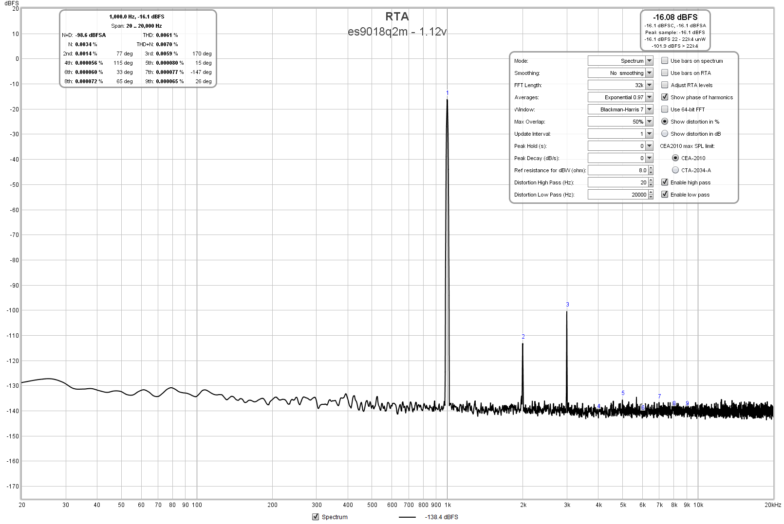

I measured a small Roon / raspberry pi-based streamer using an ES9018Q2M with the same test file and setup. It measured 0.0061% THD as shown in the attached file. Therefore, I know at least my test setup can measure lower than what I'm seeing with the DSC2.
Greg

@gtose ... Hi ... Just a couple of brief comments on your measurements:
- A suggestion could be to disconnect the Lundahl and measure the DSC directly without transformers.
- Also, I notice that you describe a measurement setup that includes the Linear Audio Autoranger. Personally I would try measuring without this part in the signal chain.
- Given there's virtually no noise below 1 kHz I would not assume that you have ground loop issues ...
- Might the input impedance of any of the devices you connect after the DSC have low impedances so as to load the DSC?
Well, these were my first thoughts ... hope it may help ...
Jesper

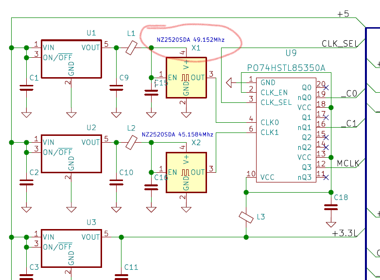

Hello;
Regarding to version DSC2 with reclocking what i do not understand is dsd is always times of 44.1Khz
DSD 64 : DSD 2.8 MHz = 2 822 400 Hz = 44100 Hz x 64 times;
DSD 128 : DSD 5.6 MHz = 5 644 800 Hz = 44100 Hz x 128 times;
DSD 256 : DSD 11.2 MHz = 11 289 600 Hz = 44100 Hz x 256 times;
DSD 512 : DSD 22.6 MHz = 22 579 200 Hz = 44100 Hz x 512 times;
DSD 1024 : DSD 45.2 MHz = 45 158 400 Hz = 44100 Hz x 1024 times;
So why recloking circuit includes 49.152Mhz?
