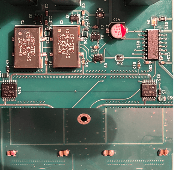

Made some modification to DSC3,
Swapped C20/23/59/75 with Rubycon 0.22u 232-16MU224MZ22012
Paralled Rubycon 2.2uf 16MU225MB23225 at the back of C70/71/72/73
Very positive, less harsh and more organic sound.

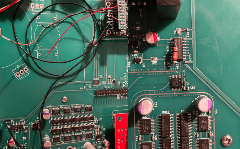

I solved the noise problem by giving the master clock some extra delay. The U7 74LVC157 Mux had a spare 3rd channel with inputs connected to ground. I removed the connection to ground and connected the master clock coming from the DAC to it. Master clock signal is taken from Jumper 1. The output of the Mux channel is routed back to Jumper 1. Normally the used Jumper 1 pads were connected directly. Now through the mux.

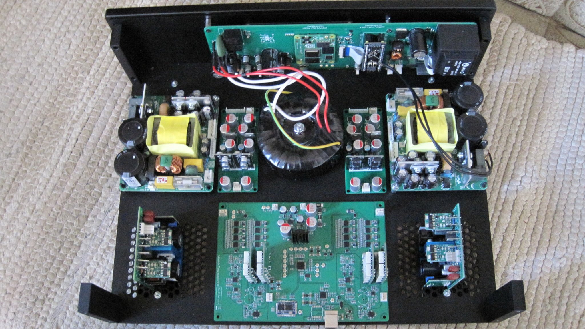

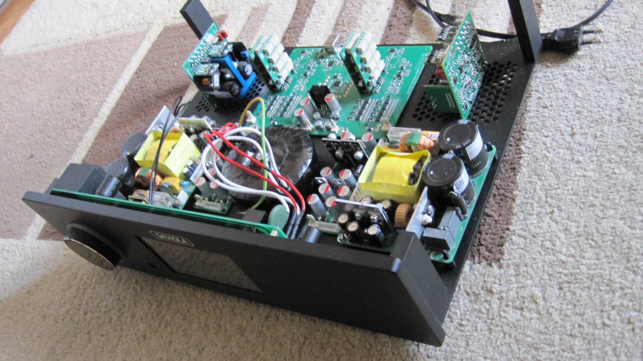

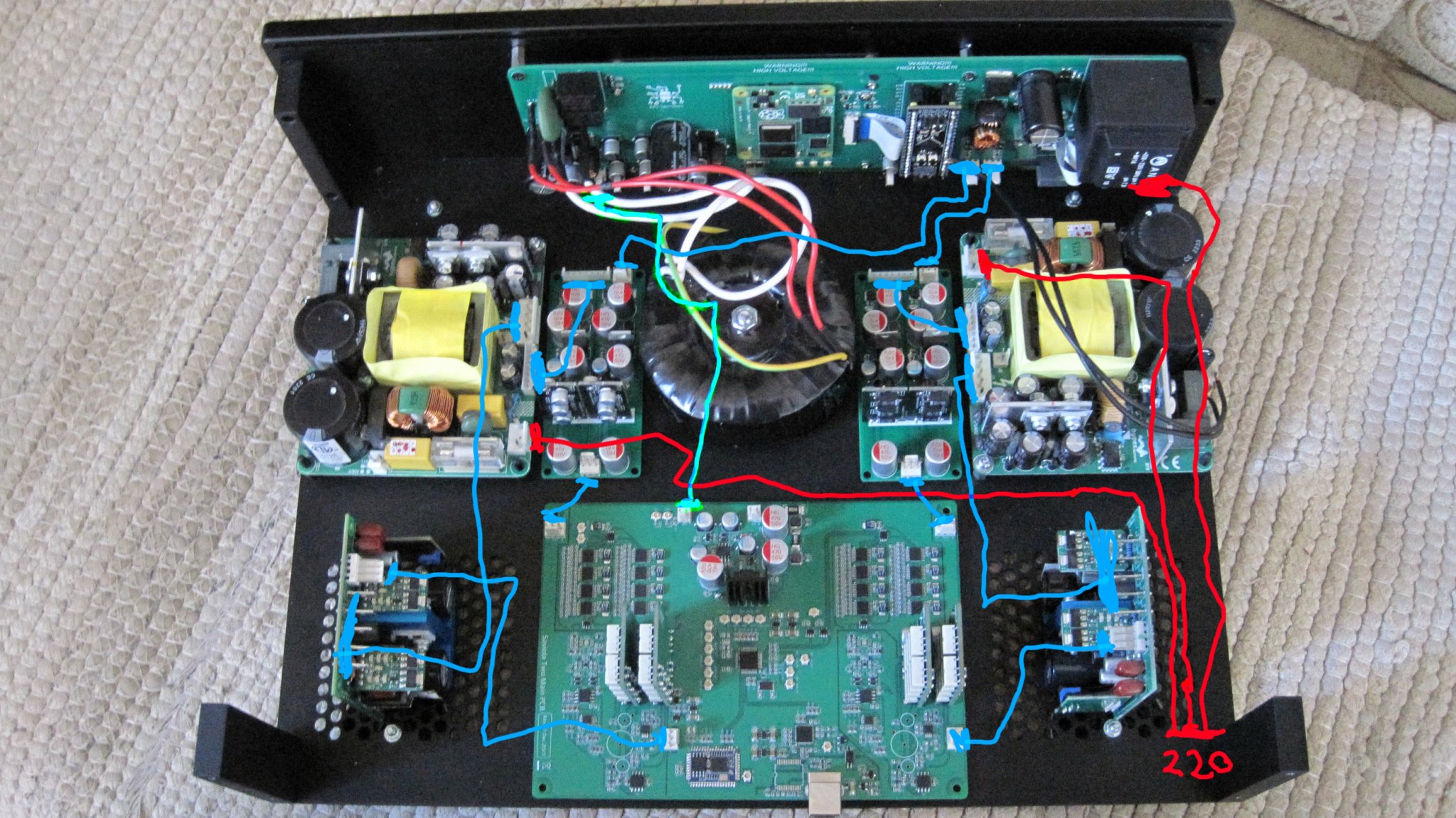

Almost finished Saviola 2 device, based on DSC2, this is all the parts inside enclosure, ned some work on mounting the things, there will be sheet iron baffles to isolate the noise from the smps and torus transformer. The only thing which I didn't designed but will design it soon is back pbc with usb hub,for cm4 module and optical inputs and i2s inputs outputs for ct7302 Lauout for interconnection is an very good and very short, : )

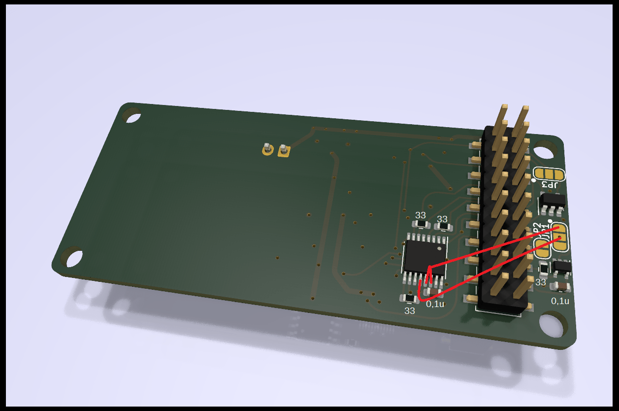

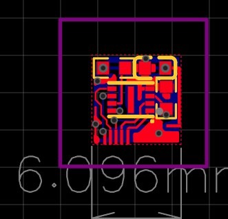

To bad, ct7601 can't work without spi flash, so I ordered small pcb on which I included spi flash, board pcb will be put on top of the ct7601 to make them spi flash available, it will be a bit of challenge to put jumper wires but now it is so short pin to pin and my hope I will do that without any problem : )

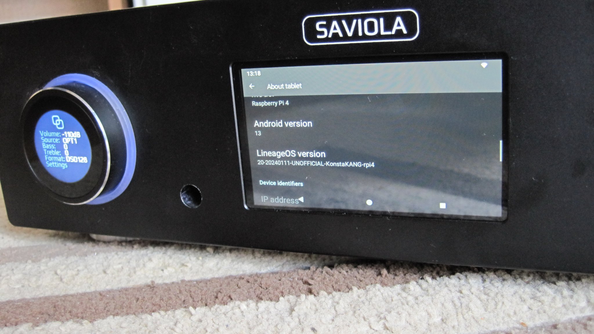

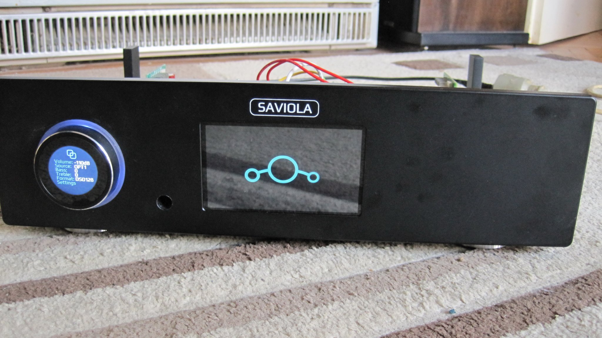

In relation to post I decited to abandon clasic power button and command structure on touch screen and decided to add Smart Knob which will be the main control thing so that CM4 is now free for anything else for example for an media server or android or whatever I like, no need to care about gui implementation and things : )
Smart Knob will get also an diy rgb ilumination so that whole things look even better : )
I want such button too

I will make that after I finish above device! It will be dsc2 based, isolated push pull predregulator, LT3042 post regulators, and all connectors for digital in will be u_fl . Things will not contain post dac things, so for those who will need i/v or whatever after dac will need to design it. : ) In my opinion the best supply for this type dac is simetric topology, in our case isolated pre regulator and it can be done propertly only with something which is pure simetric like push pull topology or similar. My choice is push pull topology for this-next project. And I will share it in this thread!
